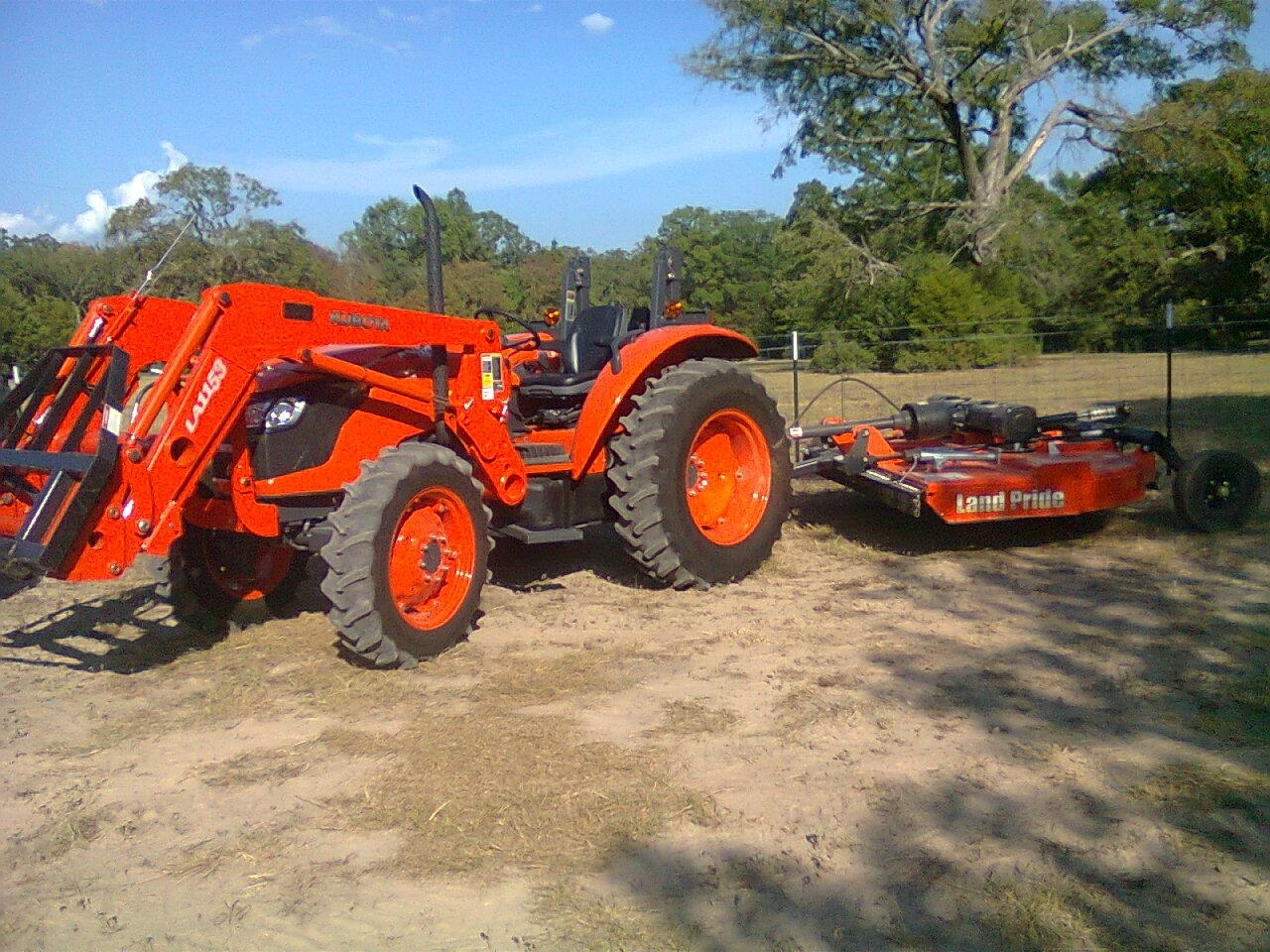

I don't see a need to go larger than the 5040 unless you want to pull implements larger than 6ft. The 5040 should pull a 6ft rotary cutter in all but the thickest brush with no problem.
Agreed, I use a Land Pride RCR2672 with my L5030 in very heavy brush. The open area was cut out of the surrounding brush up to 3+".

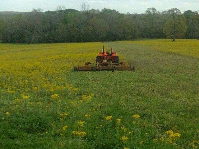

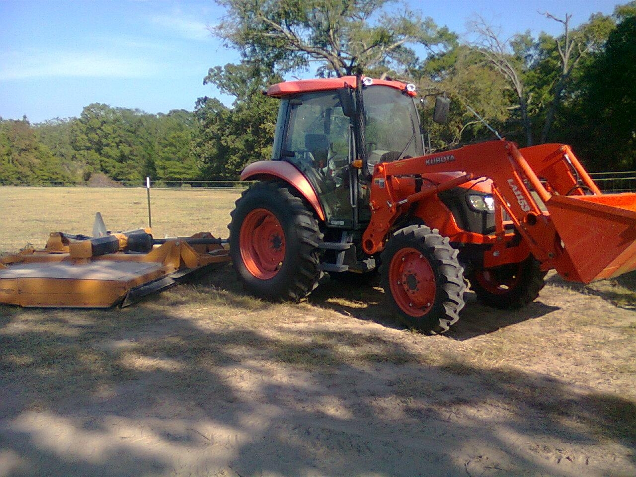

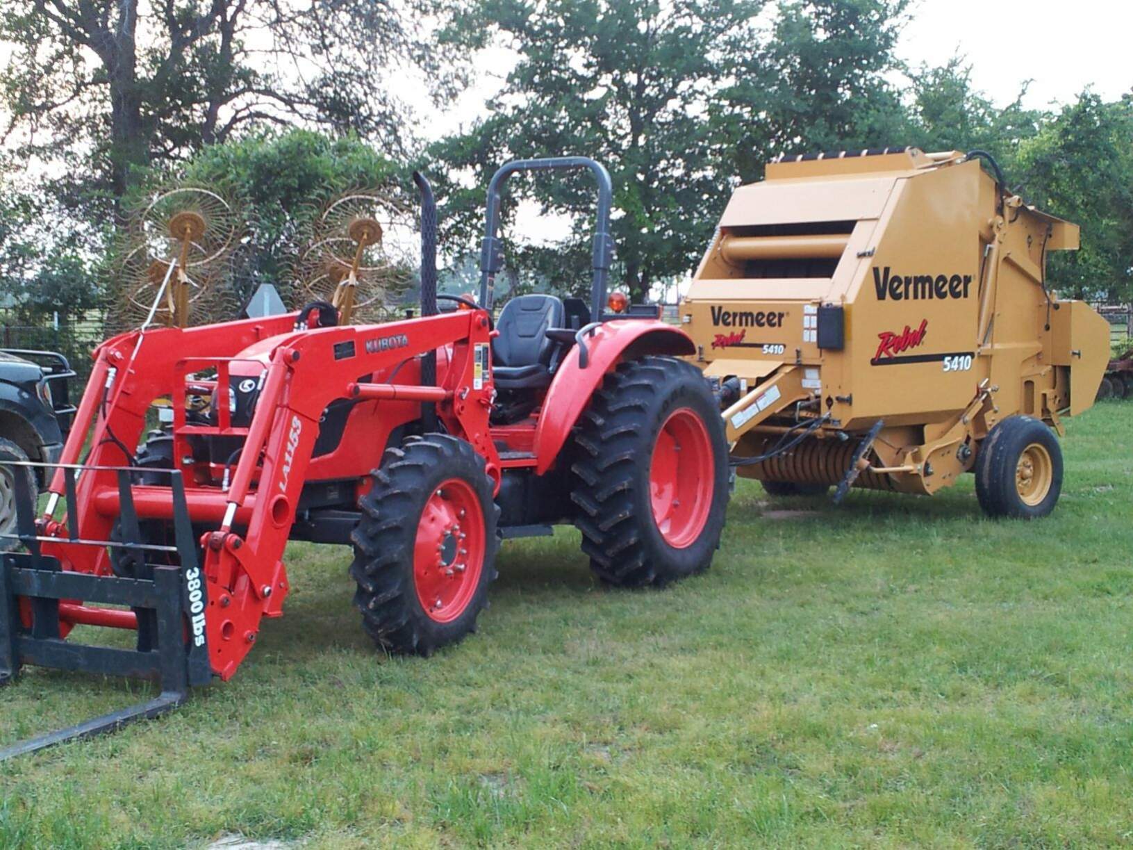

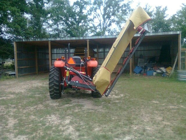

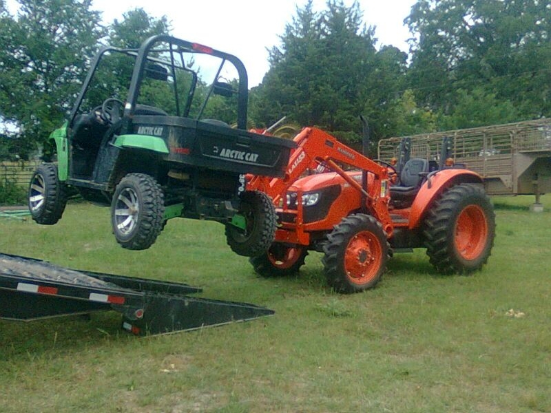

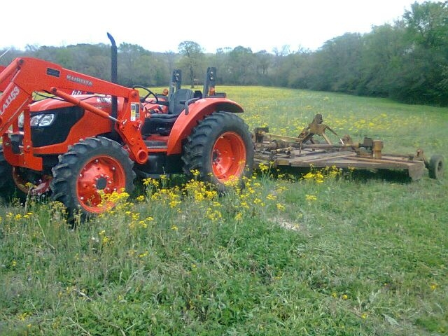

I believe the difference would be really hard to tell. And I guess I will let the picture do the talking for the 5040.I will add my 7040 picks up like 400lbs more than my 5040...
loading prowler.JPGcutter up all the way.JPGmowing.JPGtractor1 (ADQ v1).jpg5040 and rebel.jpg5040&tiller.jpgrear view of mowing with batwing.JPGtractor3.JPG
Heavy grass/weeds-8ft pull-type shredder
Medium/light stuff-15ft batwing
Hay cutter-8ft
74IN.Tiller
6ft medium duty boxblade
And will be using 5x4 baler this year

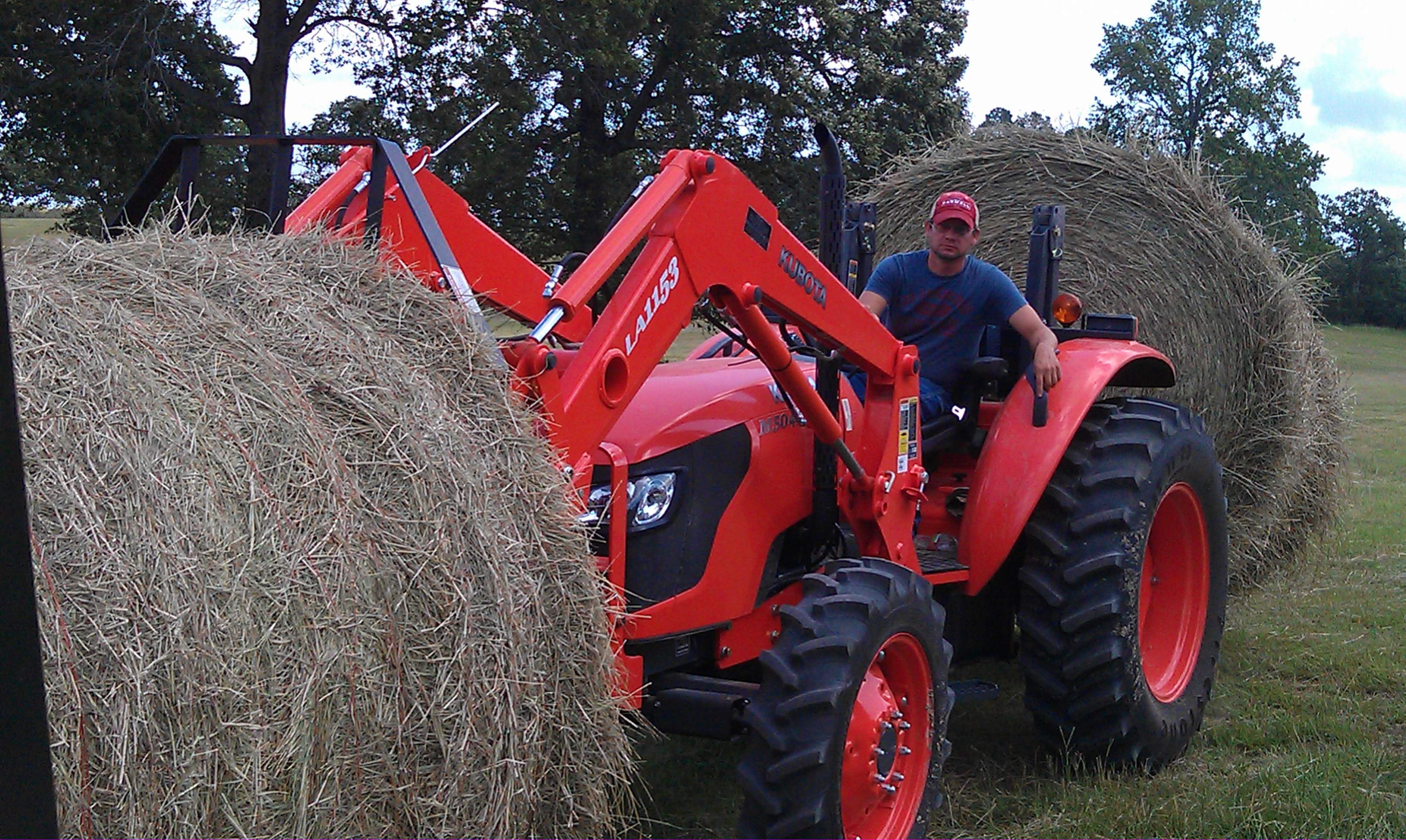

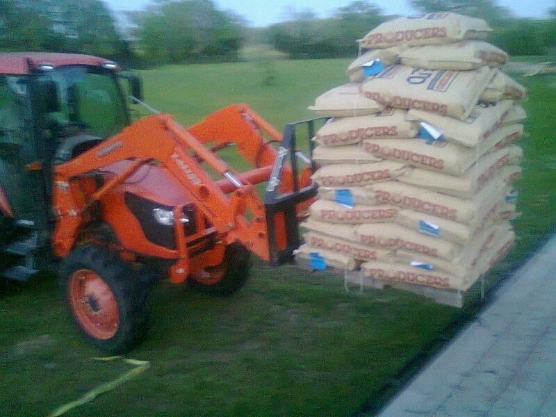

The 5040 will un-load a ton of feed but thats it,the 7040 can do alittle more7040 unloading feed.JPGtractor4.JPG

foreman Etexas, I have one more question if I can ask, or anyone offer their opinion. Is there any significant difference in fuel usage between the M5040 and the M6040 or M7040? Also if someone describes their machine as having a synchro shuttle with no other description would you consider that to be a mechanical or hydro shuttle?
   / M5040 or M6040? #19
My 7040 uses way more than the 5040 but it is cab/air:DI would think the fuel would be very little more between the 3. Both of mine are sync.shuttle(gotta use the clutch)(mechanical). If your doing alot of loader work,I would go with the hyd.shuttle and mechanics claim longer life on them than sync.also. I guess I never heard you say or missed it,openstation or cab? How much do you plan on lifting?
If you dont mind me asking whats the price difference between the 5040 and 6040.
I paid $26,900 for the 5040 brand new(4x4,sync.shuttle,1153ldr)
