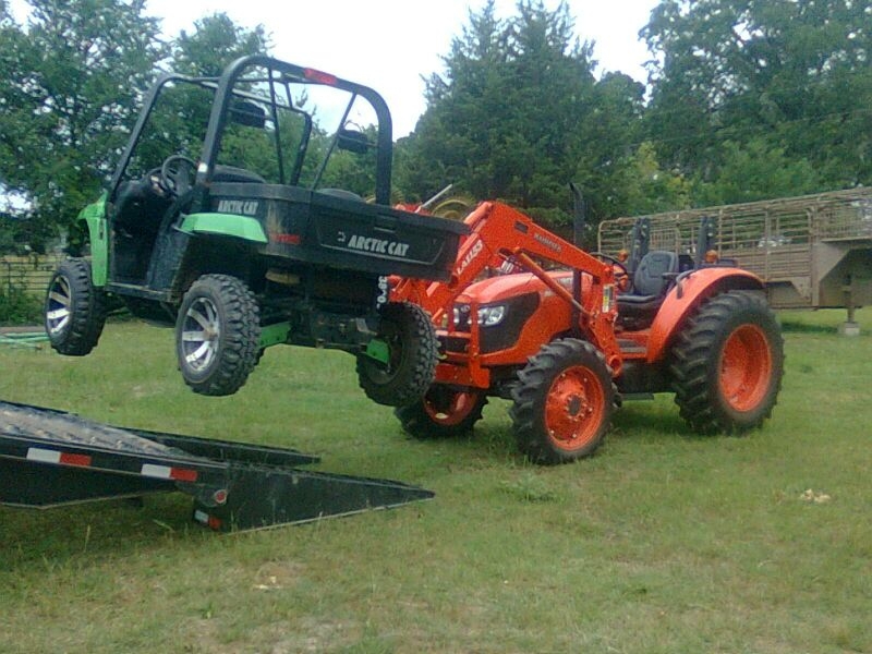

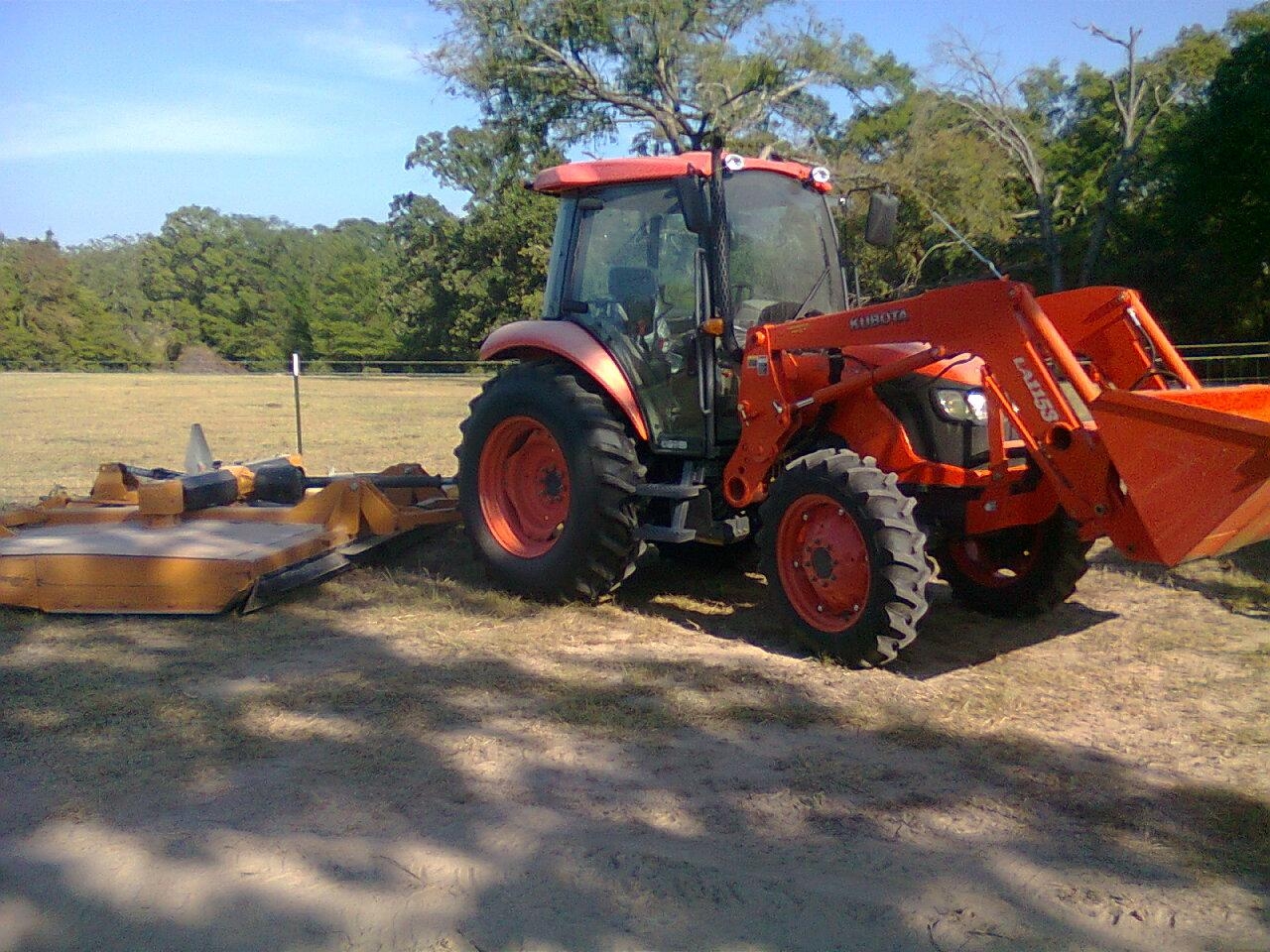

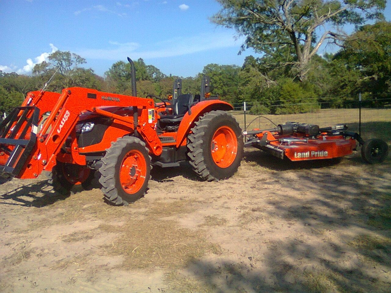

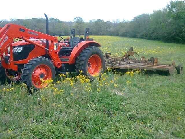

I believe the difference would be really hard to tell. And I guess I will let the picture do the talking for the 5040.I will add my 7040 picks up like 400lbs more than my 5040...
loading prowler.JPGcutter up all the way.JPGmowing.JPGtractor1 (ADQ v1).jpg5040 and rebel.jpg5040&tiller.jpgrear view of mowing with batwing.JPGtractor3.JPG
Heavy grass/weeds-8ft pull-type shredder
Medium/light stuff-15ft batwing
Hay cutter-8ft
74IN.Tiller
6ft medium duty boxblade
And will be using 5x4 baler this year

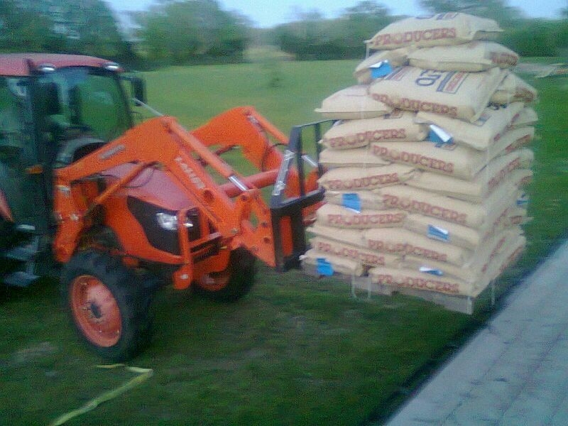

The 5040 will un-load a ton of feed but thats it,the 7040 can do alittle more7040 unloading feed.JPGtractor4.JPG
