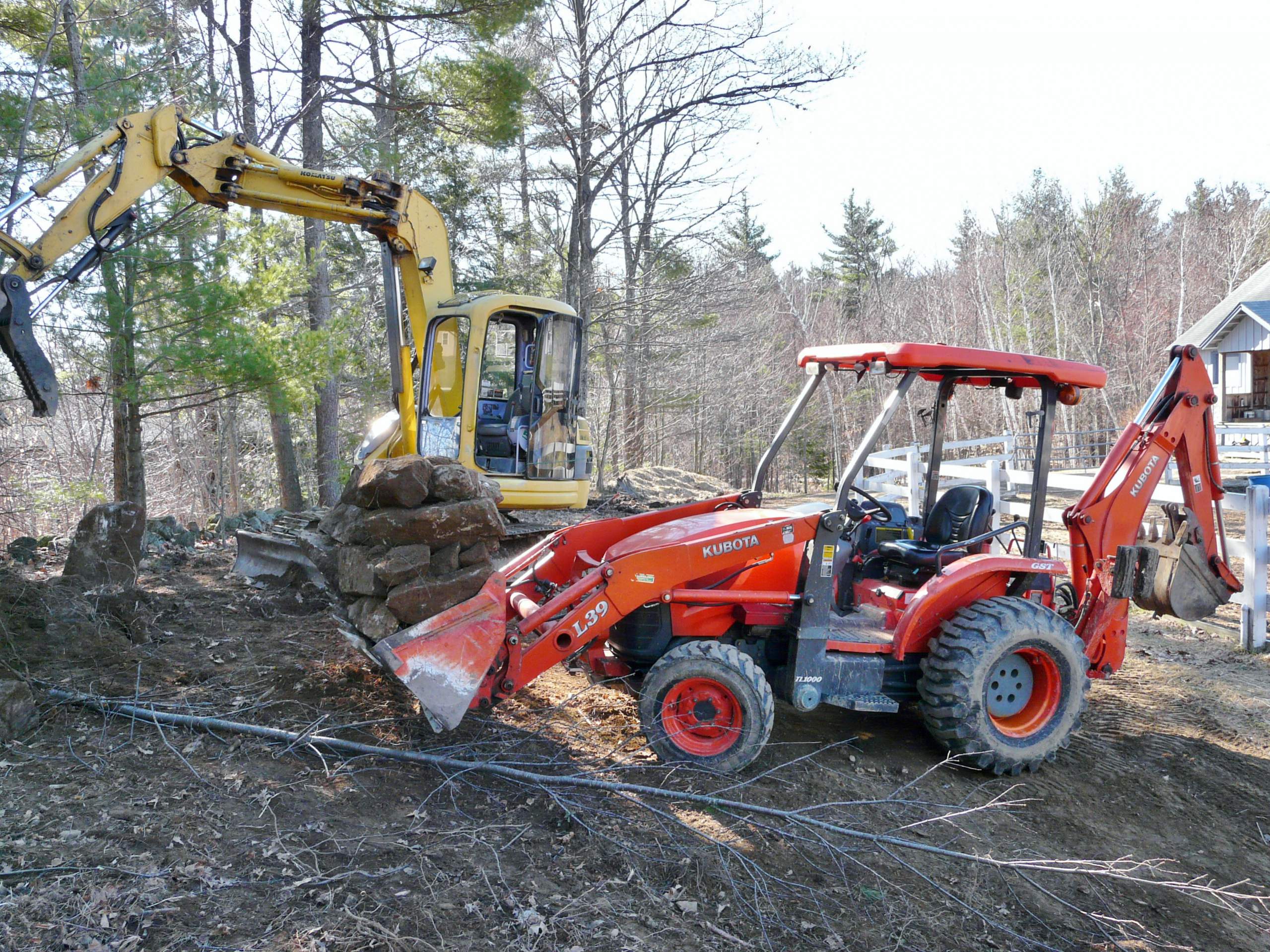

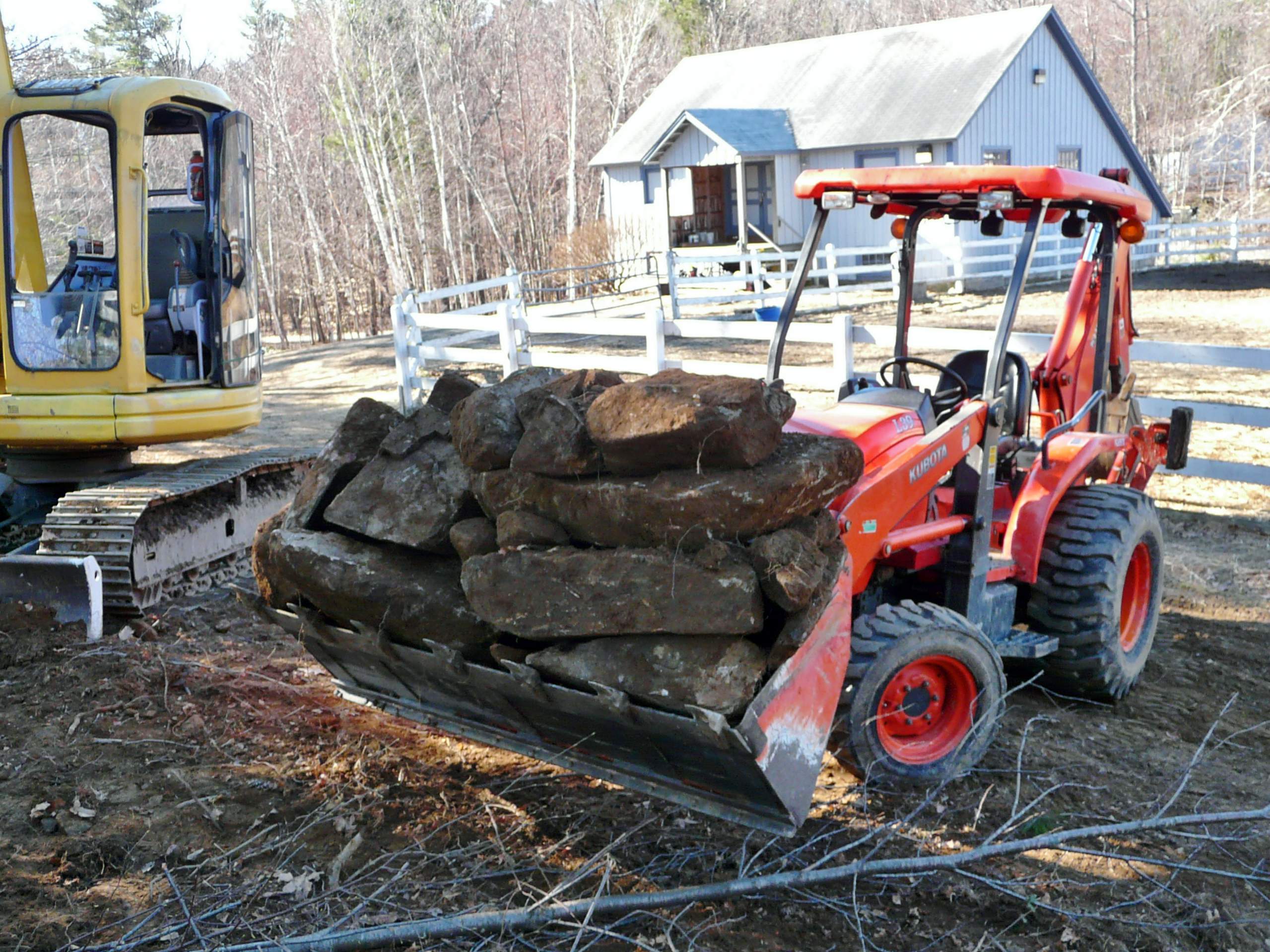

My L39 seems just about right at just over 4 tons weighted. The 37 net HP engine does have a lot to lug.
The M59 at just under 5 tons should be nice and stable. I move my L39 around with the hoe to position. The hoe is a lot tighter than the loader with 1,800 plus hours on the machine, no issues.
The m59 with lots of power should not notice the weight.

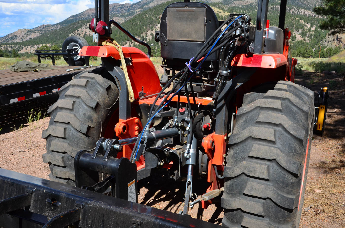

I use the M59 both with and without the hoe. With nothing on the back the rear wheels will slip just driving around if in 2wd. Mounting a heavy box blade on the back (see attached pic) it is again very stable however. For any 3pt earthwork such as pulling a grading scraper it would be much better to weight the tires or wheels, however I have never done so as one can get by ok for small jobs by just engaging the front axle and maybe adding some more weight to the front. I doubt if weighting the wheels would be a problem when using the hoe, except perhaps when using the hoe to lift and reposition the tractor. (BTW, those are Fit-Rite cylinders on the back, and I installed the rear auxiliary hydraulics shown with the Kubota add-on kit).

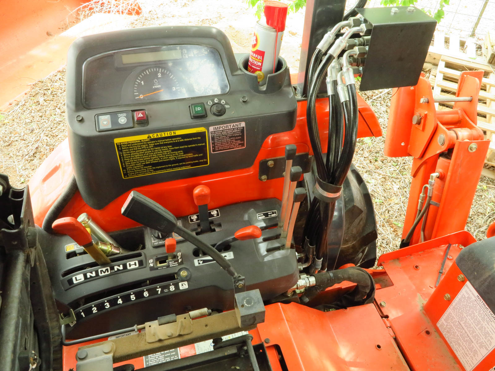

Can you take a photo of your spool layout from the drivers seat?
   / M59 Discussion Thread #356
Sure, here you go. This is with the seat folded forward. The console area is pretty cramped so it would be challenging to get a good install without buying the Kubota kit. I had to cut out the slots in the console a bit at the back to make room for the spool levers. The spools have a detent/hold position on one side.
