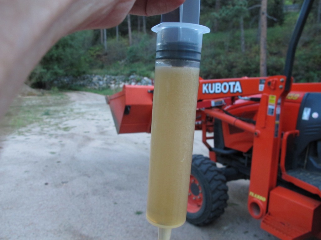

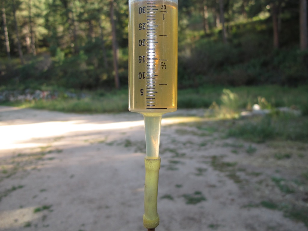

OK, I pulled some samples from my own tractor yesterday. Temperature here is in the 70s, trans/hydraulic oil is New Holland Multi-G 134 with 100 hrs on it which included all new filters. Only hydraulic problem we have is a bit of whine from the high pressure pump (on engine right side) when the motor is cold.....which either goes away or gets so quiet I can no longer hear it as the machine warms up. This M59 rarely gets asked to do much hard work and definitely not quickly. It's babied.
I took a picture before starting the tractor and the oil is clear. Any haziness is simply whatever was last in that syringe.... The second sample is about ten minutes later after using the backhoe to lift and load a table saw into my buddy Craig's pickup. Altogether the M59 ran at idle for about ten minutes, moved the backhoe booms twice rather slowly, and drove about 50 feet in low gear.
We were flabbergasted at the amount of bubbles of entrained gas (air? oil vapor?) in the oil. Craig and I both know a bit about the physics of air and vapor entrainment in fluids....it would be interesting to know which type this is. Whichever it is, we were sure surprised to see it there. To make sure, I drew another sample and it was identical. The sample in the photo has been in the syringe less than a minute and looks to be already clearing - which is good? The next day the oil in the syringe had cleared up entirely. I don't know if that took minutes or hours.
The immediate question is whether this bubble entrainment is a also typical of other tractor hydraulic systems?? And would it clear up if the tractor ran longer?

I am surprised by the amount of entrained air as well. This is not
foaming, it is entrained air (or other gas), i.e. small ~1mm bubbles of
air mixed in the oil. It looks excessive from the pictures, however I
do not know what is normal either. I will run another test myself when
I get a chance, but it probably won't be for a few weeks when I have the
tractor back to the garage.
Some amount of air entrainment in a warmed up system is probably normal.
Hydraulic oil at ambient temperature in an open system like we have will
contain 10-12% dissolved air by volume - this is when the oil is clear.
If we then heat the oil and pressurize it to 3K PSI in the lines then
depressurize when it returns to the reservoir, air bubbles can form as
the solubility of the oil is reduced. Air can also come out of solution
at the inlet due to decreased pressure in the suction, especially when
the system is cold, or if there is any clogging or other restrictions.
So a certain amount of entrained air in a warmed system is probably
normal. Excessive air entrainment likely indicates either an air leak
in the suction area, improper oil level at the air intake, or agitation
such as a splashing return which forcibly mixes air (this seems unlikely
in a properly designed system).

I share the same concerns about the high RPM that TbarD mentioned. I cannot tell from reading whether Kubota is saying that one should run at max RPM....or merely that one can. I agree that they do say in several places that the machine is capable of working at full RPM. Although they moderate that in the technical publication where the caution about exceeding an oil fluid temperature of 140F. So temperature rather than the RPM may be the limit.
Running at full speed in order to increase heat dissipation is an unusual argument to say the least! I'm betting that one didn't come from their technical staff. Frankly if someone told me that I'd sure take it with a large dose of salt.....better make that a 50lb block with trace minerals....
BTW, I didn't know that fact about hydraulic oil normally containing such a high percentage of dissolved air that TbarD mentioned. If so, then far less than ten percent of dissolved air by volume - coupled with an increase in temperature and varying pressure - is more than enough to create the entrained gas that we see in the samples. And if that is so, it is probably inevitable in any open hydraulic system (some JDs and some industrial equipment use a closed hydraulic system) That means that the entrainment we are seeing is not additional air from splashing, it would simply be an increase in bubble size due to the change in temperature and pressure. In fact, the entrainment would be made to look much worse by the simple act of using a syringe to take a sample....like I did...and that's something I think we all did.
