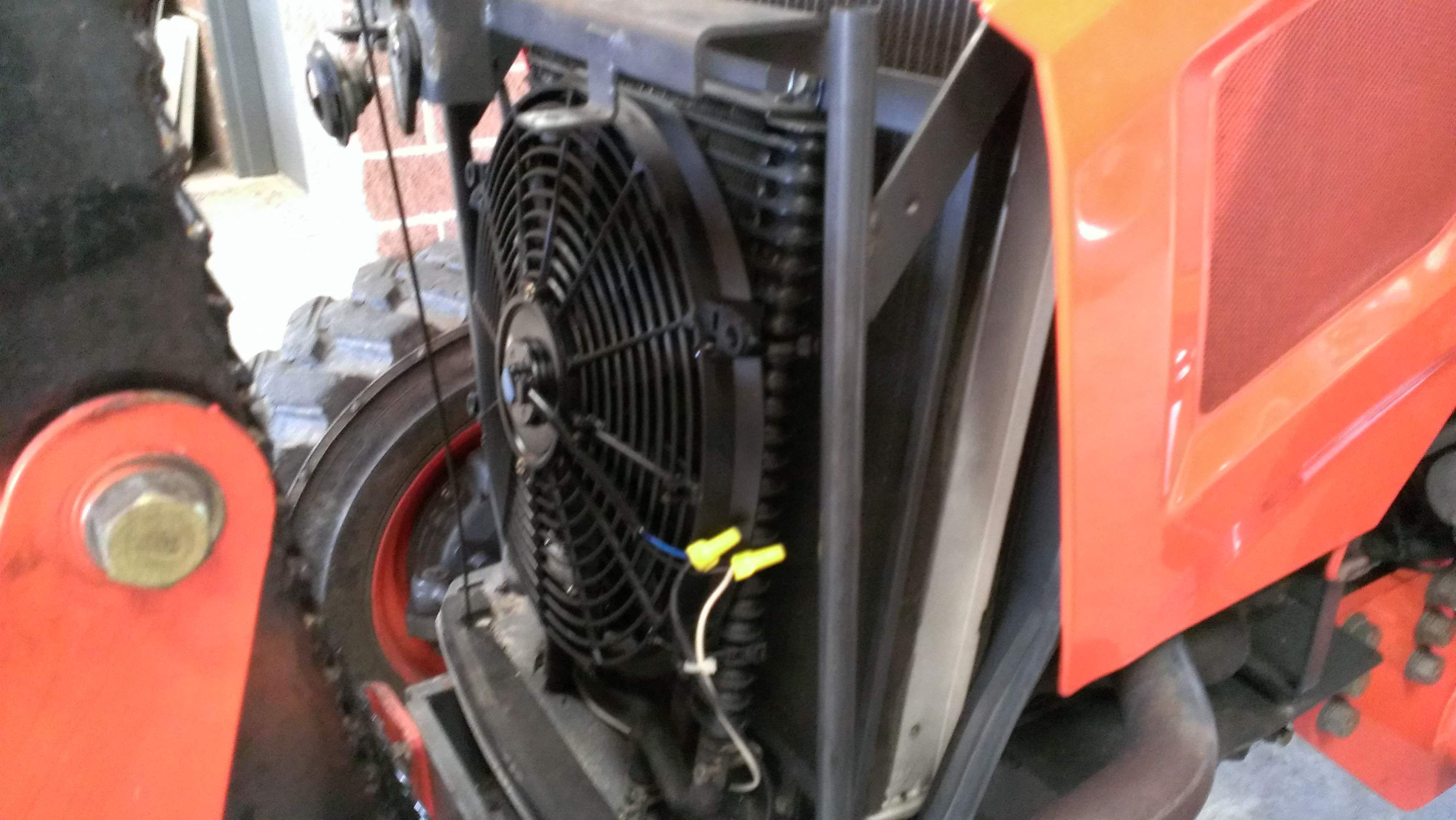

I have thought that the system ran too hot also. While I have not check surface temps with an IR gun I have gave some thought to either looking into a larger Hydro. cooler and/or installing a fan in front of the cooler to supplement the air flow through the Hydro. cooler and radiator.

Tbard, the only reason I watch the temp gauge on the console is this little hunk of steals temps are all relative. A motor mounted hydro pump with the sump(tranny) bolted right to the motor. If one makes excess heat it will migrate.
The rops would be a great place to mount a radiator with a 12v fan set up. I've seen pics of rtv1100 with auxiliary set ups.

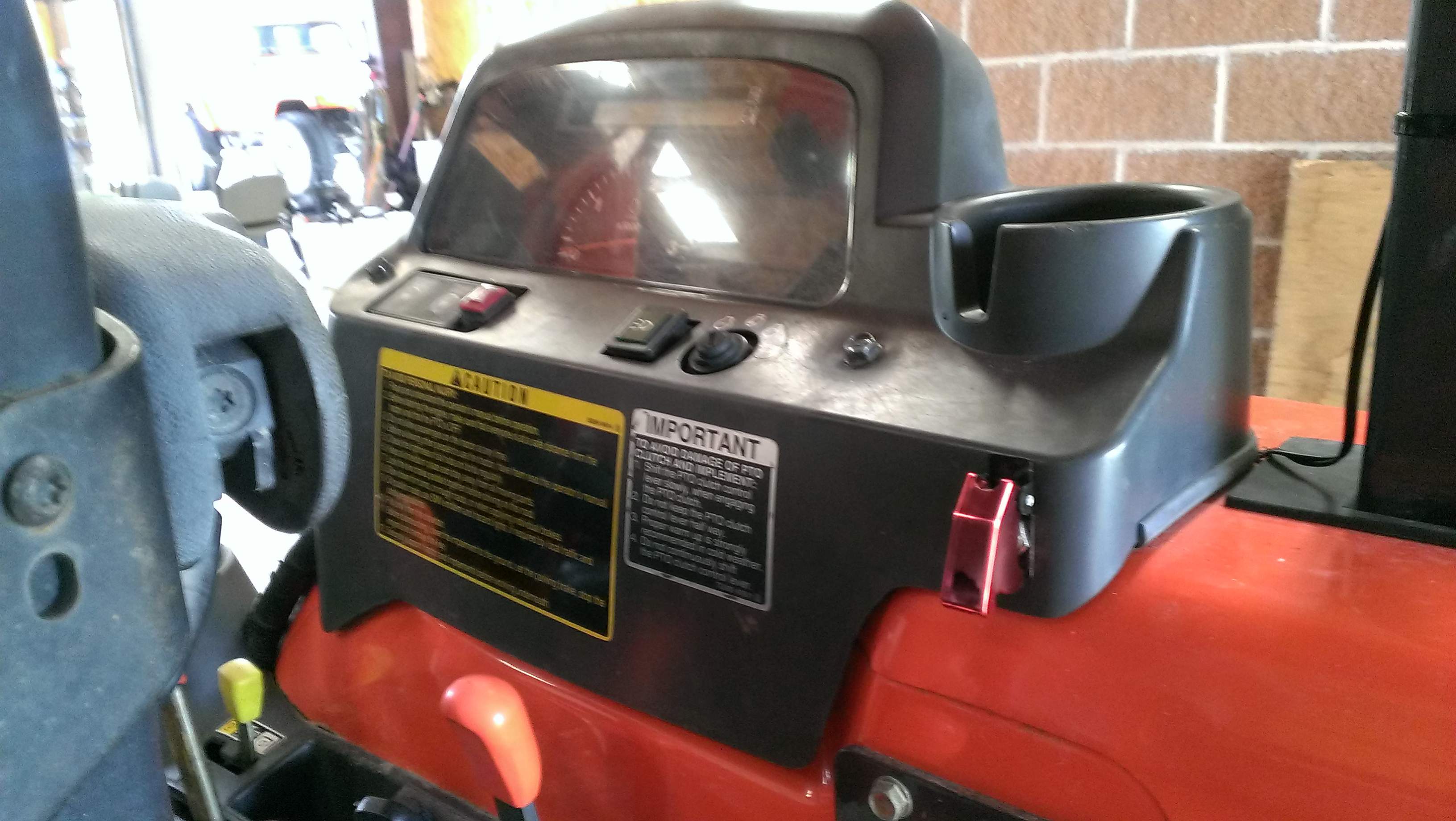

IMAG0204.jpgAfter digging in hard gumbo rmoving some stumps I once again forgot to take my I/R gun to check temps.. I just think its too hot so I Installed an aux. fan and a toggle switchIMAG0201.jpg
