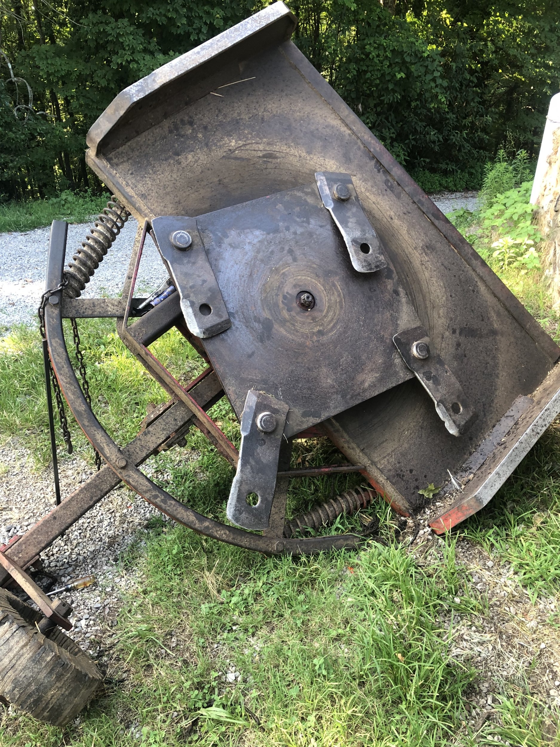

Looking at current Brown Tree Cutters (and associated YouTube videos) they appear to be nothing but bushhogs configured with differing blade carriers and blades. Have to back up to use them mostly. So far we have not heard that you, the OP, intend to be clearing land or cutting trees of any significant thickness more than 2-3 inches. The Brown tree cutter that SmokeyDog shows looks like an older one that is less like a bush hog and more specialized for removing small trees. From what I've heard so far I see no reason you can't do what you want to do with a good "medium duty" bush hog. What Bush Hog brand calls medium duty is tough as hell and will satisfy most needs short of clearing land full time. Both the Brown and a std Hog require backing up to do the cutting unless it is small enough material you can run over it forwards. A 45 to 55 hp PTO utility tractor will run a solid 6 ft hog quite well. No need for high hp PTO.
Once you cut over the area you intend to bush hog regularly, every time you cut it is easier than the last. I know of no need for a 'tree cutter' that you have expressed so far.

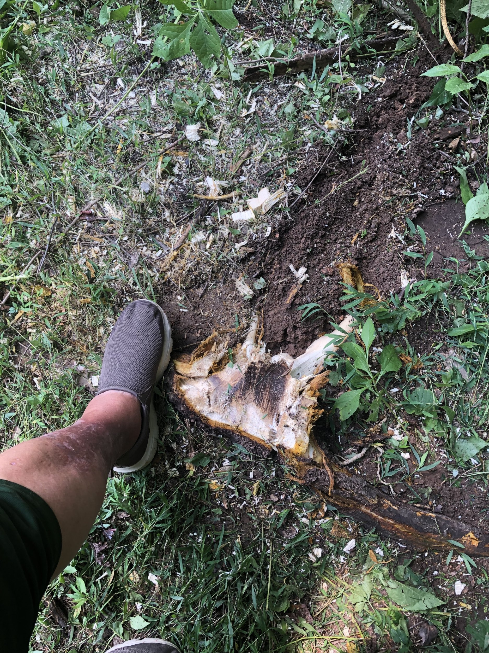

Yes I’m at the low side. Older 5’ cutter spec was 50-80 pto hp in my manual. With cutter, grapple, ballast, modification near 11,000#. Would not want a lighter weight tractor. Like the 5’ in woods clearing underbrush and non native evasives. Considerable flywheel power reserve. HST plus transmission provides excellent slow control. Eats and chips up 2-4” stuff like candy. Rated 6”. I’ve pressed it to do twice that from multiple sides but don’t recommend that. Big stems I pile up. It’s like an angry beaver. Fall cut all my pastures last year with it with good results. Back in to cut encroachment. Can cut right up to big trees I want to keep. Trees grow like weeds here and will quickly reclaim any cleared land.
View attachment 853404View attachment 853405
Do run a 75hp overrunning pto clutch, Pat’s cat2-1 quick hitch and sliding pin stabilizers. It has its own slip clutch. Takes over a minute to spin down.

My farm is a hobby and way of life so I buy used. There are bargains for TLB and cutters. Buying and fixing stuff a hobby too. 5’ cutter was $1,200 and needed some love to become a happy cutter. Apple and oranges difference between a tree cutter and a rotary cutter. Still like my 286 Bushhog but the Brown really shines with stuff 1” or bigger. Brown manufacturing makes HD rotary cutters too.
