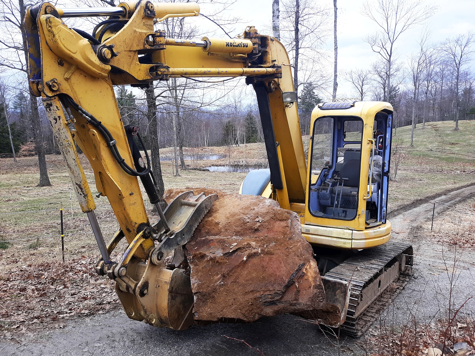

A 10-12 tonne excavator will save your and very much complement your TLB.

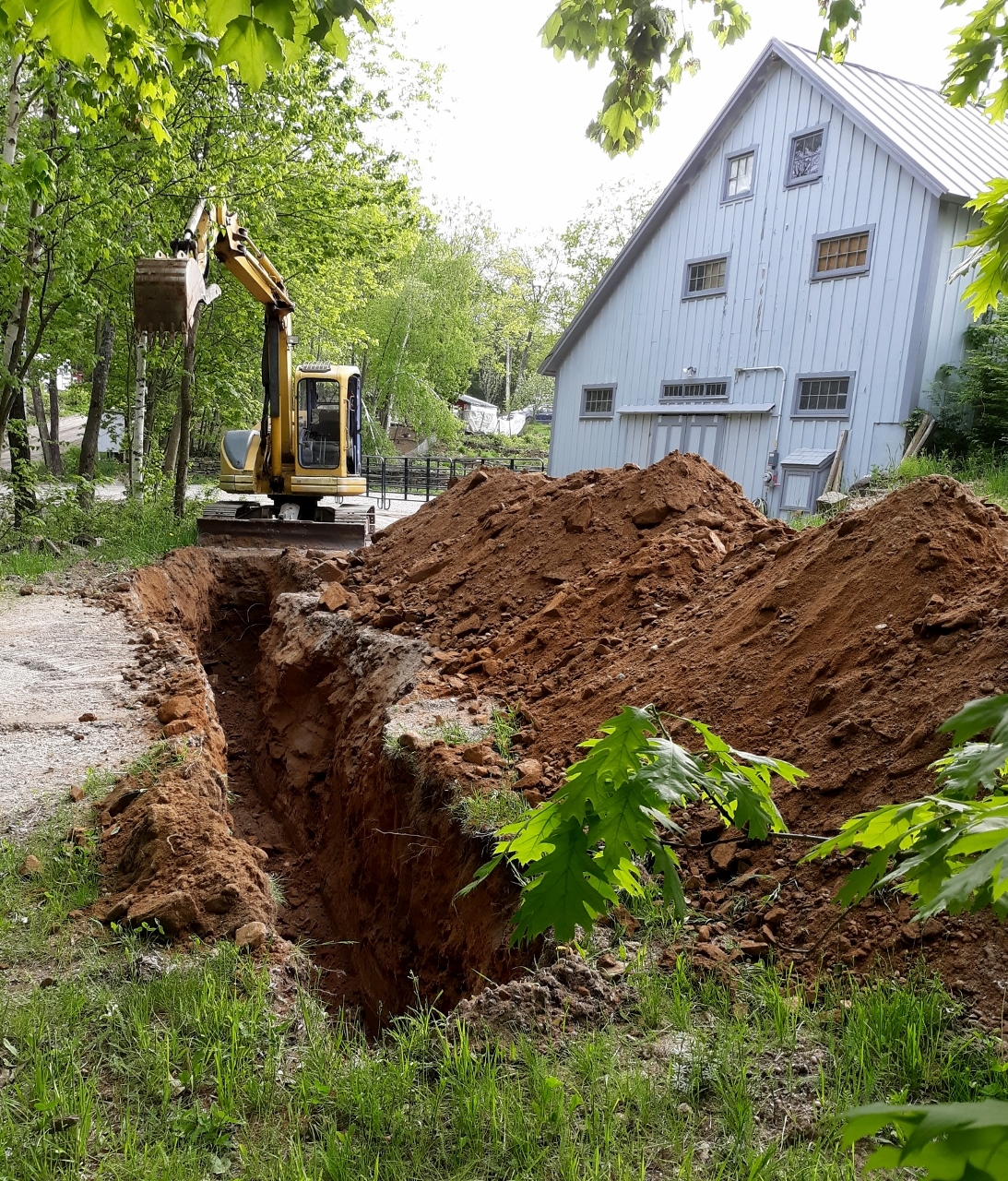

Why get the same type of equipment, just up sized?
