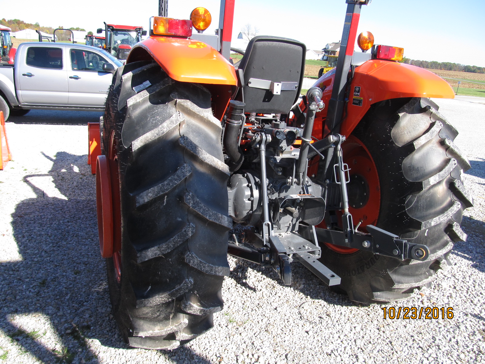

Mine are off now to be painted and not going back for a while
but I can say that one weight takes you just shy of the edge of the wheel while two takes it comfortably past the edge. Probably not beyond the edge of the tire bulge but I can't recall. Look close at the pics I posted earlier and you can sort-of see. Why do you ask since maybe I can answer the question a different way?
   / M7060 - Can additional rear wheel weights be added if the tractor has cast centers? #13
You're in luck and I found this pic of a side shot that shows the weight protruding beyond the wheel. The second weight sticks out a little further than I thought. Take a look.
You won't hit anything with two weights on but will with three unless you live on the plains. What area do you live?

Thanks for the info and the photo! I just was curious as to how much they "stick" out. On a John Deere 2950 I have I seem to hit the extended axle on things I shouldn't :( !

I'll add that my wheels are in the narrow setting so they stick out more. In the wider setting the weights would stick out less because the rim would be reversed. The stub axle on your 2950 is a danger to anyone because they hit obstacles like trees. Do you live on flat farm ground or hilly treed area?

In open country with two weights per side, even in the narrow wheel position is no problem. In the woods, problem, unless you space wide.

It appears in your photo that the lower telescoping 3 pt links containing the balls are installed backwards.
Very good observation. This is before I bought this tractor.
Looks like the new kid in the shop might be better off at McDonalds.
Actually, I didn't realize it myself until I tried to hook something up. Took me minute to understand.
