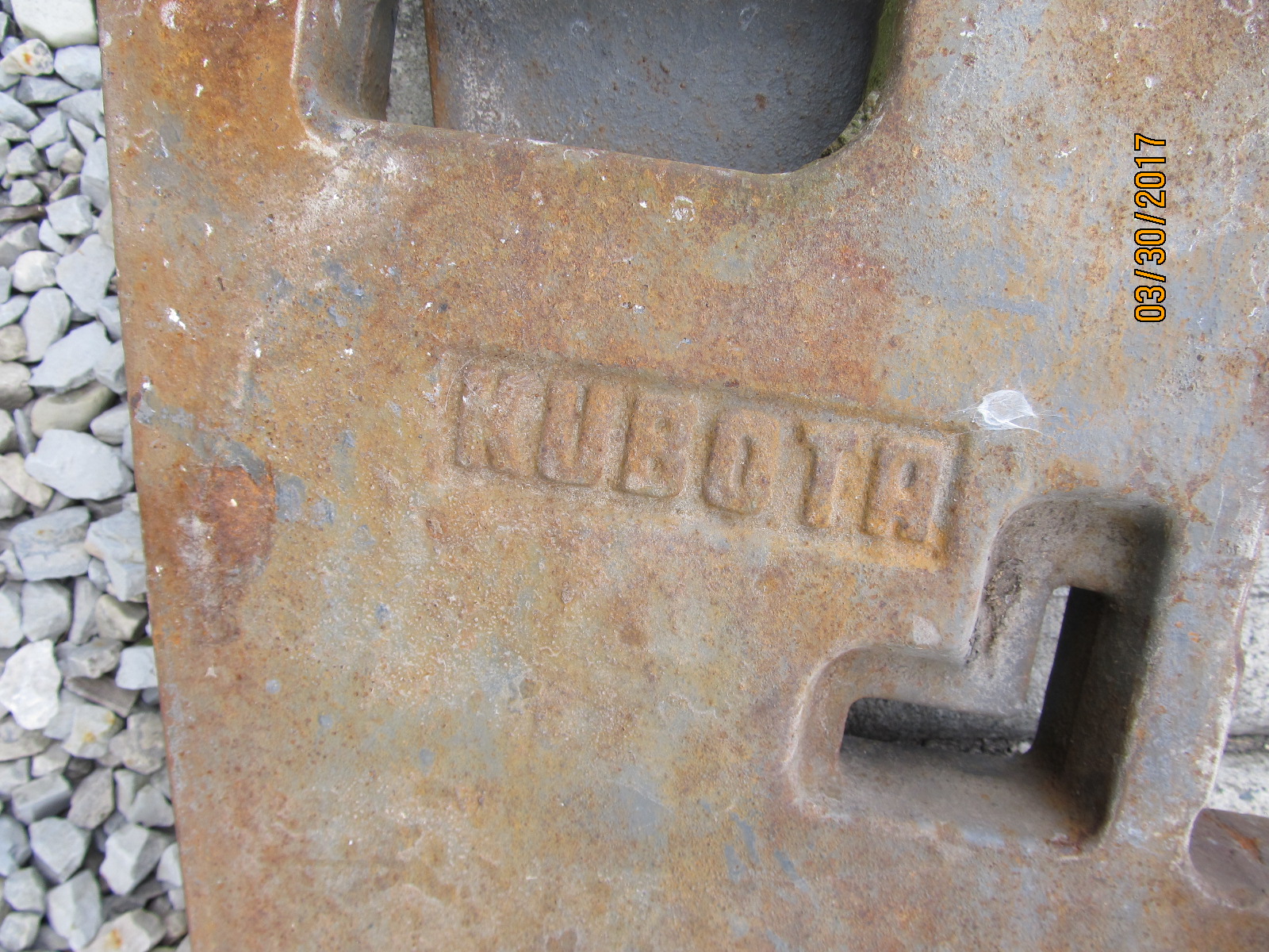

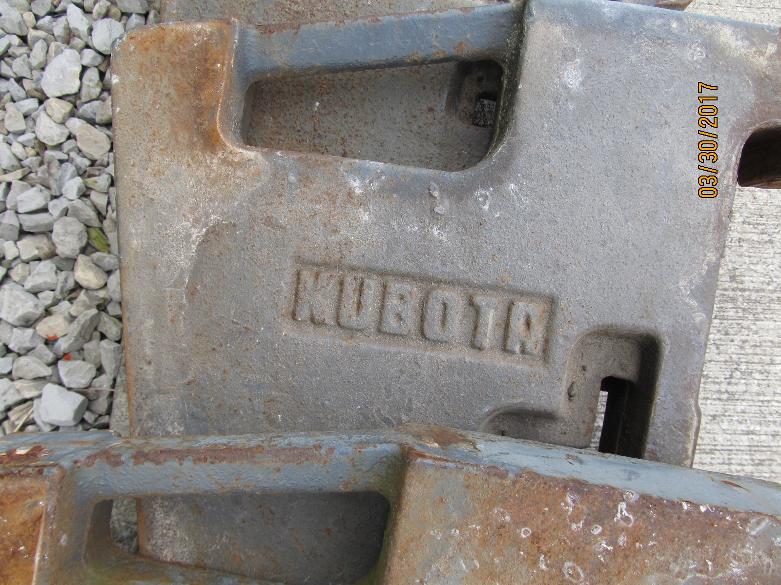

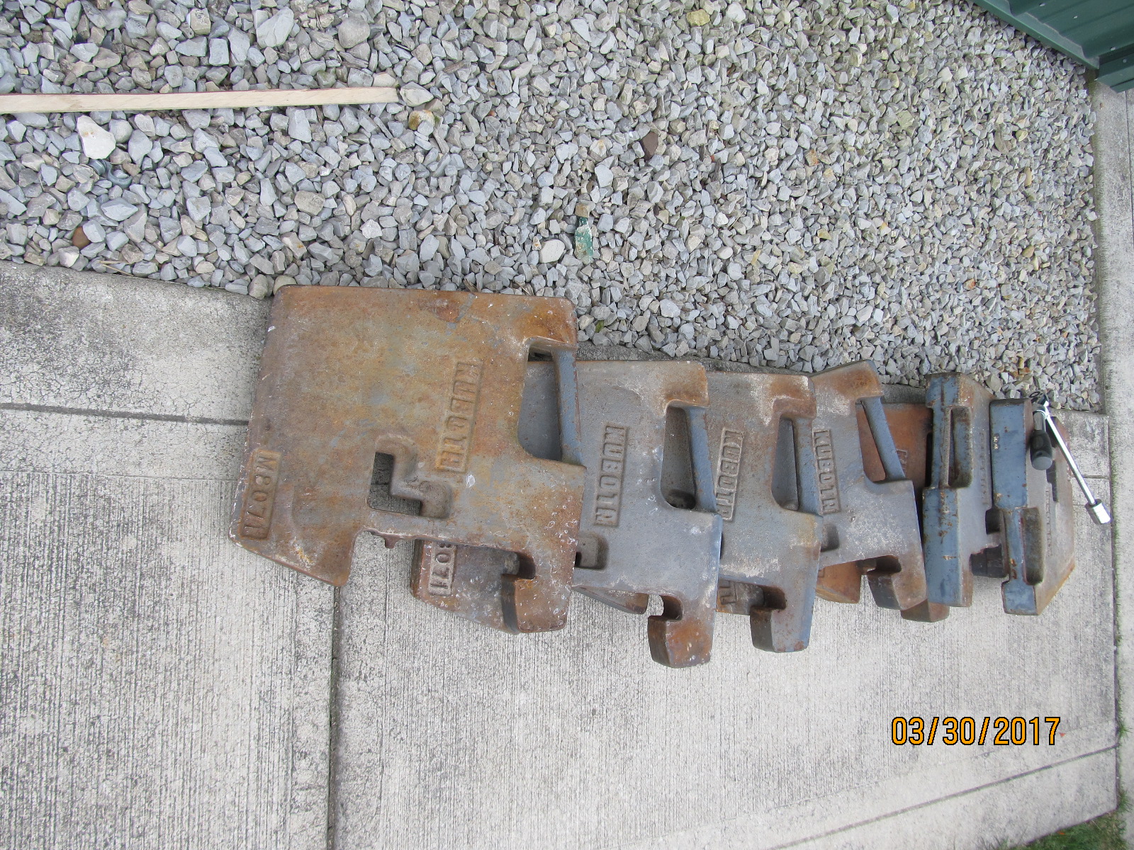

Don't "strip" anything. These are wheel weights and they just get banged up again. I'm like you, however and like things pretty so I get a can of Kubota brand Orange II ($43) and spray the weights before I put them on. You will still scratch them putting them on so save some in the can. After they're on you touch them up with a brush. Don't paint the bolts.
They will line up just fine. You slowly tighten and then whack them and keep whacking them with a BIG rubber hammer from Harbor Freight. You can also jimmy them with a pry bar and will scratch them again. I use a giant screwdriver (3 ft) also from Harbor Freight. The second set you just slowly wiggle, whack and pry into position. Look at the pictures I posted earlier in this thread.
This is brute work and you will scratch those weights again so just relax and touch them up. Most wheel weights get banged up terribly. I come along, spray with a coat of fresh factory paint and people think they just came in at the dealer. Mine from the photos I posted earlier in this thread were all scratched and marked. Imagine what a 1,000 lb rear weight would look like by the time it showed up. Weights only need to look good from 20 ft away and not 8".
Weights are the red headed stepchildren of ag parts and that's just the way it is. You'll be fine and in a few years be using them as an anvil to pound things flat. And the good news? You'll probably never lose a penny on them unless you sell in a hurry. Weights are valuable and give traction when you need it. Plus, they are beautiful when painted and women fawn over the real Kubota Orange II factory color. It's true.
Here's what my front end weights looked like before and after. They looked like typical weights until I painted them. Oh, if you don't have a spray gun, rattle can paint from Kubota ($12) ONLY is perfectly fine. No alternate brands or you'll regret in in six months. Here you go.

I'll be stripping the old paint! They look like they've been painted using a mop -huge runs!
I'm not going with the orange, I'll be painting them using the same color as the base tractor - dark gray.
