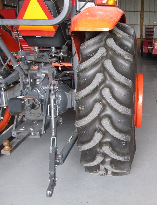

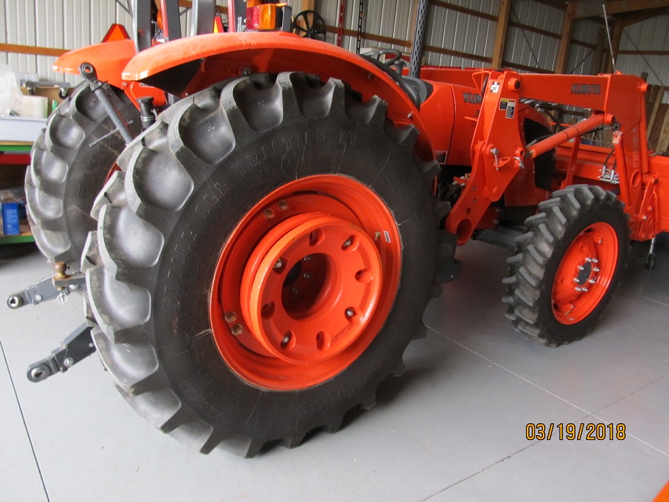

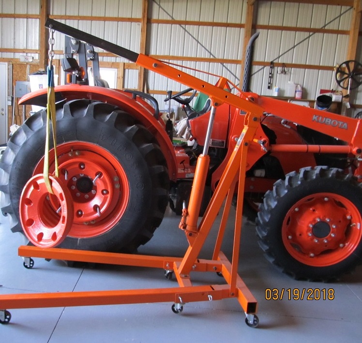

Mine are plain old carriage bolts from the dealer and hardware store. Grade doesn't matter. The so called starter bolts are 5 1/2" measured under the head to the end and 6" over all length. I don't think either would matter but mine are likely 5 1/2" long. I'd say 6" would work but they sell 5 1/2" x 5/8".
The second set bolts, I'm pretty sure, were 7" bolts. That's what it said on the parts bin at the hardware store. I used metric washers for all because they fit tighter. Oops, I forgot to measure bolt size but I'm near certain 5/8". No need to go metric but there is a need to post pics here when done and during.
To center the second weight set you have to tighten a little at a time and jimmy them around with a pry bar or giant screwdriver. Takes 5 minutes and it's close enough. I tightened mine with an impact gun and they'll never go anywhere anyway. I think you can add up to three sets of weights.
You know that weights go one direction if the wheels are narrow and the other way if set on wide. Mine are narrow and bolts might be a different length for wide set wheels with reversed weights.

Try to get metric close fit washers. I think you'll spend more than $20 and pictures or it didn't happen. :)
