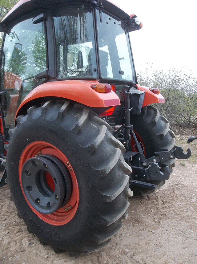

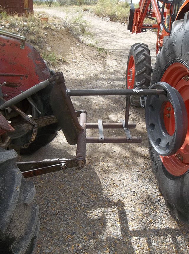

Yesterday, I completed installing two sets of wheel weights on my M7060HDC12. Each individual weight was 164 lbs. With the two wheel weights and the cast center, each rear wheel now has 678 lbs.
To lift a weight into place I made an attachment that fits on a 3PH (see attached photo). The top was telescopic so that I only had to be within 8-inches of the wheel on the tractor I was installing the weights. By leaving off the sway bars, I could also move the weight from side to side as needed.
The other attached photo shows the completed installation.

   / M7060 - Can additional rear wheel weights be added if the tractor has cast centers? #45
Looks Good,
On your 3 pt lift arms are those factory quick connects?
They look like the Euro style were the ball stays on your implement and you can back under and lift to hook up?
#46
LouNY,
Yes, they are the Euro style Walterscheid weld on hooks and balls. I machined new telescopic ends and welded on the hooks. At around $230 apiece, I didn't want to harm the original Kubota parts.
This style of "quick attachment" works great. When making an implement connection it doesn't matter how uneven the implement is and they also can tolerate a reasonable amount of misalignment. More importantly, they also don't require any length changes of the PTO shaft if using powered equipment.
Below is a photo of them after the slots were machined, welded, and painted...
