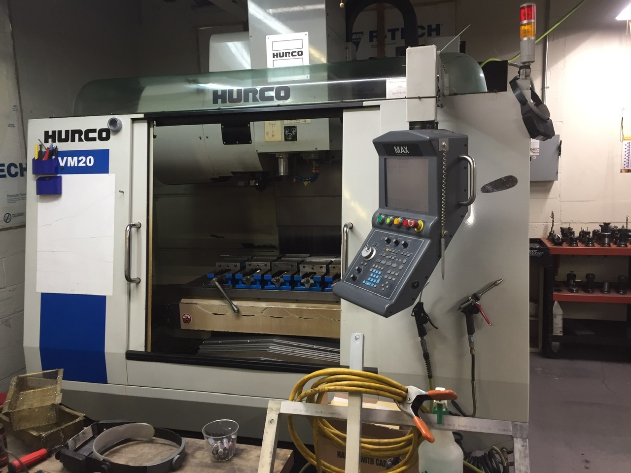

Taiwan machines are great. My second one getting it’s official re-commissioning from the factory boyz this next week.
