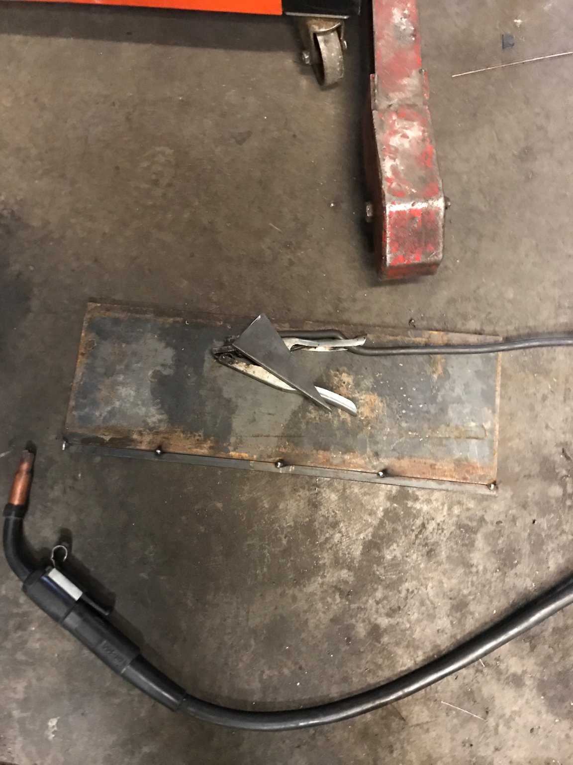

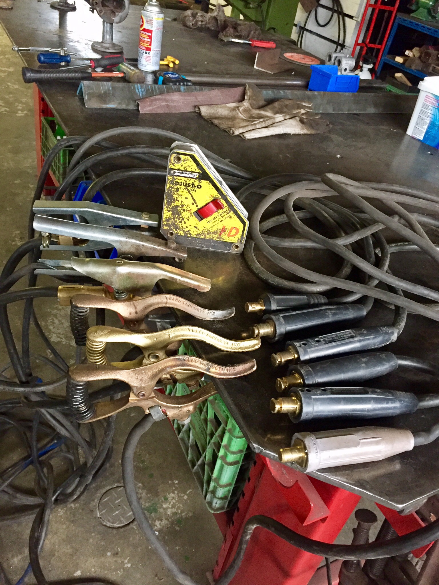

Mark. StrongHand Tools makes a good switchable magnet for welding. Much better than those little red ones.
Here's a pic of one amongst some of my spring type ground clamps. Tweco's , a Lenco, Jackson and a couple of decent 'no name' brands.
Just didn't want anyone to think I thought a Magswitch ground was the "cure all - end all". IMG_2517.JPG

Yes, I've seen those. But $$$$ compared to the little HF versions.
