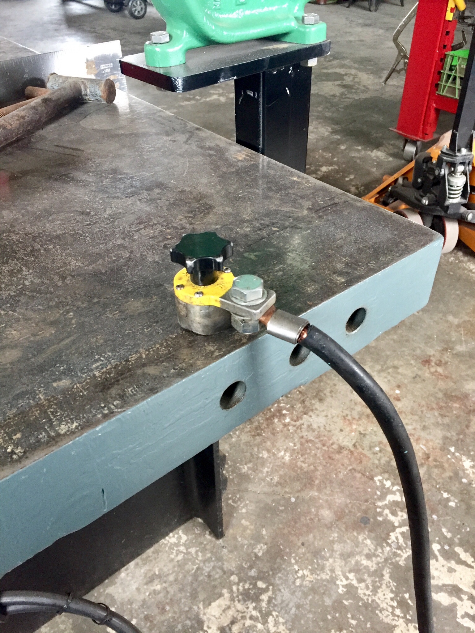

With a magnetic clamp you still need to make a good low resistance electrical contact with the metal below, so paint or thick rust would need to be removed first. You may get away with using it over light rust, though I would take the extra few seconds to clean the surface with a wire brush and be sure.
The one I use has a little lever that can be turned to reduce the magnetic force to almost zero. That makes it easier to remove. It also greatly simplifies the task of cleaning accumulated magnetic "filings" that inevitably accumulate when grinding. They cost a little more, but I think they are worth the extra money.
/ Magnetic Ground Clamp #3
I like mine. Nice for those projects that don't have an area close to your weld where a traditional jaw clamp will work.
Terry
/ Magnetic Ground Clamp #4
Needs clean metal for the electric contact. Magnet works over rust or paint. Electric contact usually right in the middle of the magnet like a bullseye.

I've got a cheap one. Fills up with grinding dust quickly. Not strong enough for rusty/painted. Copper lined the jaws of some clamps and ran cable to it for my little mig. Nice to be able to hold little stuff well with just the ground clamp.

One can certainly get by forever without one but....
Quite often I need to tack up an "assembly" that can't be held tightly in place with clamps. Just carefully attaching the jaws of a traditional ground clamp may knock everything out of position.
The Magswitch however can usually be attached without disruption.
Plus as yomax4 mentioned, it's great for large pipe, large flat surfaces AND my 3" thick steel welding table top.
Terry

I just checked out those reviews, Mark and found the one regarding the weight of the cable pulling the magnet off the workpiece questionable.
I just bundled up 20 pounds of welding lead to see how it would fare.
Magnet held the weight without problem and I didn't see the point in ADDING more weight to see when it would fail.
Even if one was up a fifty foot pole I'm certain they could loop the lead over something to alleviate the weight/strain on the Magswitch ground.

Nice price but once you see the advantage of a "switchable" magnet not "pulling " apart a delicate assembly when attaching you'll never go back.
Oh I can see the advantage of a switchable magnet for small things alright. But if you are welding on a big slab of metal the Radnor type does just fine. It is a two handed job to get off sometimes so there is no question that it will hold quite a bit of weight if the ground cable is suspended from the magnet clamp.
