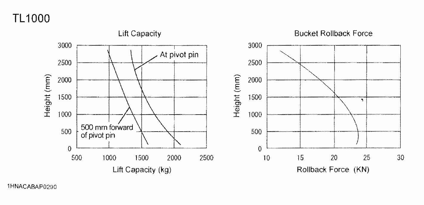

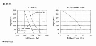

Kubota's loader numbers are at generally given at max height -- which really means it's the minimum lift capacity of the loader. If you look at the lift curve given in the owner's manual for my LA524 loader (same as the LA525 on the L2501), the actual lift capability down low is dramatically more. It's rated by Kubota for about 1150# at max height, but down low where you're going to be doing most of your work, it can lift 2750#. That's another example where paper specs need to be carefully compared to make sure it's apples to apples.
I would like to see the Loader curve for the L3200. (mike69440)
I've used an L3400 quite a bit, and the Loader was soft. I never checked the pressures. (mike69440)
I lift things up, I put things down, using relatively strong small frame tractors that would normally require a larger tractor. But lifting heavy things full height is just scary, and I do my best to avoid. (mike69440)
Loader lift height is very important in this case, since the loader on the L2501 goes a full 10" higher (94") than the loader on the 1526 (84"). If I go by the Kubota curve in the owner's manual, it's rated around 1500# at an 84" height versus the 1560# spec of the Mahindra loader at that height. So now we're talking about maybe 60# advantage of the Mahindra based on that paper spec. If you had only gone by the 1150# rating of Kubota, you'd be missing that it is 10" higher, which explains a lot.
Good point. (mike69440)
