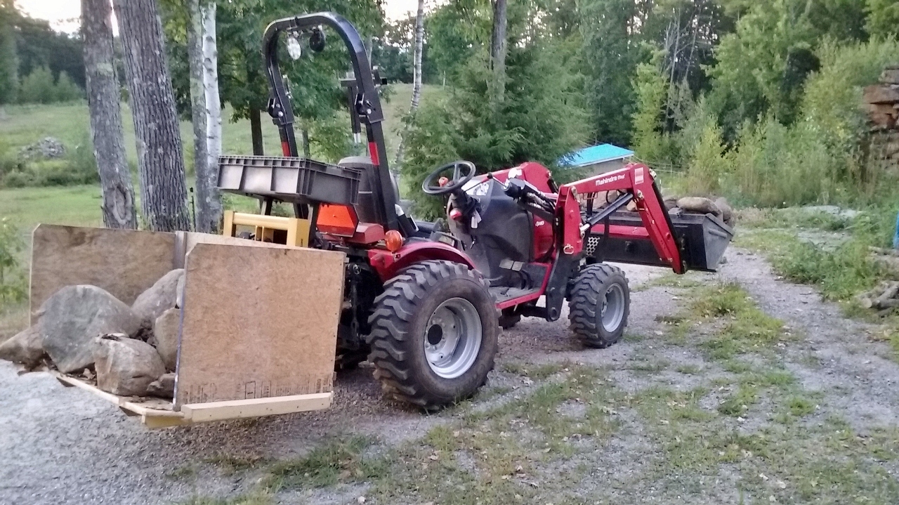

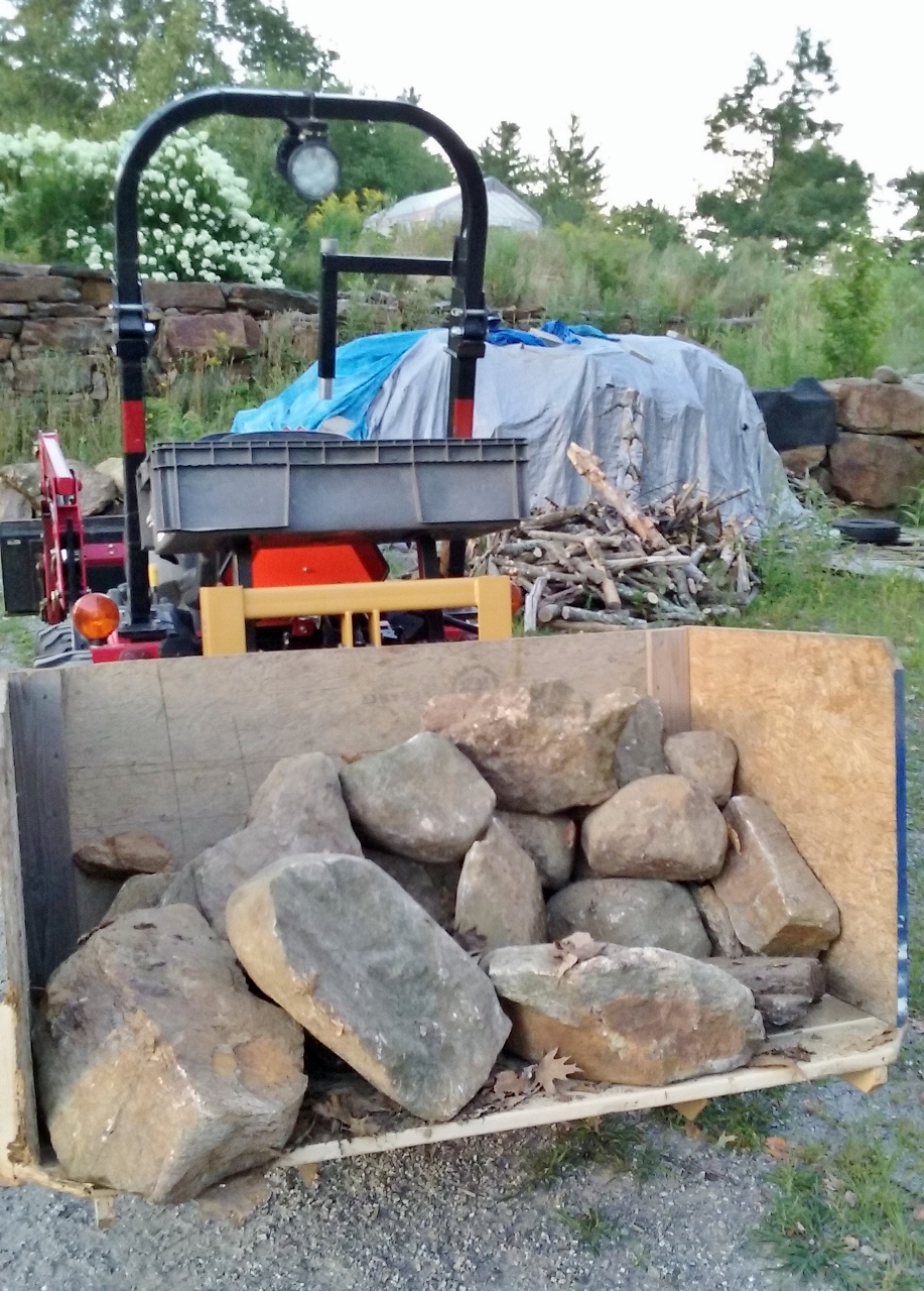

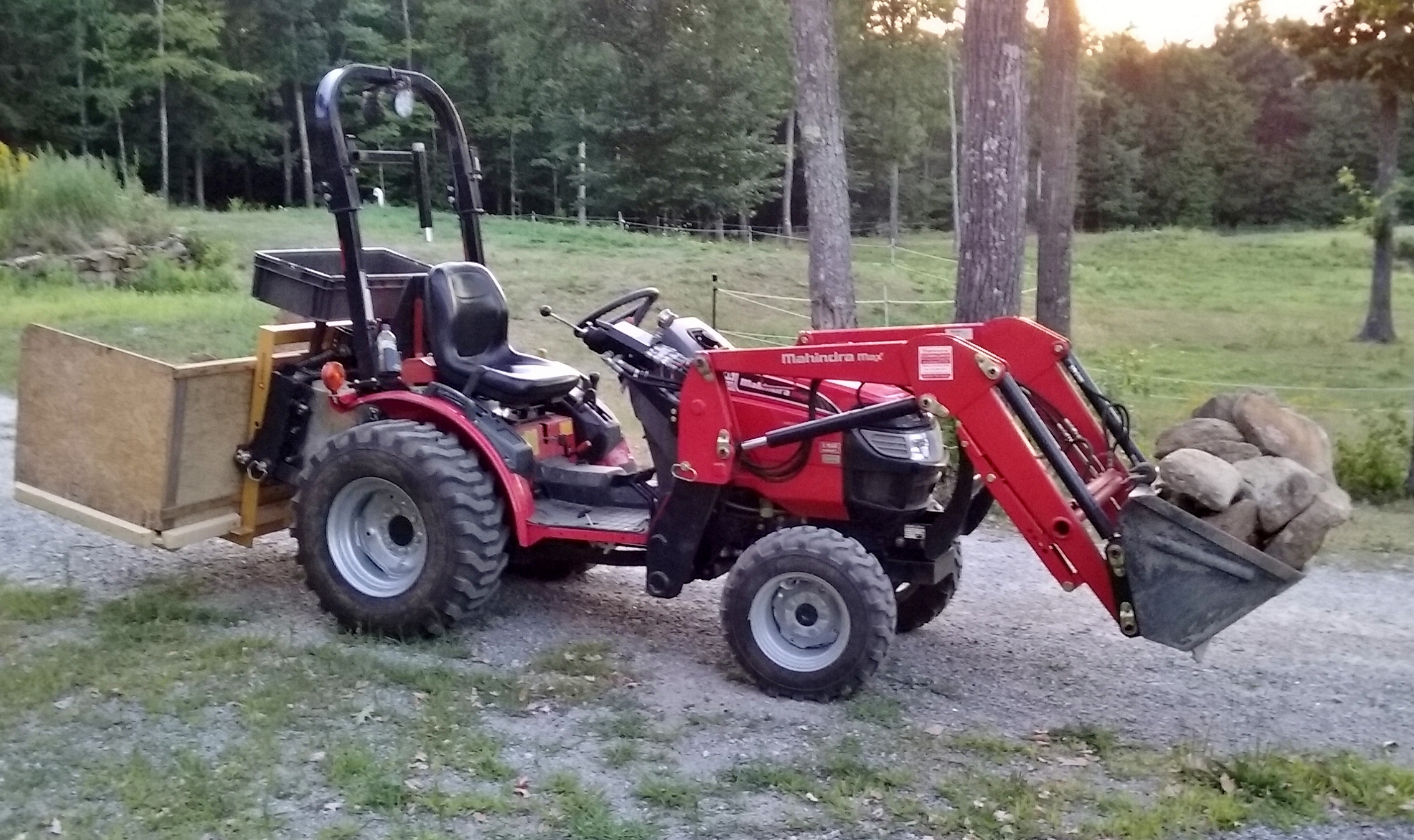

You can't argue with the 3 point lift however Kubota at 1,389 and Mahindra almost double at 2,646.
For sure on the 3 Pt lift!
Lifts +700 Lb steel filled counter weight plus rocks!
A ton or so on the 3 pt hitch.
