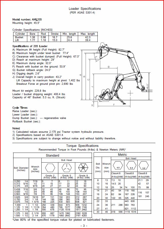

Even Kubota is playing this game now. For instance Kubota is now rating the loader capacity at the pins vs bucket center, so all the loader decals have bigger numbers.
Mahindra in their Brochure for the Max28 / Max26 uses a 3 Piont lift capacity of 2,205 lbs not stating where that value is measured. I assume at the pins.
Per
http://www.clapptractor.com/wp-content/uploads/2016/06/MAXT4-specs.pdf
However:
Per the OEM the lift is measured 24" behind the hitch at 1430 Lbs (650 KG) at a stated maximum pressure of 2063 Psig.
That is quite a bit for a small tractor.
The Loader is rated to lift 1402 lbs at the pins at 2175 Psi but both the loader and 3Pt work off the same main relief valve and in fact the main pump has a non adjustable relief set around 2,000 PSI
The Loader has an adjustable relief and it is set slightly below the main pump pressure. So at best you are seeing -200 Psig under the rated prssure.
So Mahindra stretches the specs, even though being able to lift full height at bucket center 900lbs. or so is quite a lot for a small tractor.
Also Mahindra limits the curl cylinder power to keep customers from doing bad things.
To get the 2,250-2,300 psig I operate at requires a 0.030" shim under the spring of the main pump relief.
So the actual performance of the L2501 is not that far off the 1526 in actual working conditions, but the L2501 will not dead lift what the 1526 will.
But a small 0.030" thick stainless washer would fix all of that. And yes, running your hydraulics at 2,500 psig does not hurt the pump, but does put more strain on the tractor, depending on the operator.
