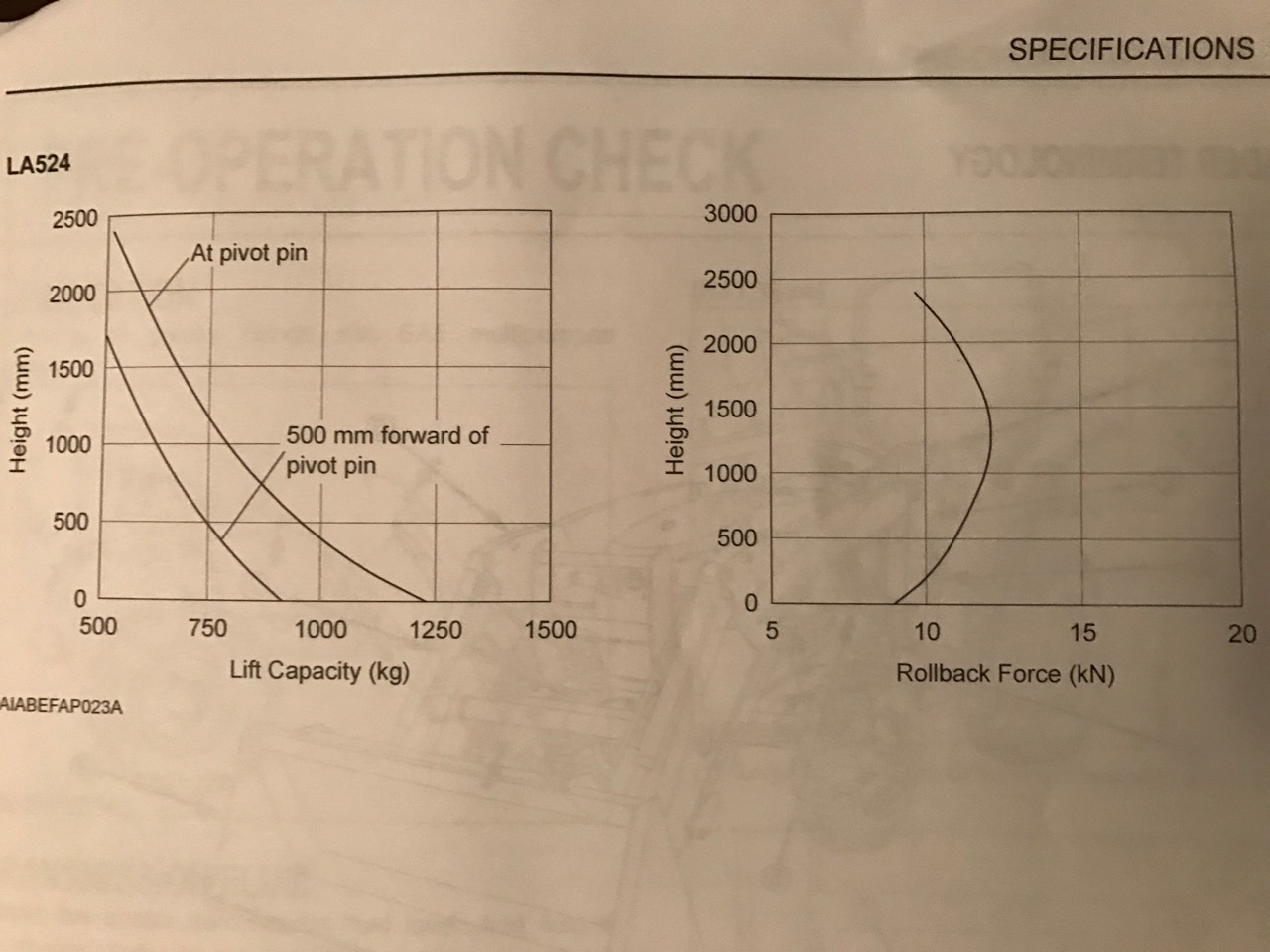

I found the loader curve attachment but it doesn't make sense.. the height is in mm and weight in kg. So converting 94" max height for L2501 FEL it's 2387 mm. Use the crude graph it looks to line up at approximately 1350 kg at the pin. That converts to 2,976 lbs! I wish...! Something ain't right with the loader curve specs.

Re: Mahendra 1526 Vs Kubota L2501
Here's the curves for my L3200 from the owners manual. Same exact loader as on the L2501, but the L3200 has higher hydraulic pressure if I remember right, so that will make a difference. Expect the L2501 numbers to be slightly lower.
Anyway, for the L3200:
The capacity at pins is 2712# at the ground and drops to 1146# at max height of 94". At 84" (approx max height of Mahindra) it's about 1250#.
At 20" in front of the pins, the capacity at the ground is 1984# and that drops to 1102# at about 67" height, where the chart runs out of scale. If I eyeball that curve to max height, it's about 800#. If I eyeball it to 84" (Mahindra max height) it's about 870#.
If you can find the max pressure ratings for the L2501 and the L3200, you can scale all these numbers down by the ratio of (L2501_PRESSURE/L3200_PRESSURE). All of the forces and moments will scale off pressure, so all of the numbers I have here should scale down uniformly for the L2501 based on that ratio.

Thanks this helps. I realized the curve I had found earlier was for a different loader.
