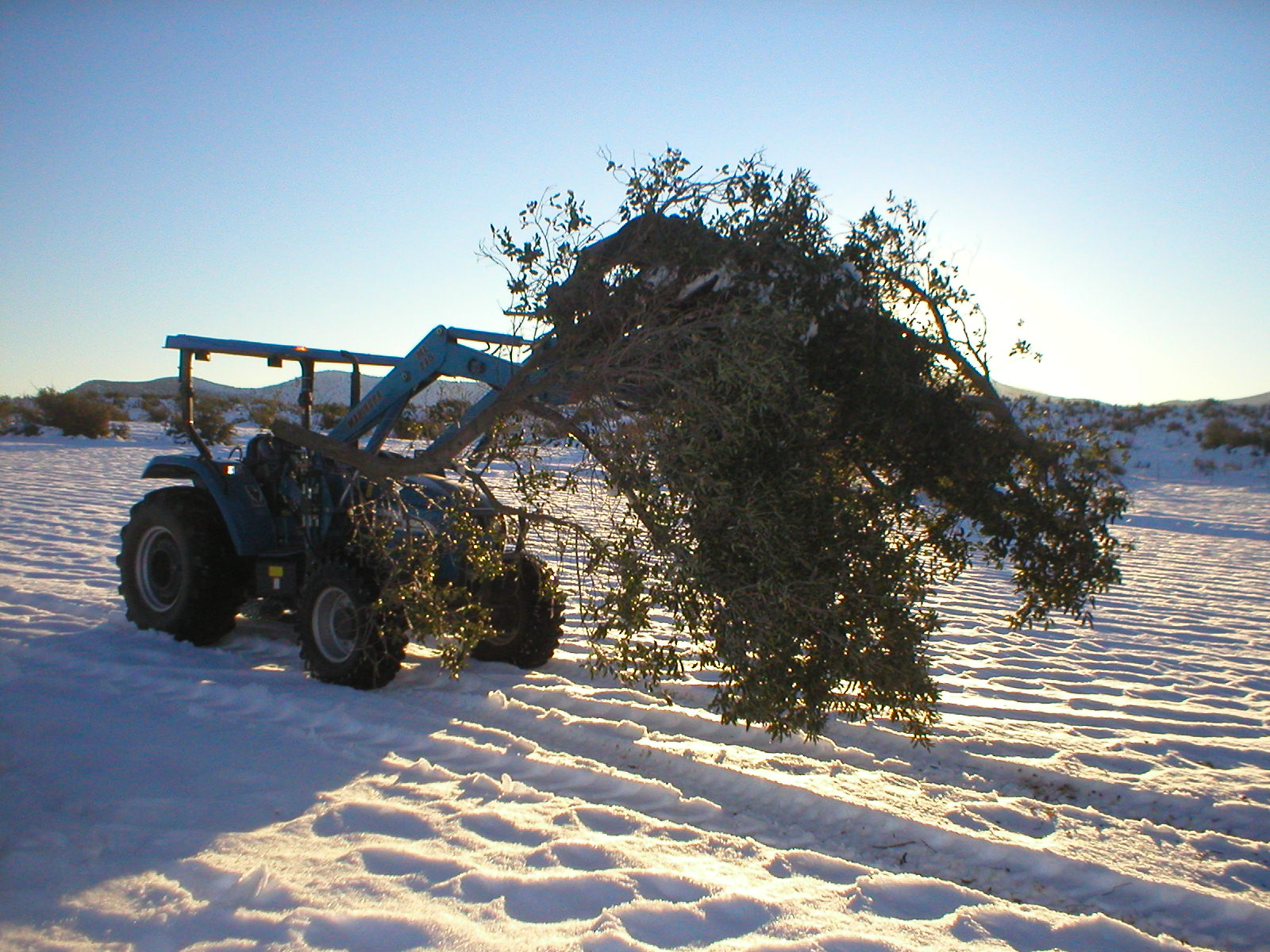

Brian, that grapple pic depicts exactly the kind of stuff I have to pick up and move.:thumbsup: What tractor & grapple is that in your photo? Nice!
BTW, there is a part of me that is thinking: "buy a used bobcat to finish the clean up and a basic tractor to maintain farm". Added together, those would undoubtedly cost more than just buying an upgraded tractor.
That is my Mahindra 7520 and the grapple is this model in the 81" version. When deciding on a grapple, most guys on TBN are convinced that you only need a 48" light weight model, and they are probably right when a guy has less than a 2500lb lift capacity. But as the tractor gets bigger, you can start using the grapple for other things other than just moving loose stuff.
That there is a New Holland BLUE Mahindra 7520.:laughing::laughing::laughing:

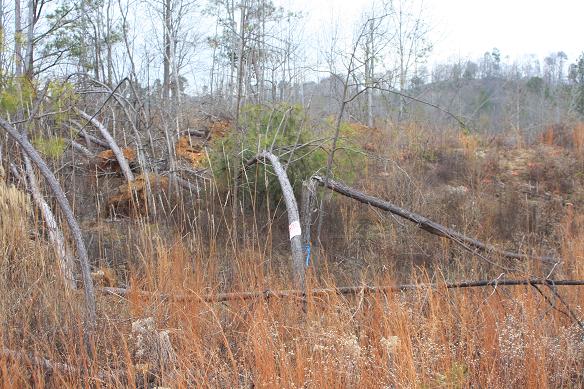

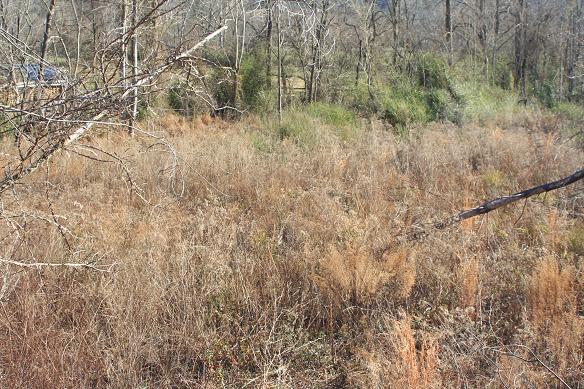

Will try to upload a couple pics for you. One shows a snapshot of what is on the hillside. The other is an example of what needs to be removed from the lowland. Weeds are over 6' tall while the green saplings (in the photo) are much taller. This is a very small section of property that needs clearing, but there is more there than meets the eye. Some of it is in boggy land, too.
The 5-8 acres worth is elsewhere and mostly stumps (which will be removed by trackhoe) so should be handled well with just a boxblade. Will have to look for a pic of that area.

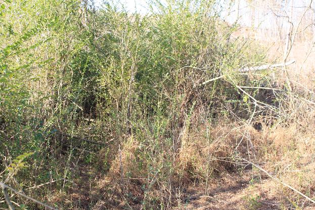

One more pic from part way up the hill looking down on the small area to be cleared. In the middle of this would be an ideal location for a small drainage trench. Providing I can make one without getting stuck.

You could play it safe and get the heavy duty grapple and still have plenty of lifting capability remaining. But no way would you need an extreme grapple. Again, just my opinion, but what ever you end up with, LOAD THE TIRES. Literally day and night difference with how the tractor performs.
You say a box blade for where the stumps are to be removed. Are the stumps gone and you do not have to deal with them at all, or do you need to move them to get rid of them? That is a perfect chore to do with a grapple. Are you talking about filling the stump holes with a box blade?
I'm confused. :confused3:

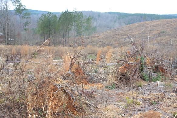

I'm hiring a neighbor (with the trackhoe) to dig out all the stumps. After that, I can either have him pile them for burning or (as you pointed out) I can do that with a grapple. Hadn't even thought about that until you mentioned it. Hmmm, no reason I should pay him to move the stumps at all then. That kind of work would be fun.:cool:
I was thinking of using the boxblade for filling the stump holes and then smoothing the entire area out for seeding with fescue.
This would be good. For some reason I was picturing you dragging the stumps around with a box blade and chain and could not figure out why you would want to do that when you had a grapple. :confused2:

A few pics of the larger acreage to be fixed. Can't see the stumps, but trust me, they are there in mass. Most are 12" in diameter and smaller, with only a relative few larger stumps. In the one pic, you can see the hillside (sloping up to the right), the other side of which is the area we previously discussed. LOTS of work for a new tractor to do, no question about that. :licking:
