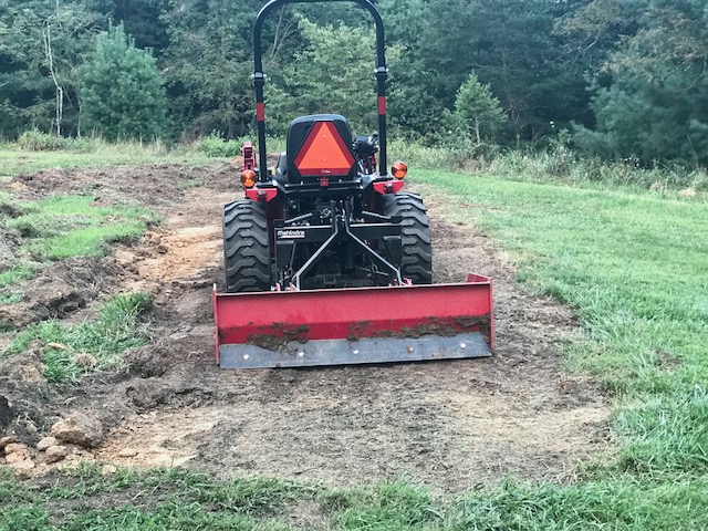

Day 16. Mastering the tilt-n-angle blade.
Having finally figured out how to give the tilt-blade enough clearance when raised to be able to travel, plus leg feeling better, plus finally managing to get the side-link broken loose and greased so I could adjust it, today I was ready for some blading on the driveway. Using the built-in tilt with only three positions, tilted is very tilted. Really only useful for ditches. Had a few areas where the ditches needed to be deepened or smoothed or just weeds scraped out. Blade was also angled of course.
I don't want deep ditches; instead, I slant the driveway to the side I want it to drain, then there's just either a small channel, or if it abuts higher ground, it just ends there. That way once it's shaped right I can maintain it with a box blade easy. Was able to finally get there. Tractor makes it easy-peasy. Continue to be surprised by the power of this thing. Cut through heavy clay full of rocks with no problema (a perfect soil moisture level helps).
Continue to find it's usually best to take things in stages. Drop the blade so that the tip of the lower end is digging in just a couple inches, then another pass deeper, and another if needed. Not for lack of power, just I can sculpt it just the way I want. In one part where I was making a new drainage ditch off to the side, dug in deep and tore through, including big roots, easily.

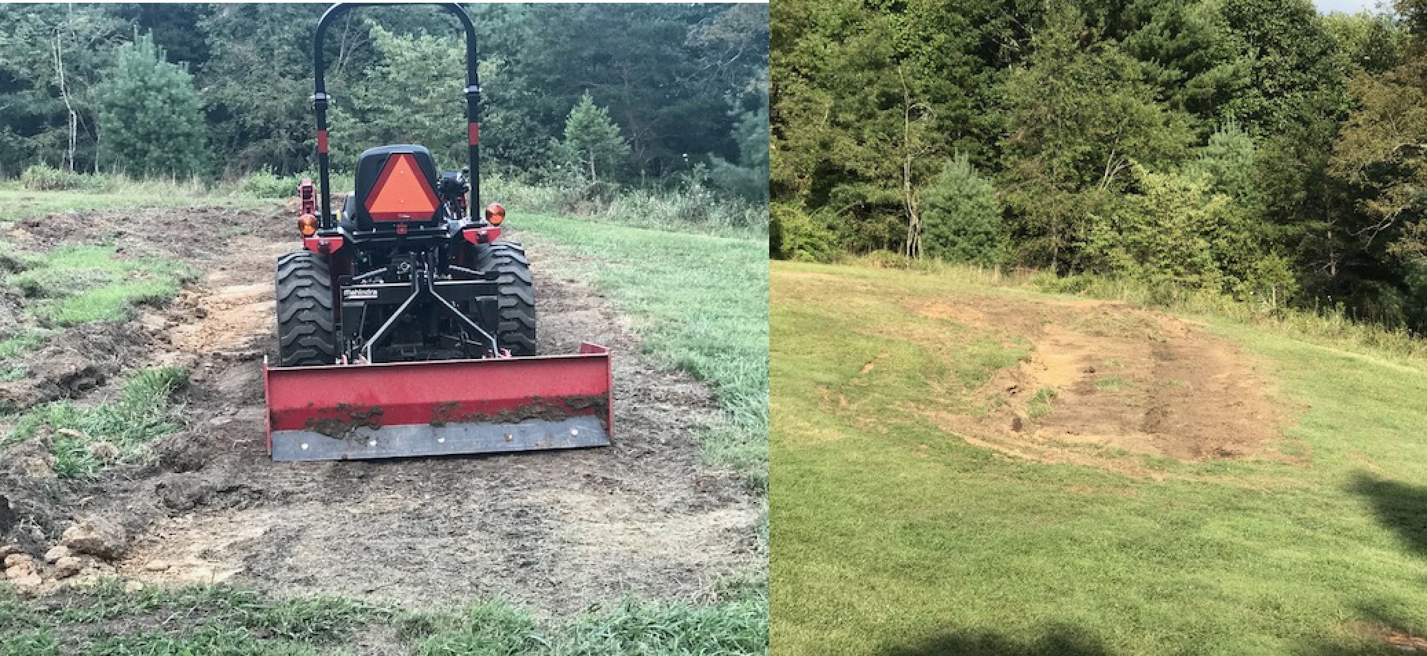

Once I was done digging the heavier bits, wanted to smooth out the transitions. So set the blade level, no tilt, and used the side link to drop the right side until I had a much subtler tilt. Did a very nice job and also threw a lot of gravel back onto the driveway from the edges.
For me, the blade is a much longer learning curve than a box-blade. I think almost anyone can drive a box-blade up and down and get a pretty good result. I love them. But for seriously changing the grade, the blade is great. Think I'll go all the way and finally get the driveway graded perfect. Then a couple passes with the BB to re-spread the gravel and I'll be ready to call it done. Pics will ensue at that point if anyone's interested.
(Non-pro tip for driveways: decide exactly where you want the outer edge of the blade to hit, then spend the time to get your tractor lined up straight and exact, adjust the blade depth with a delicate touch, and note where your tire lines up to the edge, so you can watch that instead of the blade to keep it straight. Then once you're committed keep going. Turns and sudden adjustments to blade height will create sloppy edges that will need to be fixed.) Yes I'm fussy about neat edges on my driveway.

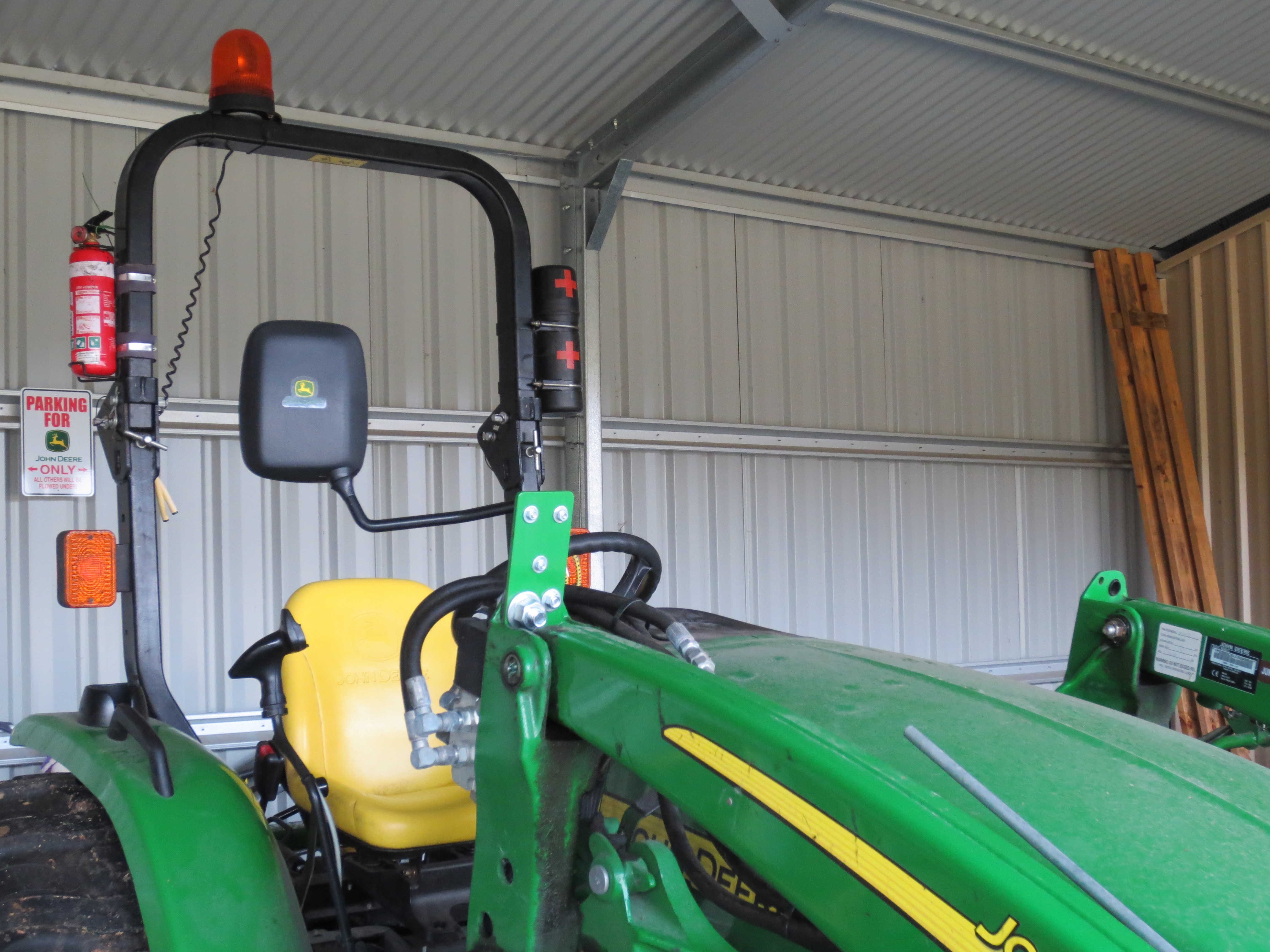

No accidents today, just a sore neck. Any recommendations on a big mirror? :)
   / Mahindra Max 26XL HST - A New Owner's Journal #44

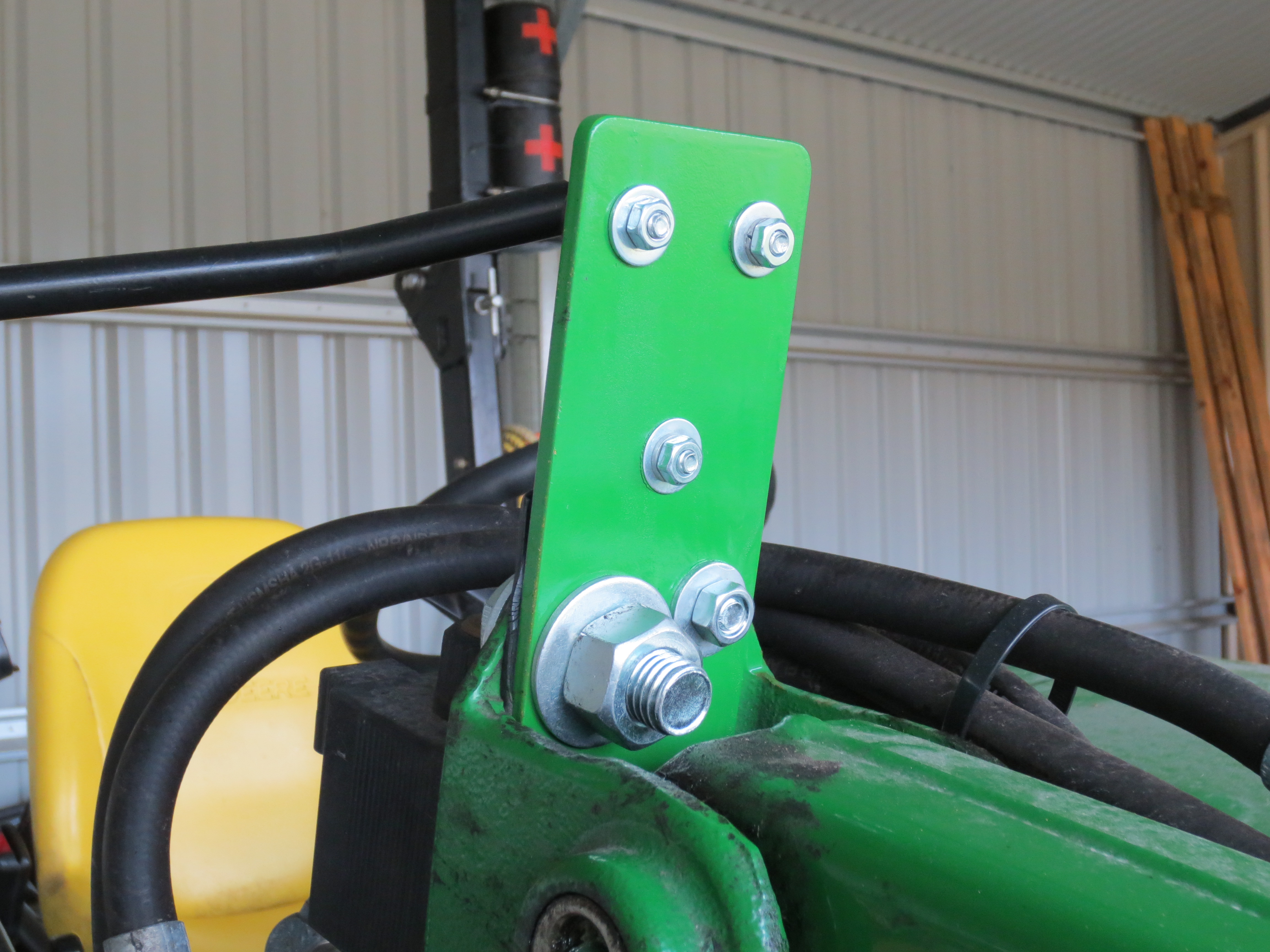

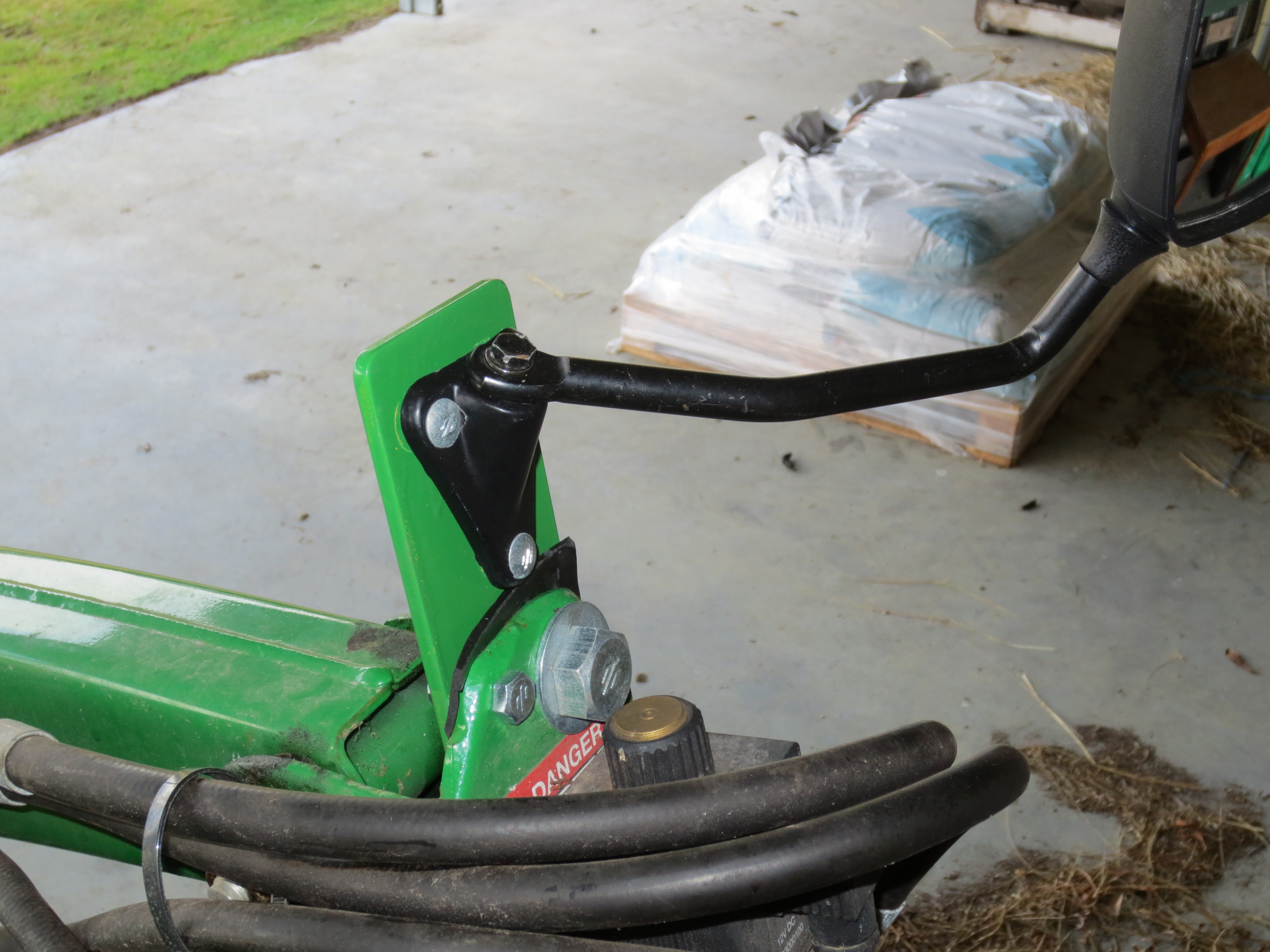

Many TBN members, with an open station tractor, have had success mounting a 'van' type mirror(s) to the top of the FEL arm(s). Mine is mounted on the right arm because we drive on the left side of the road; for the odd occasion that I'm on a public road/highway.
There are threads about this... aren't there always! :thumbsup:
That's nice! I did look for threads. Will look for van mirrors on google. Thanks!

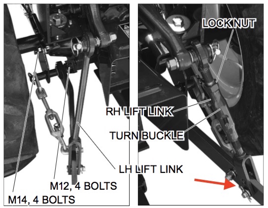

Got a good rain yesterday, so the driveway was moist enough to finish up. So. First, unhook the landscape rake. Then hook up the box blade. Box blade the driveway a few times to re-loosen things up (the fun part; I would almost pay people to let me box blade). Then unhook the box blade. Then I needed to use the tilt-blade to adjust some ditches. Previously, I discovered I couldn't raise it high enough when tilted to get more than an inch of clearance when traveling. Turns out the arms that come down to support the lower links have two holes, and it was set in the lower ones. So pulled the pins out and used the higher holes, gaining me almost 2" in height. Also, finally worked the adjustable side-link loose, greased it up, and now it works like a charm.

If you decide that you would like to have the rear blade lift even higher, (really more for transport) put the top link in a lower pin location on the tractor. ;)
Did not see that the top link had this type of adjustment (will look tomorrow). Was able to raise the two lower lift arms though. The red arrow shows the two holes for adjusting the height of the lower lift arms. Probably all tractors have this:
   / Mahindra Max 26XL HST - A New Owner's Journal #48
I'm pretty sure that there are 3 separate pin locations. :thumbsup:
