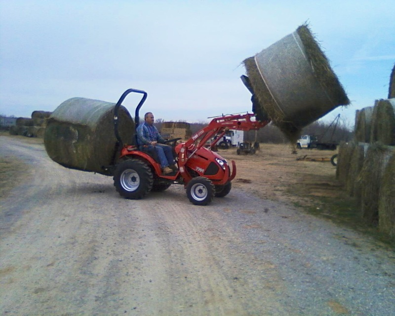

Dave, there are a few companies in the world that make the real forklift mechanism for the 3pt hitch. I would think that would turn any tractor into a forklift... a real one. Have you come across any of those? I'll try to find the links...
Tractor mounted forklift lifting a round bale - YouTube
Tractor Mounted Fork Lift - YouTube
These are fairly common in the ag world for moving prune boxes and nut boxes, although fancy bin carriers are taking their place. No doubt the rear of the tractor is a great place for carrying heavy loads.
