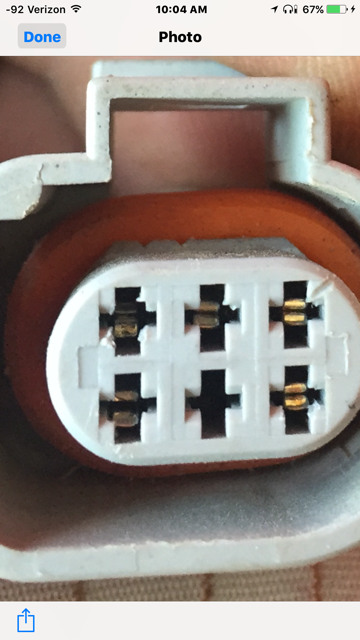

Dealer said they found this issue with EGR plug. Bad spread on pins causing a bad connection. Hope that does it. Dealer has been good to me through this.

Hey guys I'm new here but have owned a Mahindra tractor for 5 years. My first was a 4010 HST and my second which I just bought last week is a 5555 shuttle. 4010 never gave me any issues but day one the 5555 has issues. My main concern is the MIL light comes on ALL the time and puts it in limp mode. I did everything you guys have suggested like running rpm's up around 2000, started it at idle etc. This is very aggravating that I can't even use the tractor. I don't want to have to stop tractor every thirty minutes to do the idle/run reset 6 times. This new tractor should run at any rpm's with no problems. I do not get the white smoke you guys say you see, the light just comes on at random times. Dealer came out and hooked up his laptop to it and it does show a egr issue. He did the update (again) and said try it but after he left I started running the tractor at 2100 rpm's and after about 15 minutes I looked down and noticed the light on. other times it came on was when I restarted it after I ran it for a while. They are picking up tractor as I type this. Dealer say they don't see any issues with these 5555's and are puzzled. I wish they would just bypass the egr crap but I know that is not happening. I miss the 4010 now but not the small size it was. Sorry guys just had to vent.

Did they pull the EGR and clean it? My MIL came on after 4 hours... they came out, re-flashed, pulled the EGR and cleaned it. No more MIL's after that and have over 50 hours on it (2555) and letting it warm up @ between 1200 and 1500 RPM.
