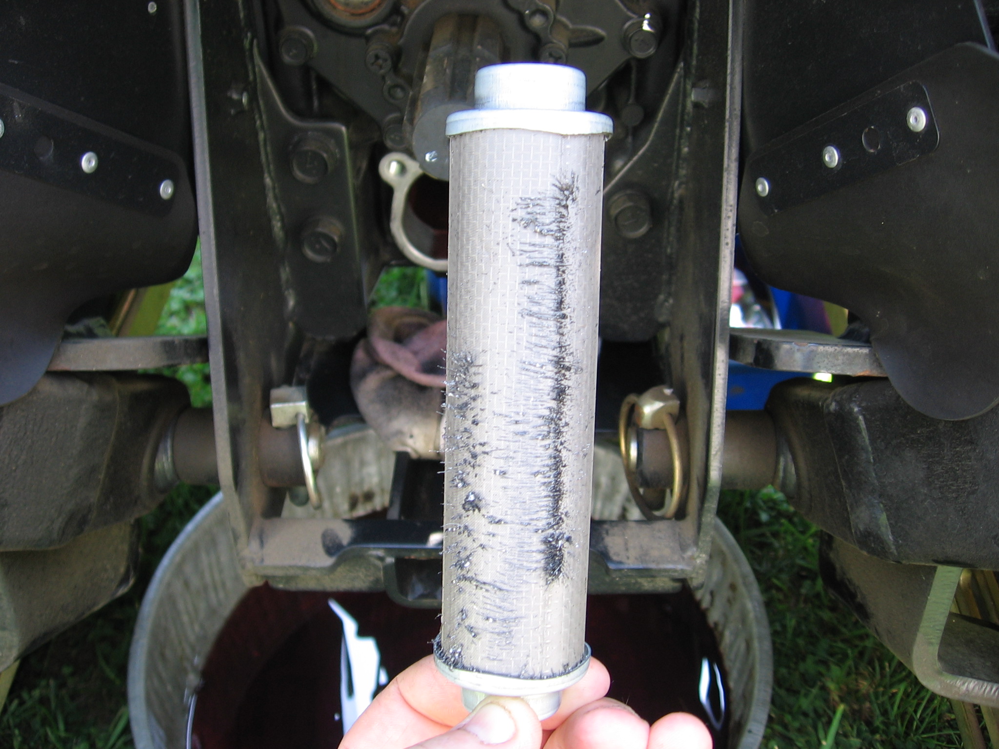

   / Maintenance - 2520 #10
   / Maintenance - 2520 #11
Gobblin Tom said:
Did you have any shavings or small chunks outside the screen?
Yes, there was what appeared to be debris from machining caught by the magnets. The magnets are very important, and I'm always amazed by how long it took vehicle and equipment manufacturers to realize that a well placed magnet will greatly extend the life of a mechanism.
   / Maintenance - 2520 #12
glc24 said:
Tom,I think this is normal.
Greg
Yes, that's about what mine looked like at 50 hours. I'm curious to see what it looks like after another 200.
