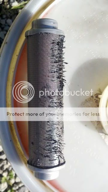

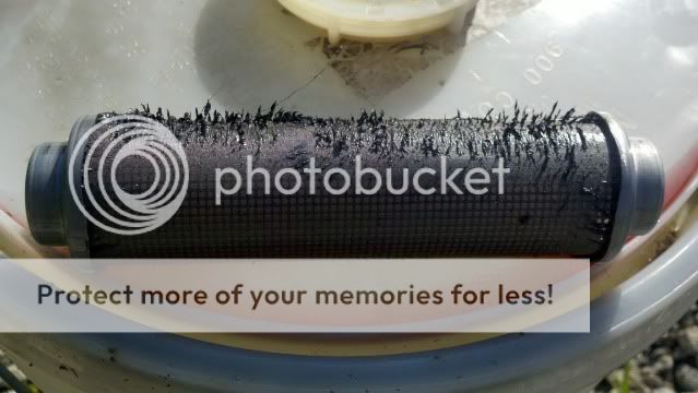

I just changed mine and there wasn't a spring there.... I did have a lot of fine metal on the magnets and some shavings and chunks on the outside.... My original factory tranny filter had magnets on the inside also but didn't have any metal on them. I didn't put the magnets back in the new filter...

Did you have any shavings or small chunks outside the screen?
/ Maintenance - 2520 #8
I changed my fluids over the weekend. I had closer to 60 hrs than 50 tho.My trans. screen had alot of metal filings on the outside and the magnets had a coating of metal particles as well. One thing....the manual (online an written copy) states that the engine holds 3 qts.,its actually 4 qts. verified by numerous other sources,including here.
Yes, there was what appeared to be debris from machining caught by the magnets. The magnets are very important, and I'm always amazed by how long it took vehicle and equipment manufacturers to realize that a well placed magnet will greatly extend the life of a mechanism.

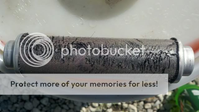

glc24 said:
Tom,I think this is normal.
Greg
Yes, that's about what mine looked like at 50 hours. I'm curious to see what it looks like after another 200.
