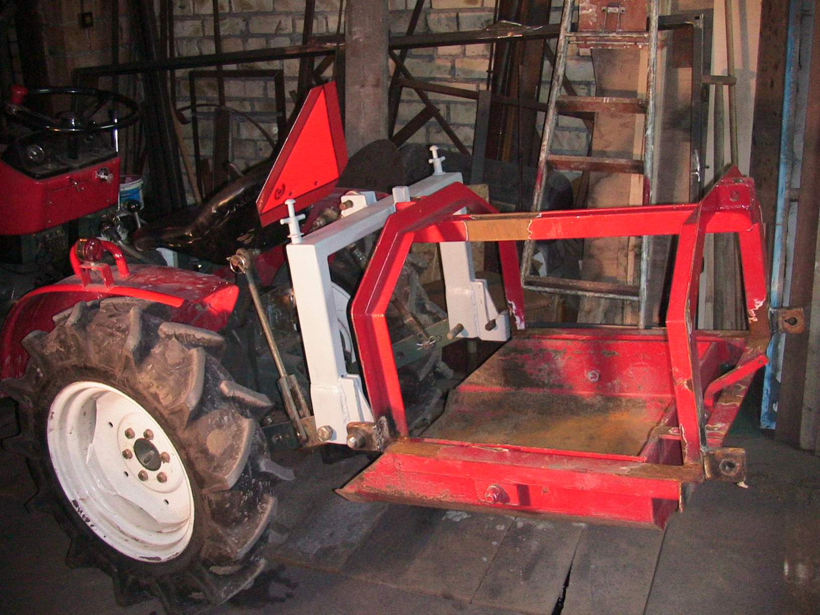

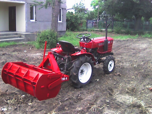

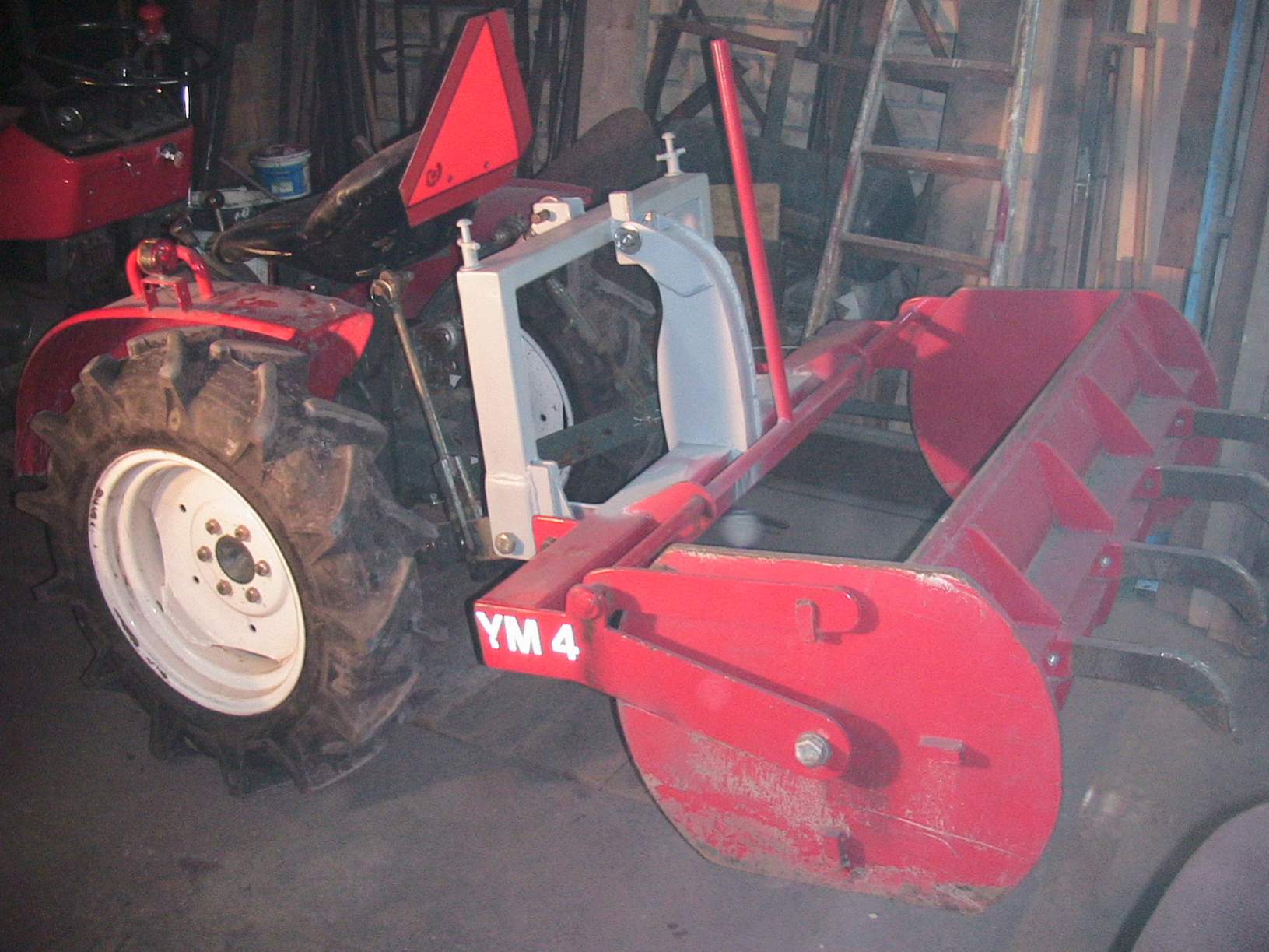

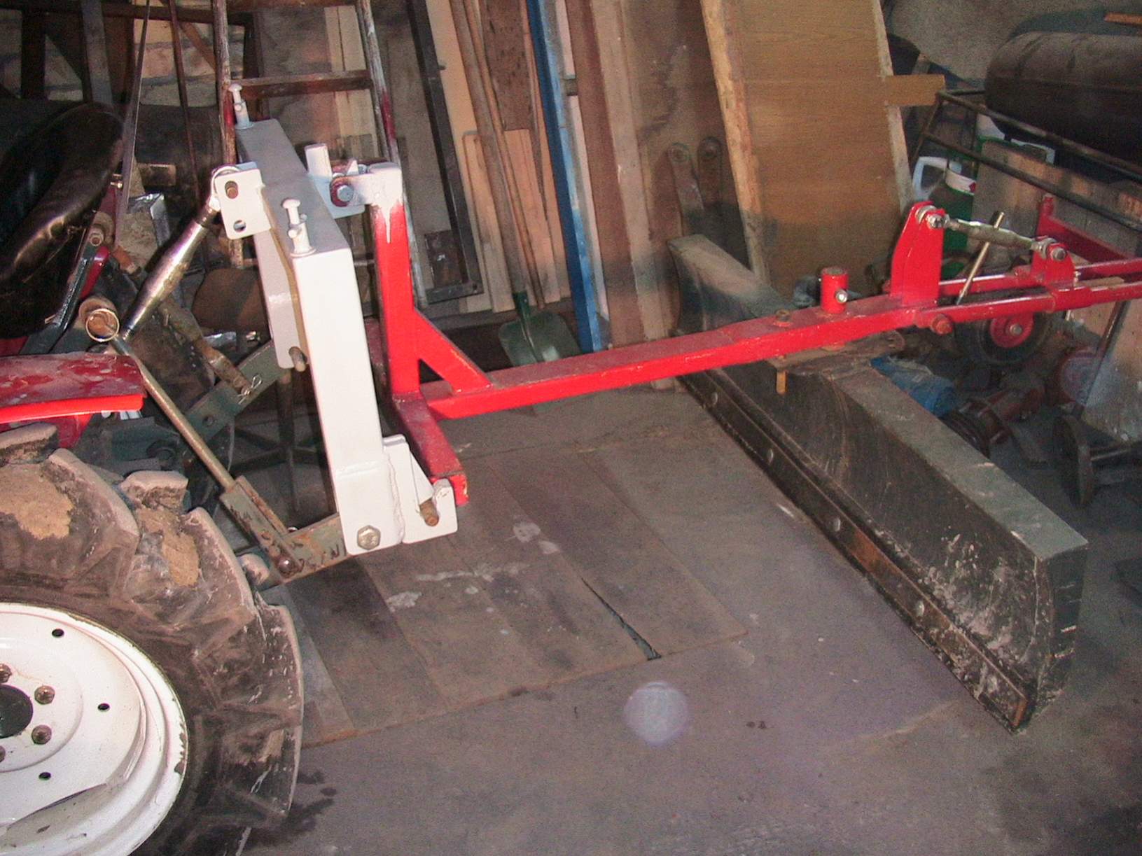

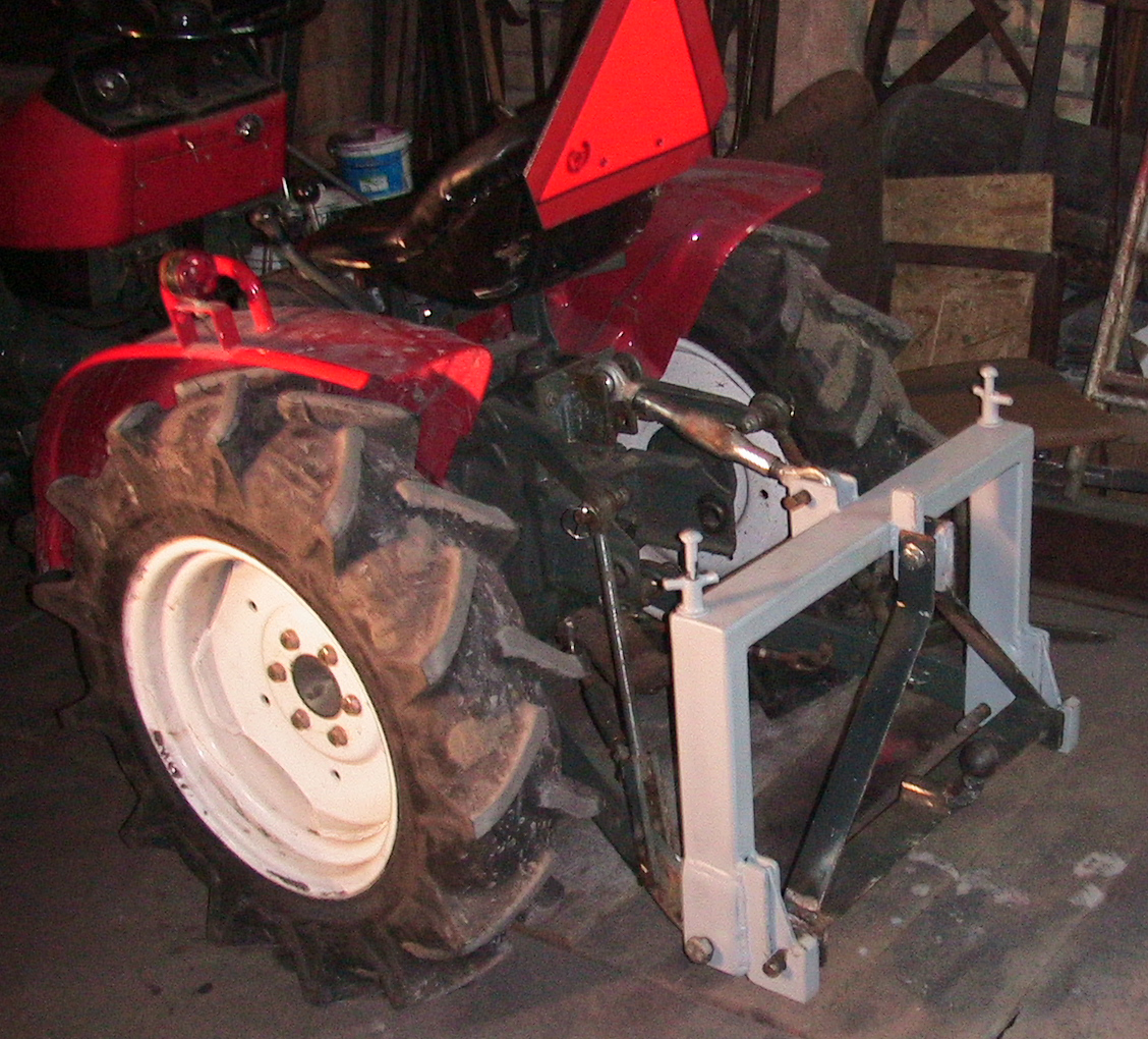

I had a few snatches of time here during Christmas break to work a bit on conforming my implements to the QH. First I polished the QH up a bit and sprayed some primer on it. Then, I started with the RB and ended with the Rollover. For most part I just did the standard thing to conform them, but the rollover I treated special.:D
The RB top link connection was a 1/4 inch low.:eek:
The ball hitch was right at standard. :)
The scoop needed its bottom pins spread about 1/2 inch, top is OK not perfect.
Mike

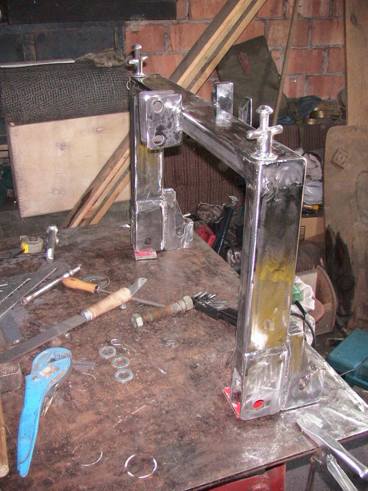

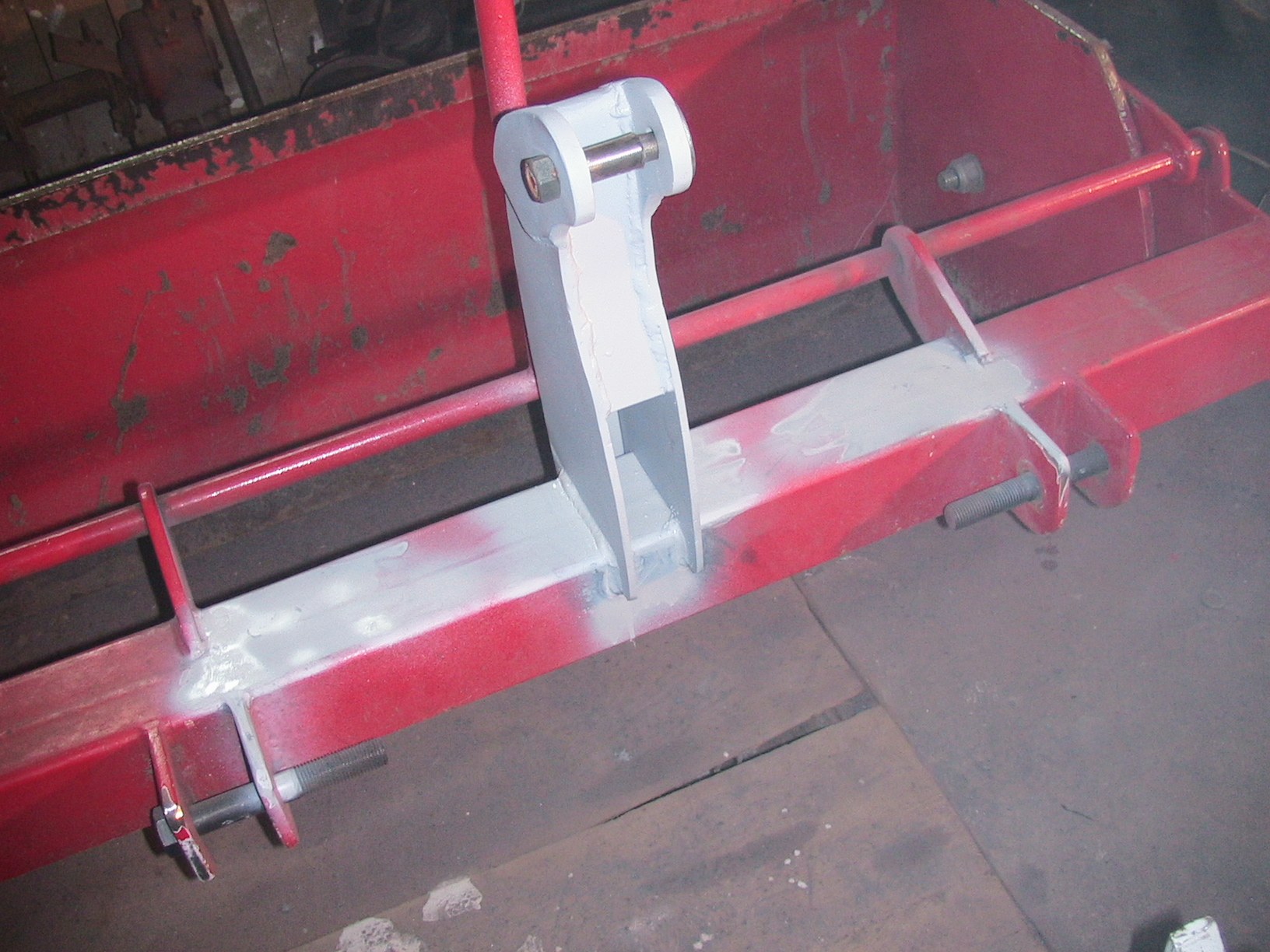

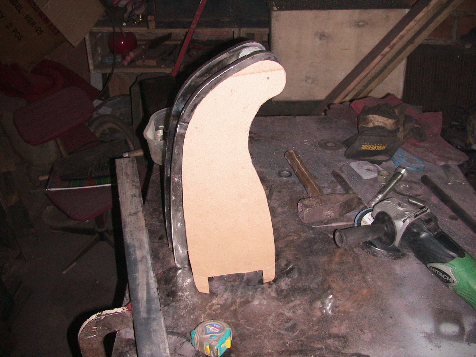

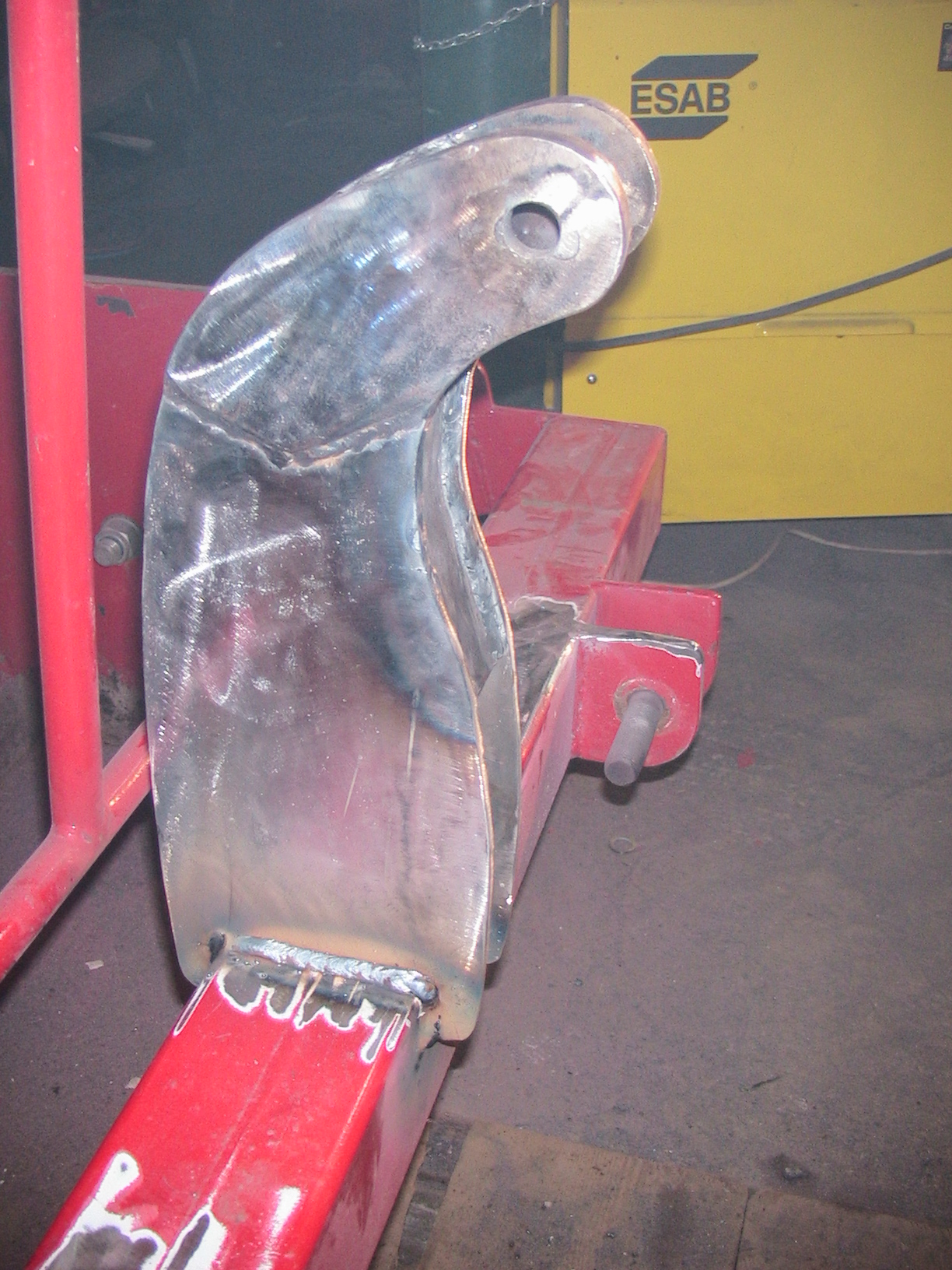

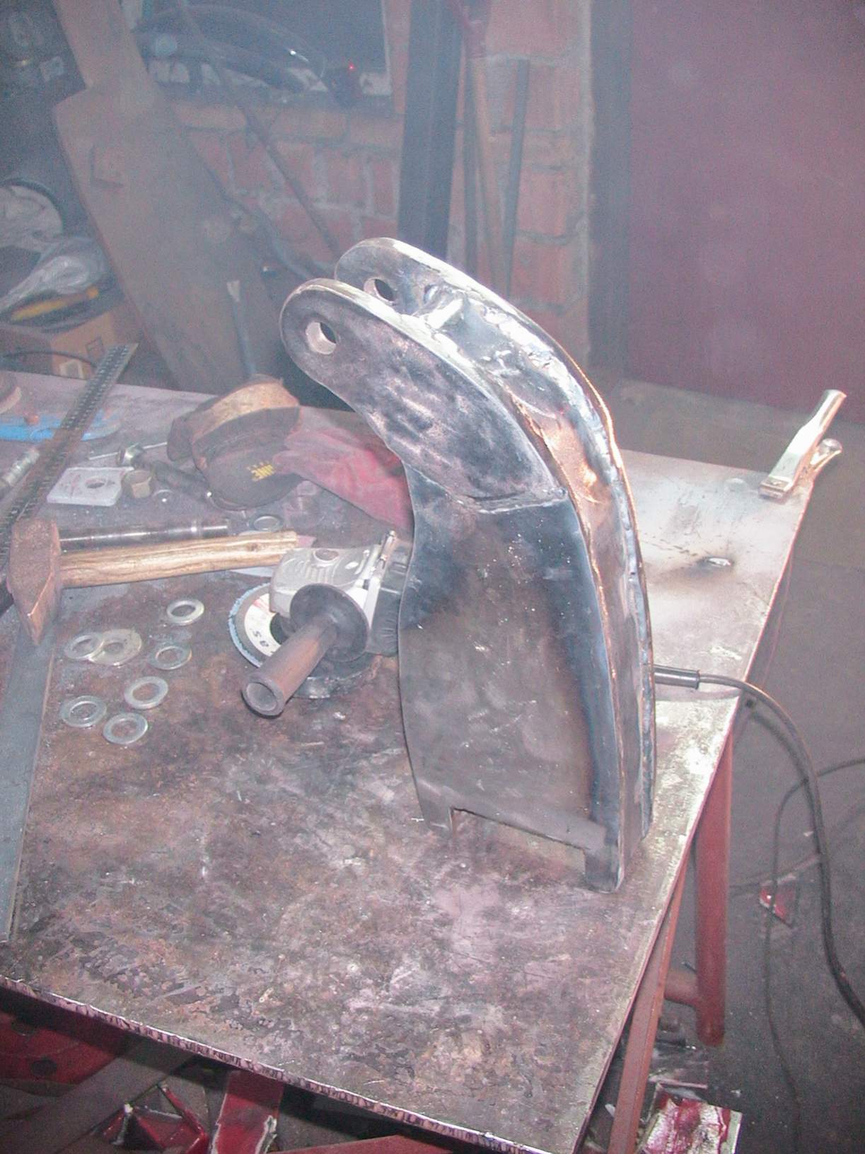

Now the imitation Gannon rollover was OK on the lower pins, but somehow in the manufacturing I messed up and the top was about 1.5 inches high. It is not a design that would be easy to just lower the hole or drill a new hole. I was going to require some major work to conform it.:eek:

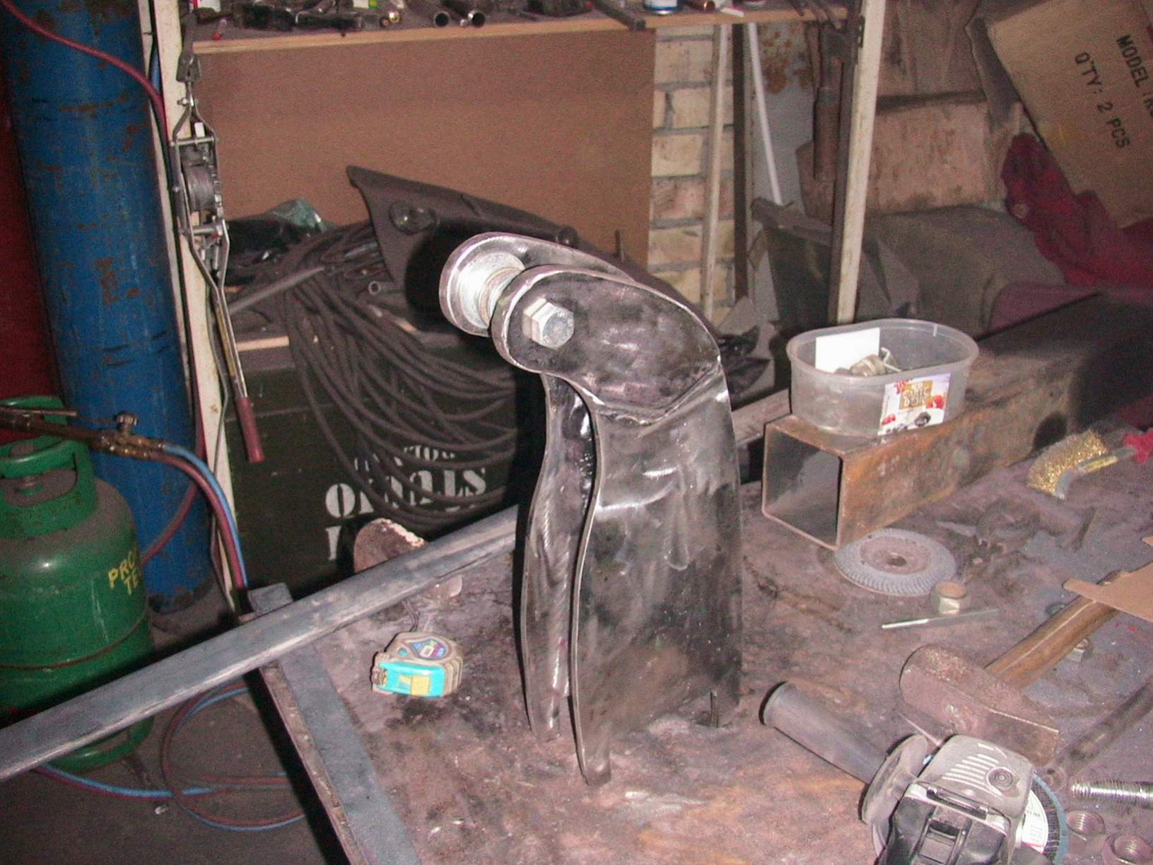

If I was going to do some thing major I might as well do something exciting.;) So I drew up this curved neck for a top link and cut the pieces out of the old top link mast. Well I had to patch a few pieces together to get sufficient width.
Then I doubled up on the neck where the pin goes through to give it a bit more strength.
Then I conformed a 2 inch wide flat stock to separate the posts and provide some stability. I have wanted to try to do something like that for a while and it was a good opportunity. I just heated, bent, and tacked until it was all in place.
I welded it on the draft tube of the rollover, sprayed some primer on it and it was ready to go. I like the way it looks. It looks special and it was fun to do--although it did take some time. It sort of looks like a penguin sitting there. :D
Mike

Well back to topic---I discovered something yesterday that I had not anticipated--well I should have if I had thought things through. :rolleyes:
I was using my scoop in the reversed position--back into a pile mode--as a large dust pan. Normally, when I dump it I can just reach back and trip the mechanism, however with the QH, I cannot easily do that, the hitch blocks me and I cannot reach the trip without being a contortionist. I am going to do something about that--beyond the rope that is normally used in the forward scooping position. Have to think!!!
Have a GREAT New Year!!!
