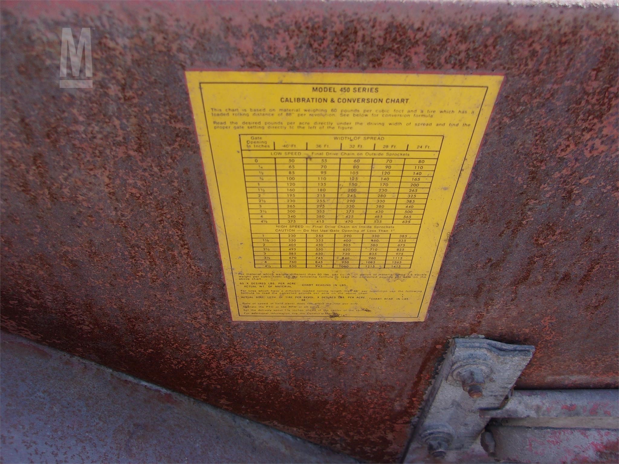

I have purchased a Calhoun 450 Fertilize Spreader and am trying to restore it. I am excited to get to use it real soon. the trouble is I have no diagram or guide for the gate setting to know how open to set the gate for my application. I have searched the www all over and found nothing on these models. I have seen other similar models from John Deere 301, United Farm tools 450, and New idea model 111. I think the charts on these may be close enough to work for my Calhoun. if anyone out there has one of these models with the calibration guide chart on thiers, and could snap a picture of it for me I would be more than grateful.
I have a Calhoun 450 that was my grandfathers. I am in the process of restoring it.
The Calhoun 450 and the United Farm Tools 450 are the same unit. United acquired Calhoun a number of years ago.
I found a chart online that should suit your needs.
