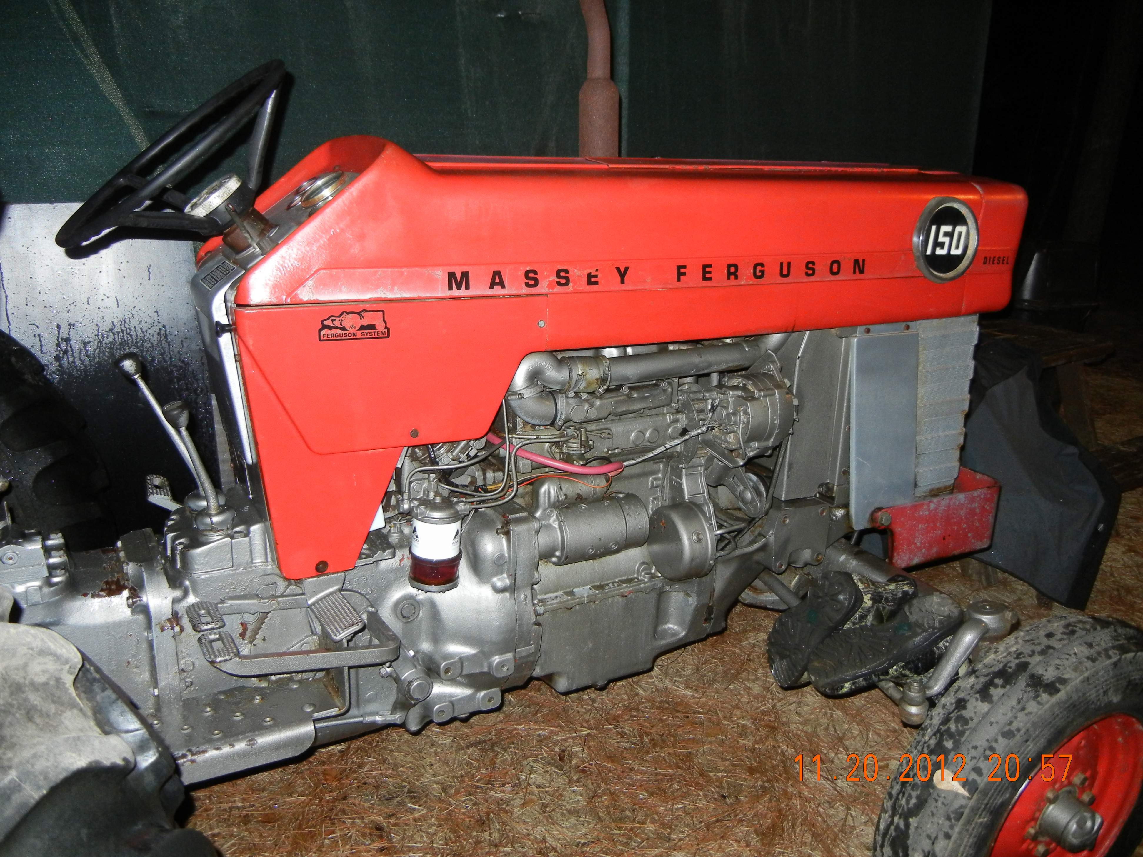

Am I missing something, or do you just have one brake? Also whatcha huntin' with a flashlight? BobG in VA

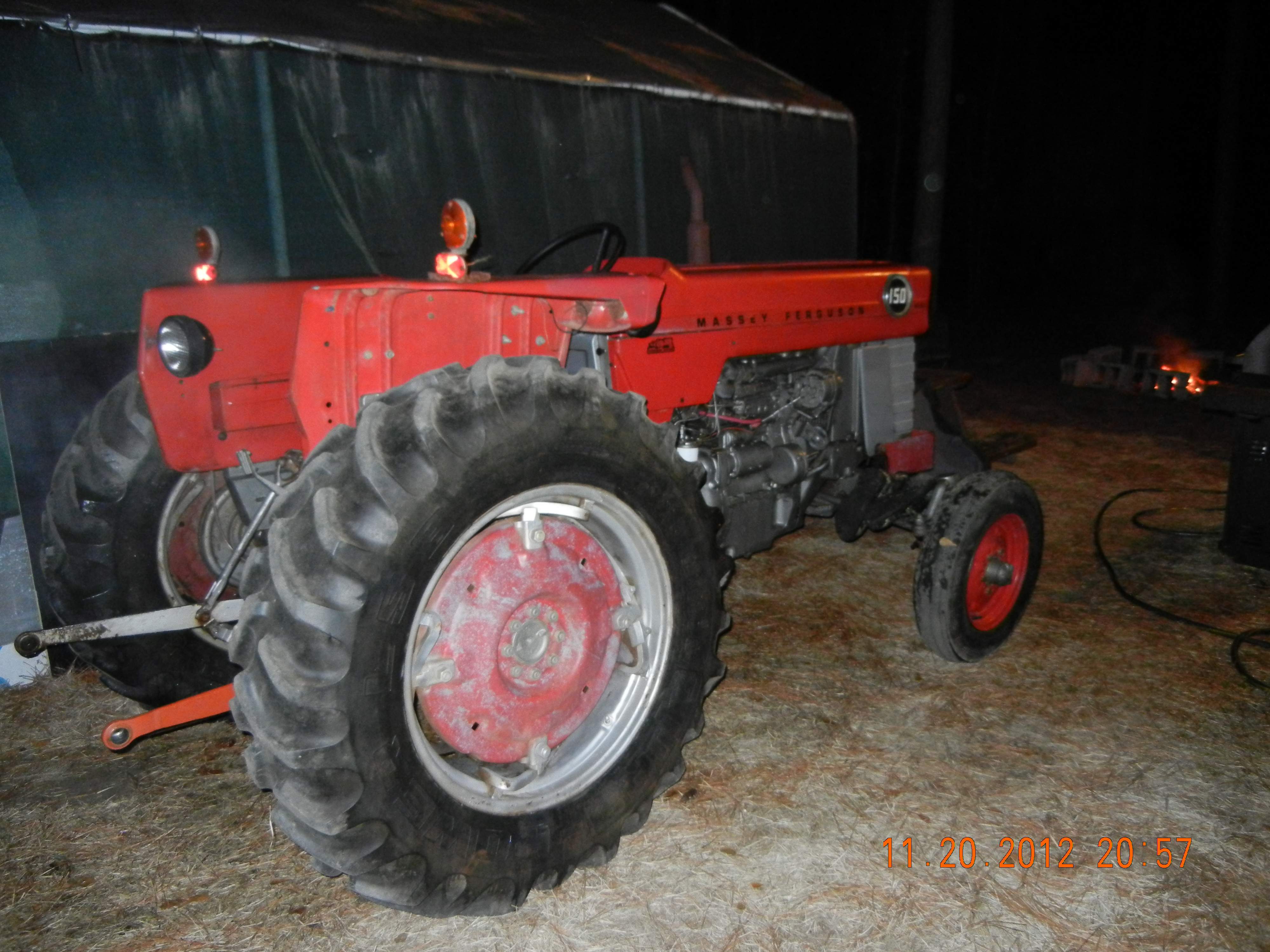

Im getting a knock in transmission but when i press down on clutch noise goes away the clutch and gears work fine does anyone have a clue what could it be orther than that the tractor works great

Its not a flashlight its a range finder and what do you mean by one brake

In the other pic, it appeared to me that I could only discern one brake petal...my mistake...bobg

I have a 1974 massey 150 i am getting a knock in tranny but when i press the clutch in the noise goes away it shifts in all gears fine and the clutch also seems to be fine does anybody know what the noise could be any help would be appreciated
/ Massey 150 #34
Captjj,
I'm no expert, but it sounds like you have a throw out bearing going bad. The tractor would need to be split to change it and I would put in a new clutch while I was in there.
/ Massey 150 #35
I know this may sound crazy, if you hear the knock when you have the clutch half way in (ie. at the end of the first stage) and you still hear it, but don't when you push the clutch all the way down, I'm betting you have your hydraulic (3point levers) all the way up past the "transport" line.. drop your levers down to midway and see if you still hear it... it may be pumping and against itself causing the knock. BobG in VA
/ Massey 150
#36
Thankyou very much sounds right because this week put attachment on three point and didn't hear knock anymore ran great once again Thankyou
