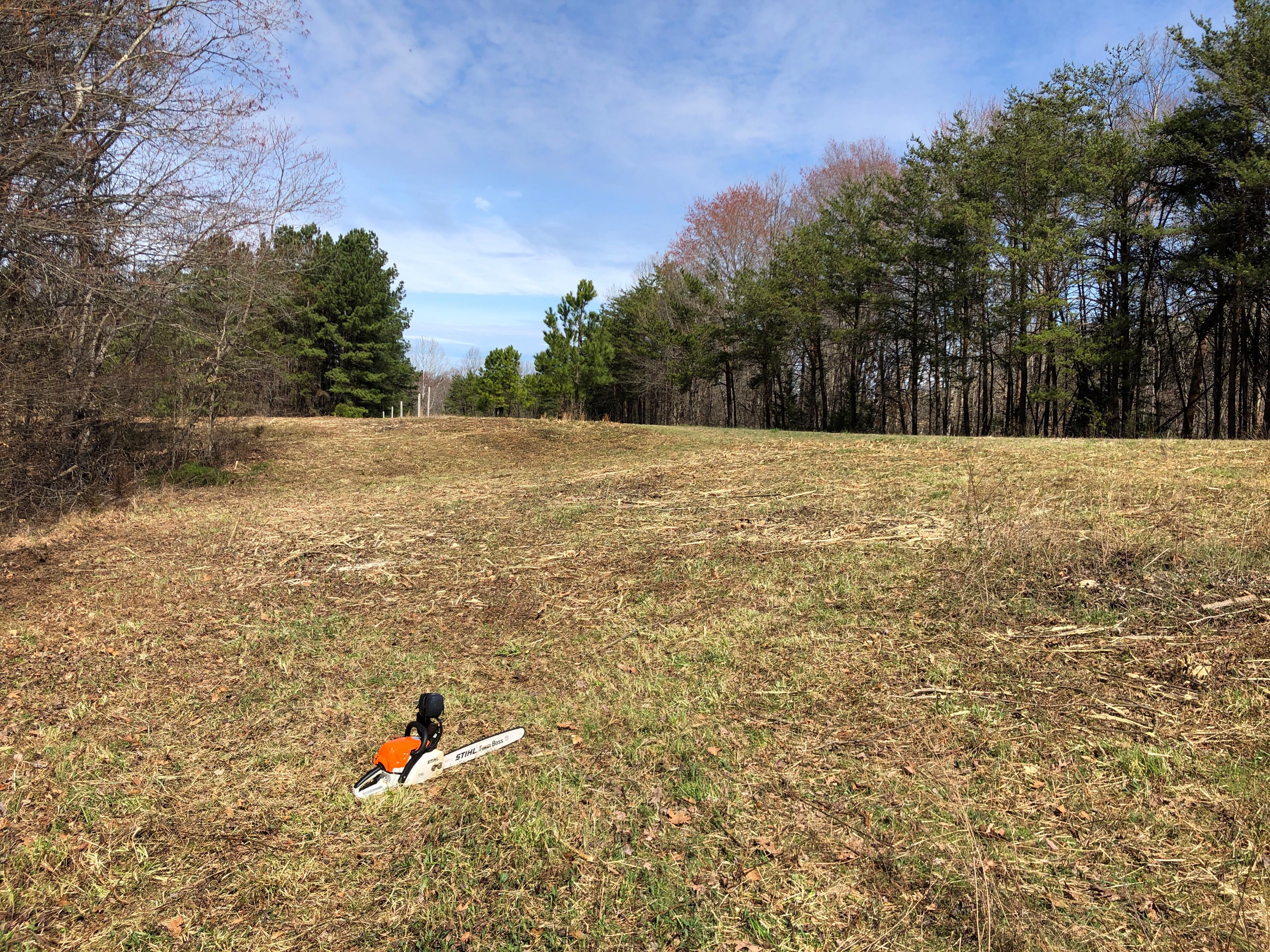

No not at this point. Actually I would rather do this myself to make sure it’s done right. I’ve adjusted several tractors in the past so feel comfortable in doing this. The right side is actually perfect now provided nothing changes as the spec calls for 1-1.5” of free travel which is where I am now. When they delivered the tractor the right side was .5” but was not engaging so decided to leave as it was which ended up being a mistake. I think it was so close that as things started heated up some engagement took place causing even more heat than normal. The wild card will be the left side now. Once I bleed it I wonder if it will effect the right side. If it does because of the crossover then I may call them back next week. The tractor really is awesome though and a joy to driver. The Perkins engine as a ton of low end torque and really chews right through all the brush I’m cutting. I’m using a Land Pride RCF-3672 which is their heaviest cutter on 7-8 acres of 5-7 year growth. Many trees are up to 3-4” in diameter plus brush that’s up to 7-9ft high. So far just eats right through all of it.
