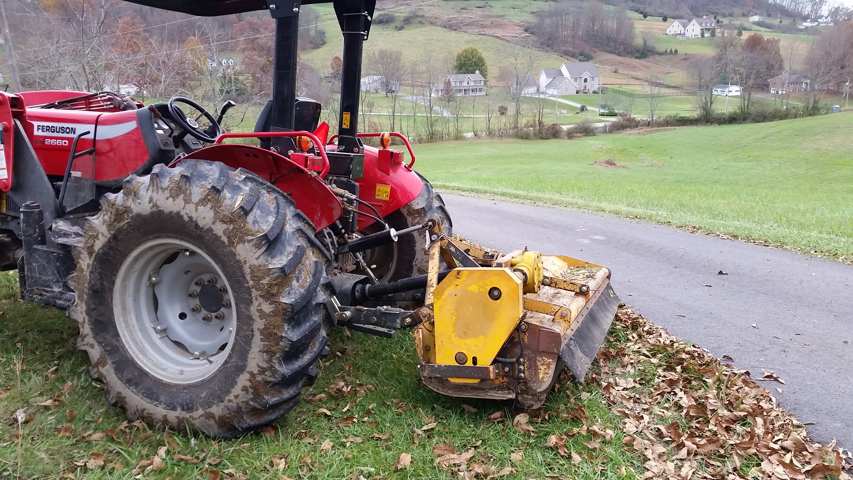

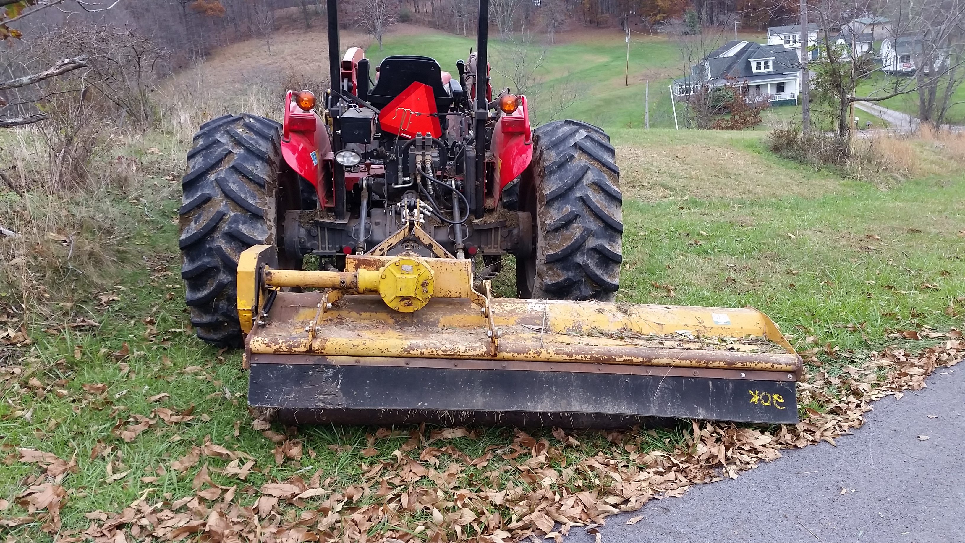

I've been using a beatup old flail mower that I refurbished most of the summer. When you are not cutting heavy brush and just clipping pastures it works great and I think a little faster than a Bush Hog. My flail is an Alamo 7.5 ft found in an auction for almost nothing. Put about $400 into it and is now the most used tool.

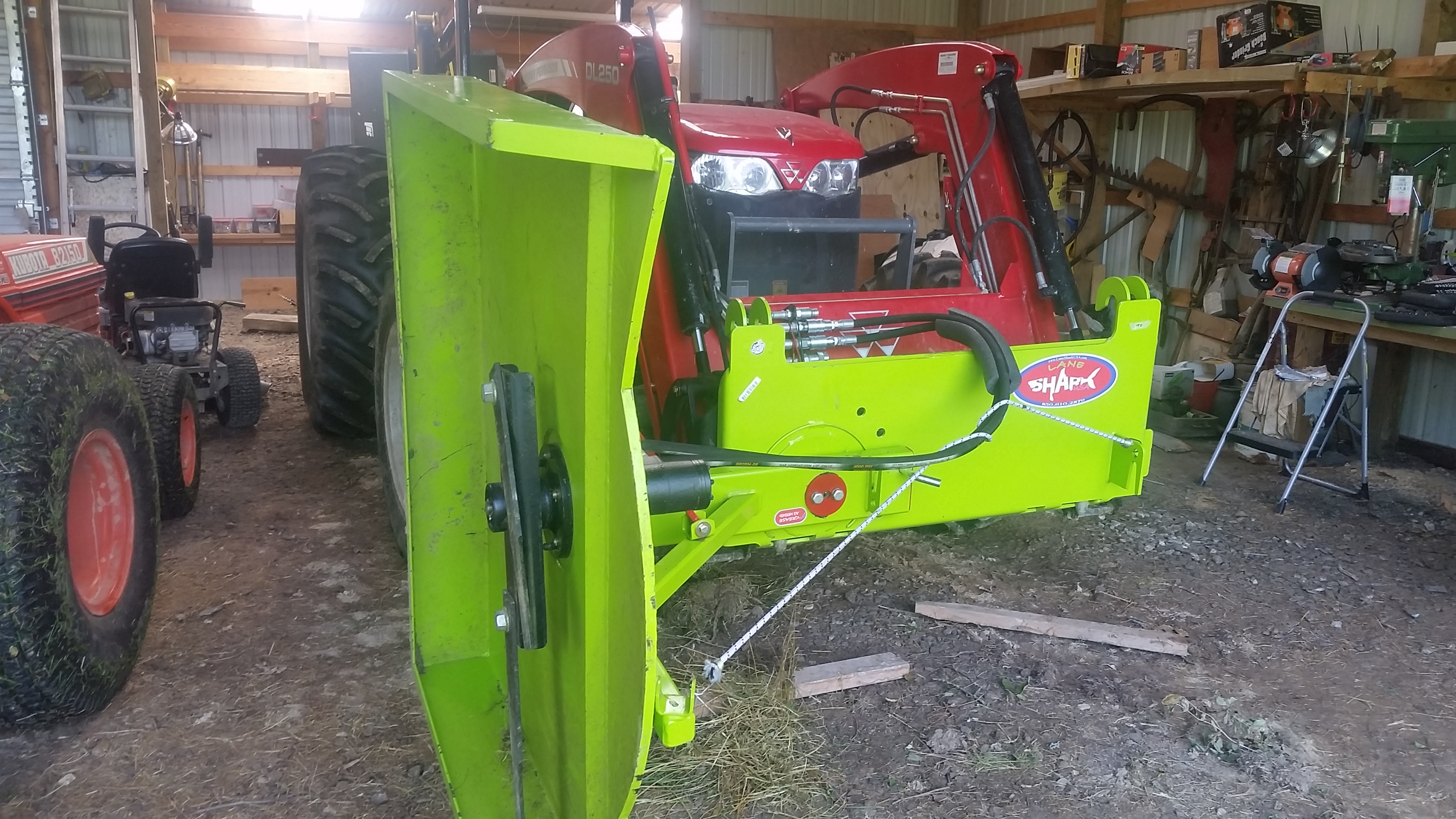

Last trip to the farm I put on the FEL mounted hydraulic cutter (Lane SharK) I use to cut overhanging branches and trim fence rows. I'm running the flail mower on the rear and the Lane Shark up front probably the rest of the summer.

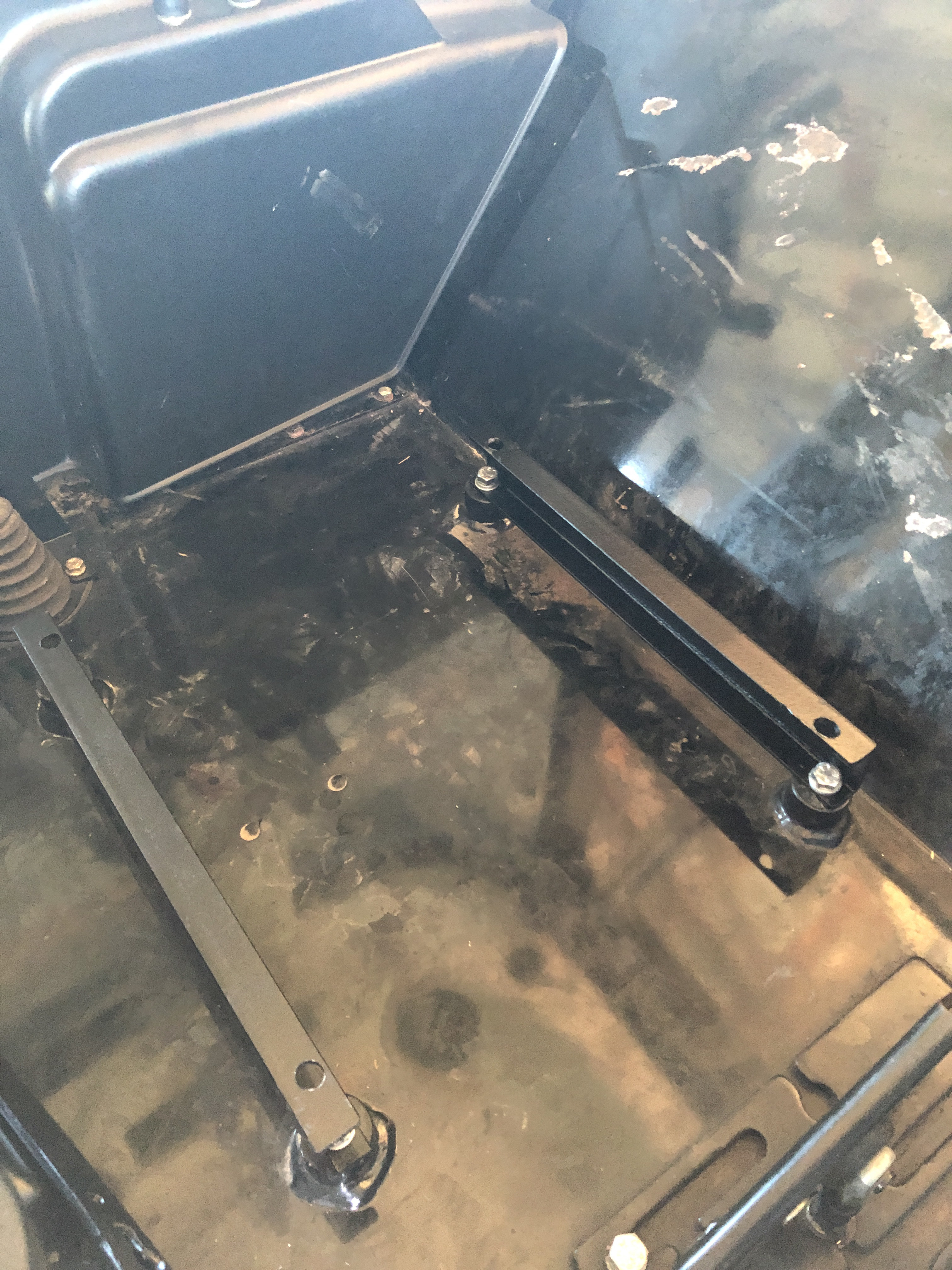

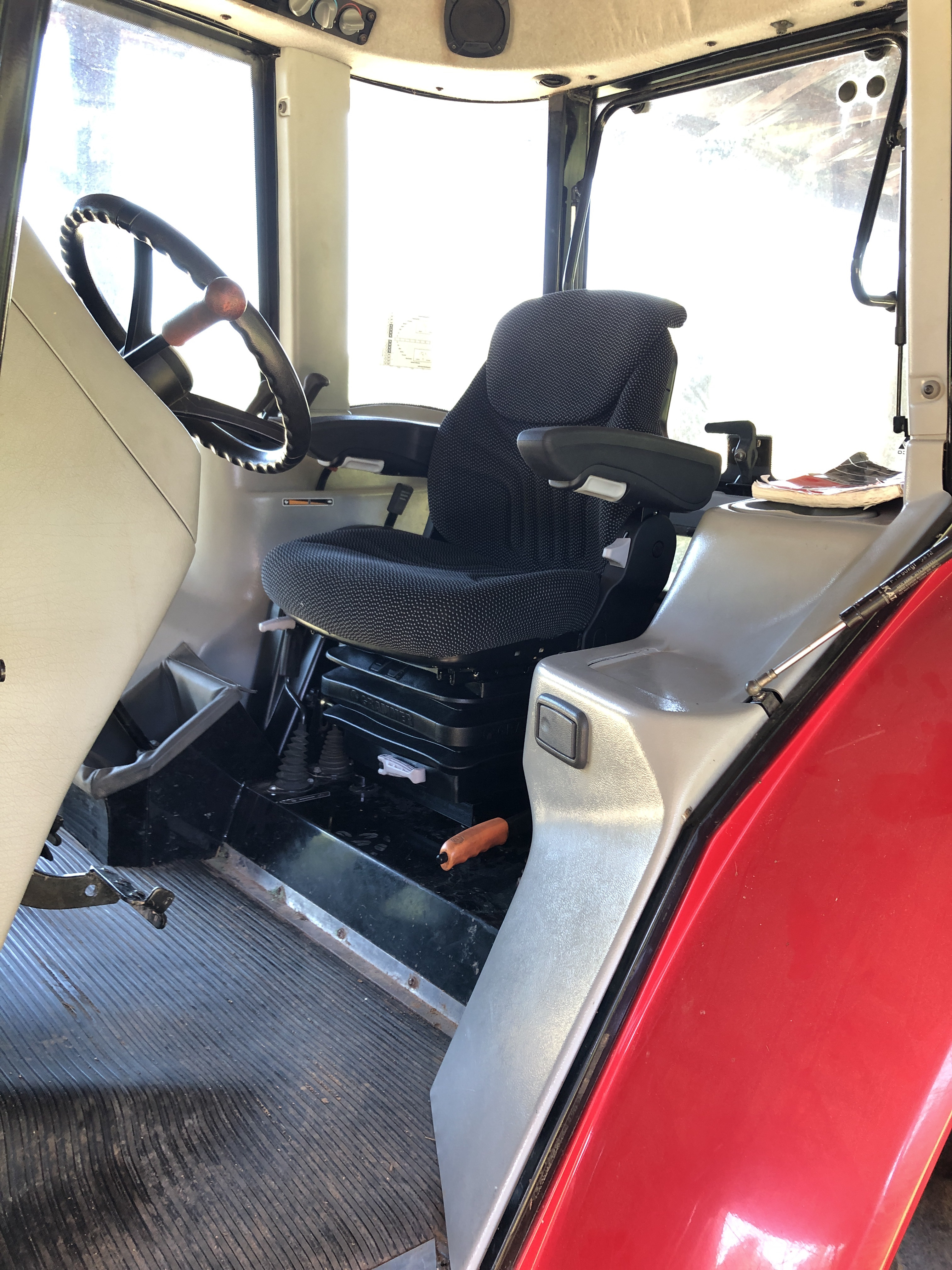

One big improvement I just made though is the seat. I thought something was wrong with it as it seemed to bounce a lot and not very comfortable. So after checking into it and I realized the spring set up underneath the seat was damaged and not operating correctly. Problem is I couldn’t get any parts for it because it’s a model that comes out of Brazil. Plus on top of this I couldn’t change the seat out because the mounting locations were off from what grammar supplies here in NA. So long story short I bought some C channel and then made a adapter bracket which worked perfectly. The new seat is super comfortable and really nice.

Beneficial mod on the seat. Right up town. My seat adjusted well for my fat butt/weight and has been no problem. Sorry those brakes have drug on as an issue. So glad I had mine done when new under warrantee.

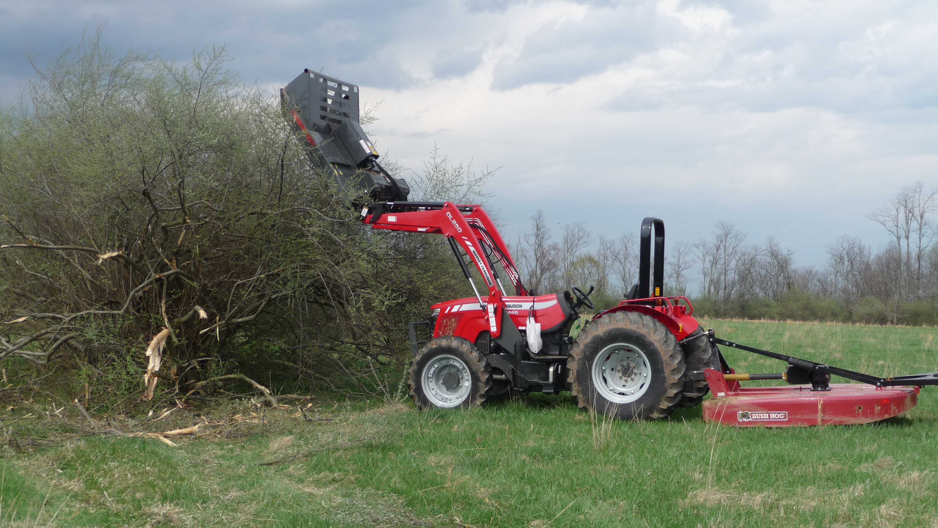

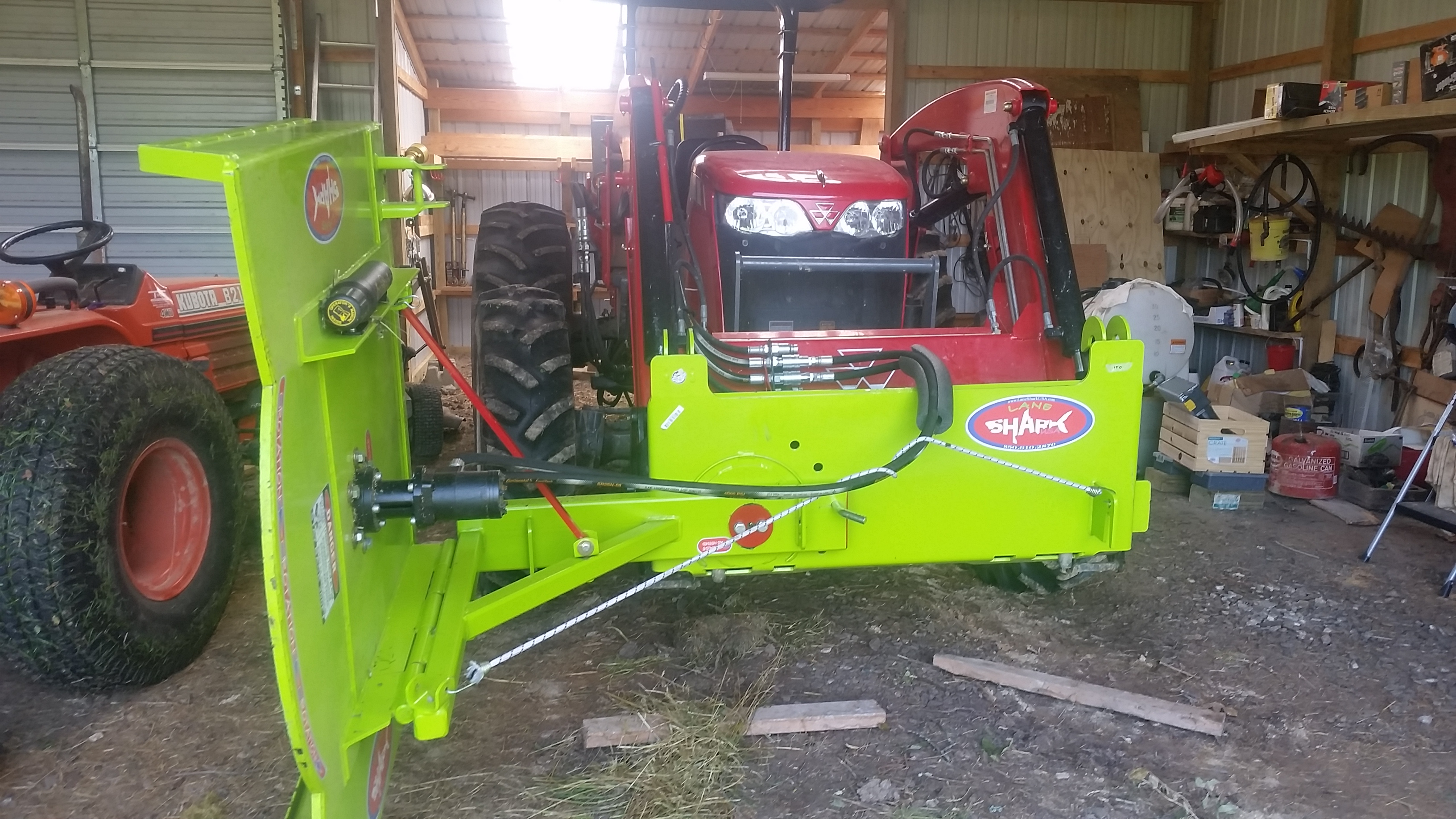

Yes, I was the first one to buy a Lane Shark in the state of WV. Very happy with it. It can get to be a long story so if you get into it let me know and I will add details. The local dealer in WV is a Kubota dealer and I took the tractor to them for installation thank goodness. The return hyd line must go to the sump up under the tractor in hard to access places and the plumbing required is less than obvious. But Lane Shark has that rig figured out really well. I had a much larger one back in 2011 picture below, which was super HD but I lacked hydraulic pump capacity to really run it well. Not robust at all.

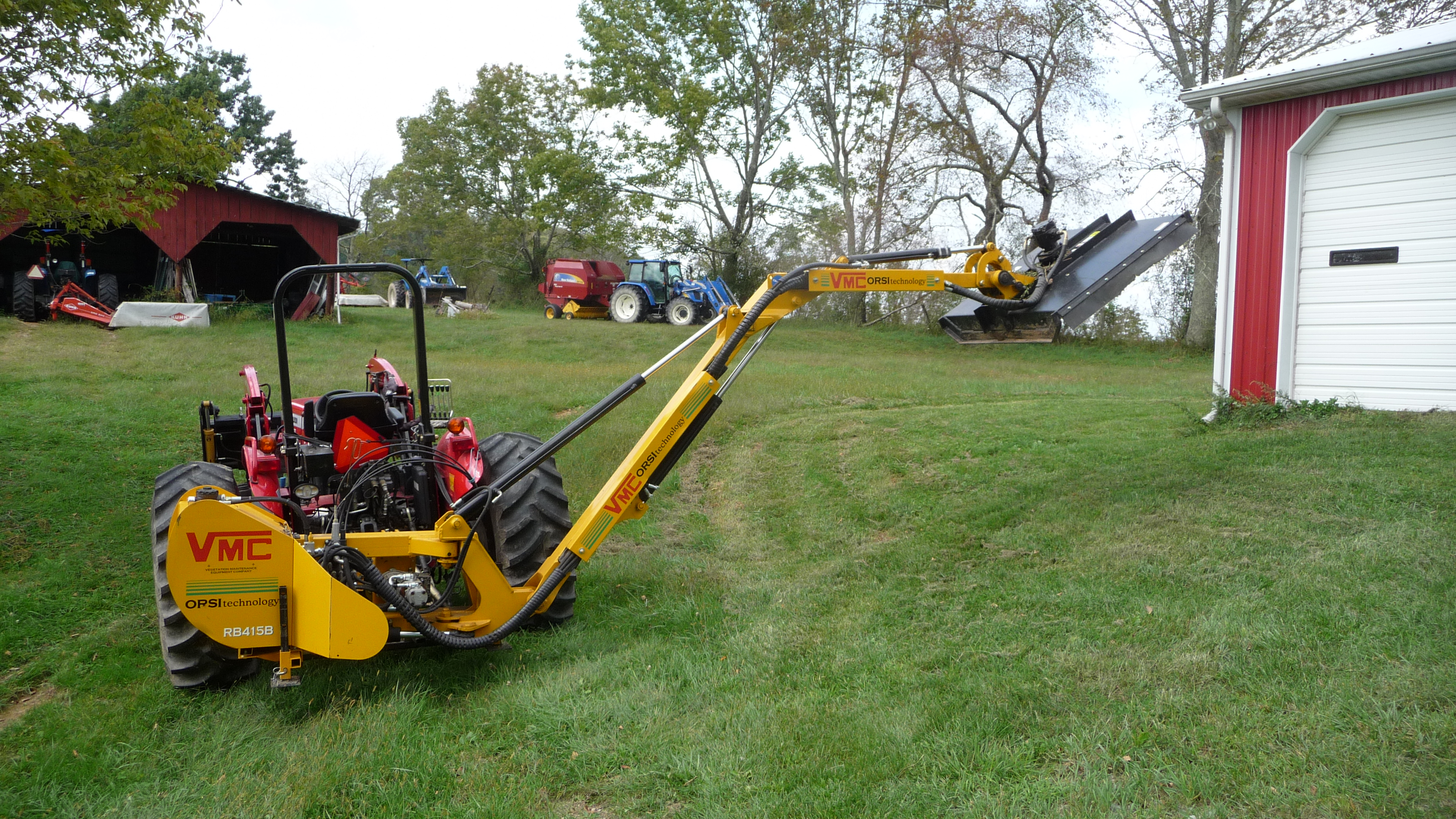

I traded that very heavy front cutter (which was only centered, not to the side and not able to rotate to vertical) in on a an ORSI brand rear mounted articulated boom cutter (went to SC after it) looking like this (which I still have.)
The ORSI is a great machine for serious cutting in oddball places including overhanging limbs, brush over sink holes where the tractor cannot go, etc. It is a beast in that it has two of it's own pumps to drive the cutter and the movement of the arm/cutter separately. Reaches out 17 ft. Four ft hog on the end. Will cut almost anything. Weighs around 2700lbs. The problem with that is it is mutually exclusive with any other rear mount tools like my 7ft hog or my flail mower. And it takes 2-3 hrs of work to mount it (at my dear old age of 77,,, challenging.) I can do it but it is all I can do.

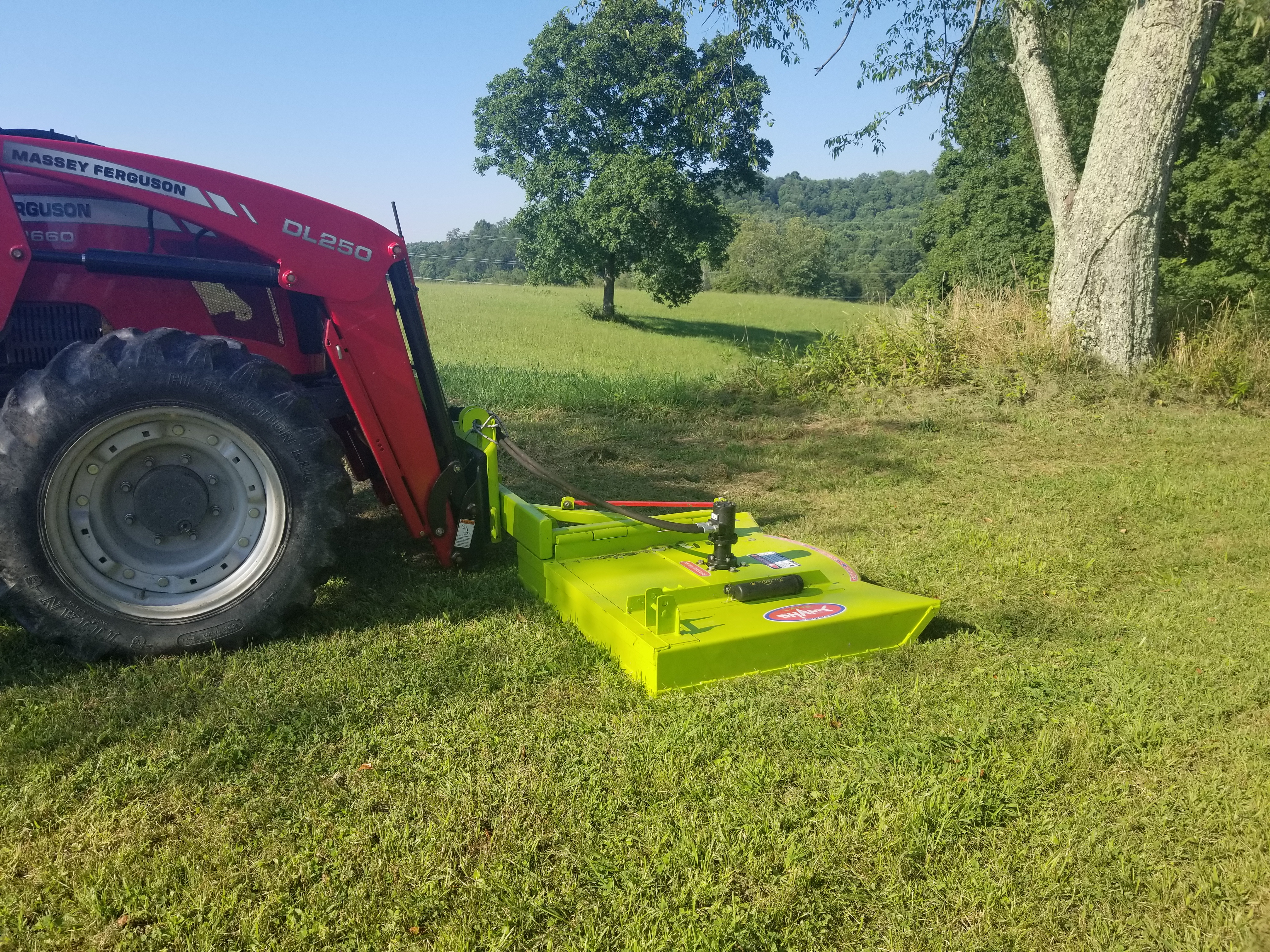

Then along came Lane Shark. There is a nice video on them on YouTube. I've had a fair amount of dialog with the young guy founder of the company [Travis Odom] down in Fla. Mine was an early model and he sent me complete replacements for the blade carrier, blades and bearings which are now very good. I used it a lot early this month. Very easy to put on & remove [fits the quick mount skid steer loader interface.] Also not hard to reconfigure into vertical horizontal or angled positions. The hyd motor is just right for my internal tractor pump to drive OK. I did run bigger lines and new connectors up to the loader instead of trying to use the third function bucket stuff. There is a knock-off called TB-One made by Titan. They literally bought a Lane Shark and japanese copied it adding a couple of minor features and put it on the market about a year after the Lane Shark came out. The design is very innovative but apparently Travis and those guys had insufficient patents. Longer term I'll keep the Lane Shark and sell the Orsi.

I can't claim enough hours yet to be sure of durability. Two seasons and I've had it on and off too. The old blade carrier and blades were bad about coming off and having to be tightened every couple of hours. The new ones are solid and cannot come off so that is a major improvement. I think it is durable and well made. It is not the killer machine that my bigger Orsi is with the rear mount PTO driven pumps but the Lane Shark is extremely handy for pruning off overhanging limbs, up close to fence rows, etc. The 2660 internal hyd pump drives it very well. I think Lane Shark realized they had found a niche market there smaller than the big heavy cutters usually driven by large 20gpm+ pumps on skid steers AND readily driven by smaller tractors, actually smaller than ours. Just was nothing in that market before them. The design features are pretty darn near genius level and being purposely made to avoid having to drive it with a PTO pump opens up a heck of lot more customers. Other things that were "not right" when I tried one of the big FEL mounted cutters was they lacked provision for "what happens when you stop the drive." There was all kinds of screeching and sudden jerking and certain to tear up stuff. Travis & those Shark guys put in a bypass of some sort that does 2 things -- it allows the blades to spin down comfortably when you shut it off and when you use loader controls to raise or lower or tilt the loader frame. With the Shark you barely notice that flow only goes ONE place (either the Shark motor or the loader movement) at a time. It is smooth where using the big skid steer cutter it was jerk, crash and squeal in between every movement plus our 2660 does not have enough hyd pump flow for that stuff. Actually being a cab model yours may have little bigger pump than mine. Anyway, I do not think you will be disappointed.
The first two or three times you change configuration with it from centered to off to the side, etc. you will have to use the manual step by step. Anyway I did. Pretty amazing mechanical thing. Changing angle from horiz to vertical and in between is easy and obvious. There is talk about adding an hyd cylinder to control the angle but to my knowledge neither Travis nor Titan have that offered so far. He told me they were considering it.
