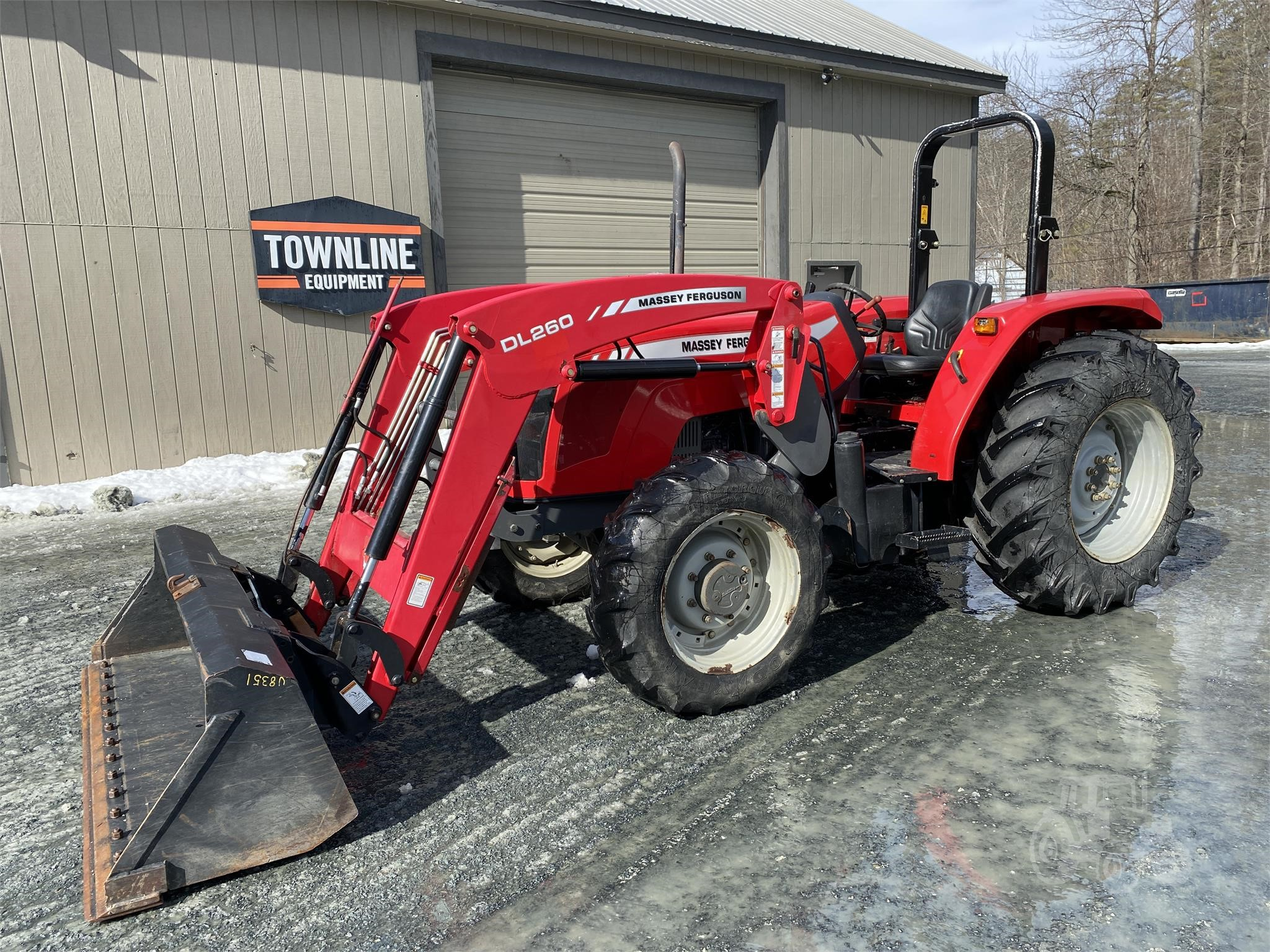

I found a rops version with DL260 and 1400 hours locally for 25k. Front tires are worn down leading me to believe it's seen a life of heavy loader use

Could just be just a lot of pavement wear also if he was hitting the roads with it. That wears tires fast.

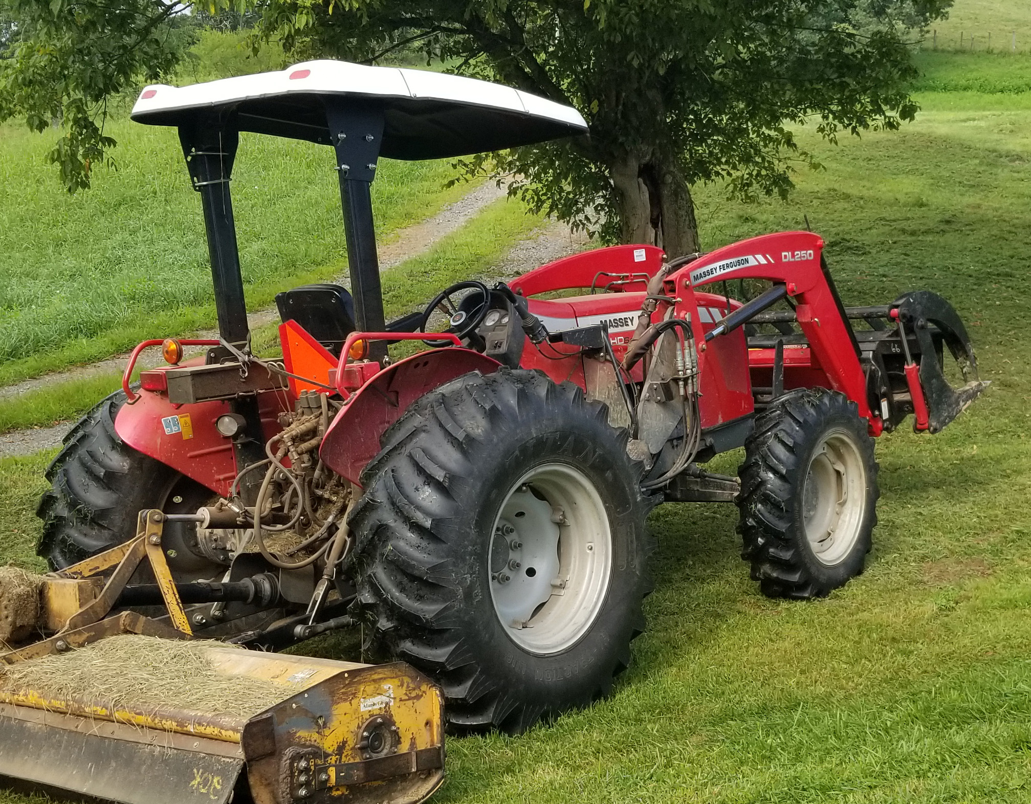

   / Massey 2660HD rear brake issue #68
That looks almost exactly like mine. I have a MF 2660HD low profile. That one in Maine at first appears to be a low-profile too (having the single step to get up on it) but the rear fenders do not look the same as mine. If it has 30" rear tires it is not a low profile.
This is a grungy picture below cropped to show my tires a bit. This is last summer when it had 450 some hrs on it. The one in Maine's tires don't look bad to me for having 1400 hrs on it. That's 950hrs more than mine at the time of this picture ! Heck, I think mine will be bald by the time i get to 1400hrs ! I spend a fair % of time on steep ground spinning and fighting hills, ruts and brush however. Very little on pavement.
Just noticed: the one you consider buying has a DL260 loader which is a good thing. I've gotten huge use out of my DL250 but have also bent the loader frame doing stupid things with tree stumps (and unbent it the reverse of how I bent it...) I have always wished I had gotten the DL260 which has a little more frame strength and slightly more umph as well.
