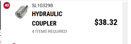

yeah I bet ball seat area is damaged and misshapen ball(s) causing non-lock.
I had missed where you said you cycled control lever.
if line on loader side for that fits another socket fine then I'd not mess around and would just replace.
per agco parts should be a SL103298 female connector. can't remember where I bought my fittings from when building hydro relief valve test hose but they sold sl style and were good prices.
15$ on ebay
   / Massey Ferguson 1533 built 2005 - Loader hydraulic coupler troubles
#19
Thank you Dave (@Dmacieo). My dealer only had one in stock and the other is being shipped to my home - its a spare. We'll see what we find.
If the connector has failed, it'll be replaced and hopefully all will be fixed. I just wish I were onsite to get this done this week!
I just might get a couple more and replace them all at $15 each.. Thanks for the ebay link.
