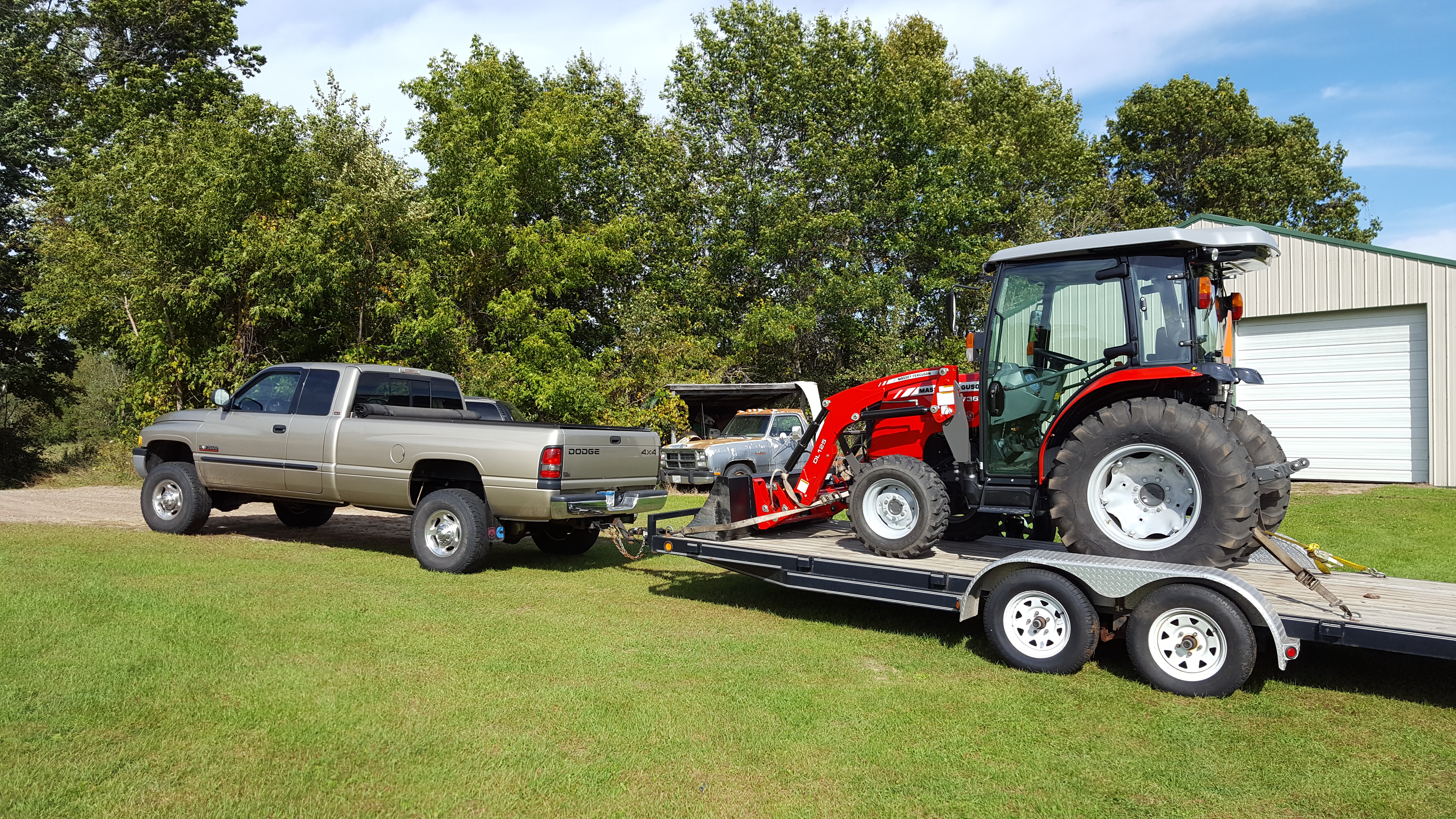

Loaded up and delivered back to the dealer today to have the tires filled, fuel gauge addressed, 50 hour service, and I bought a set of forks (new) for $650.

   / Massey Ferguson 1736 General Thread #15
That's a nice setup you have for transporting your tractor!
#16
Thanks, It works well. It's an 18+2 PJ Trailer and I've had it about 10 years now. I also had a 32 foot goose neck but I didn't use it enough, so I sold it. This trailer is long enough that I can get the tractor and a couple of implements on there with it and the ATV as well for planting food plots at the cabin.
When loading on this trailer with its 2 foot beaver tail, I don't even need to use the ramps, the tractor just climbs right up. My bobcat did as well. I really only use the ramps when loading cars.
