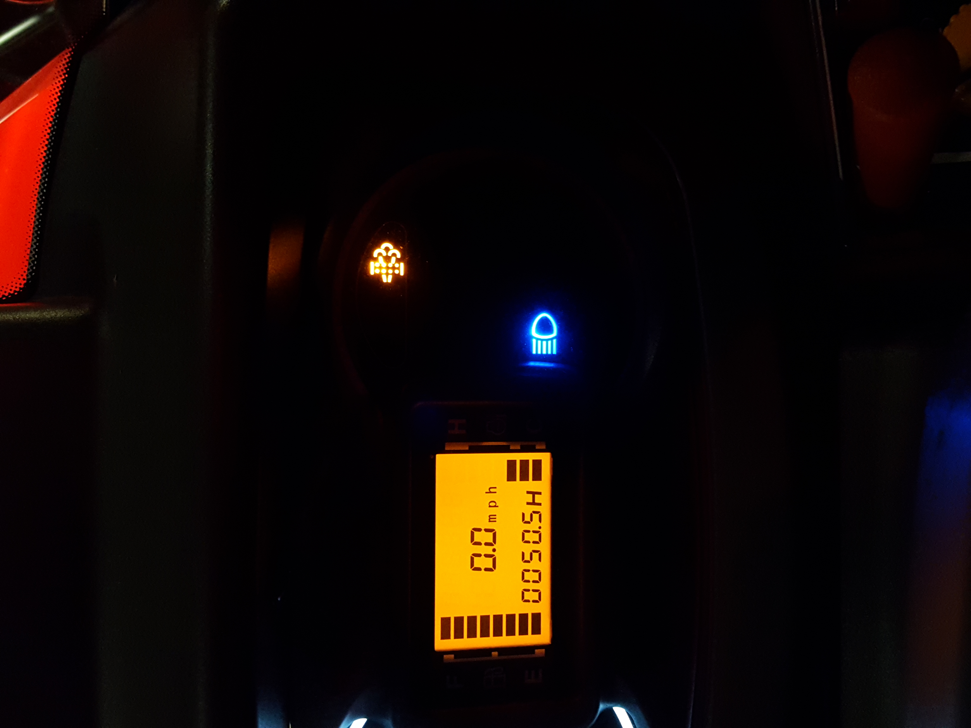

As I was out discing last night it got pretty dark so I decided to go in. I un-pinned and dropped the disc off and headed in. As I make a turn (must have been into the wind or something) I see a plume of smoke come up passed my windshield and right side cab window. I was confused for a bit as this machine has NEVER belched out any smoke before. I thought maybe it was just fog coming off of the swamp I just went passed, but still wasn't sure. Maybe at 50 hours the computer released a more aggressive fuel table after the break-in and I was at 50.5 hours?
As I looked around, I saw that the regen light was lit up on the dash! I was in regen mode at 50.5 hours. Not sure how long it had been in regen mode as I hadn't noticed anything until after I dropped the disc. I did raise the manual throttle to full rpm just to assist it and it took about 7-10 more minutes for it to complete. I really didn't notice any real power loss when it was happening, but then again I wasn't really asking it for near full or full power either.

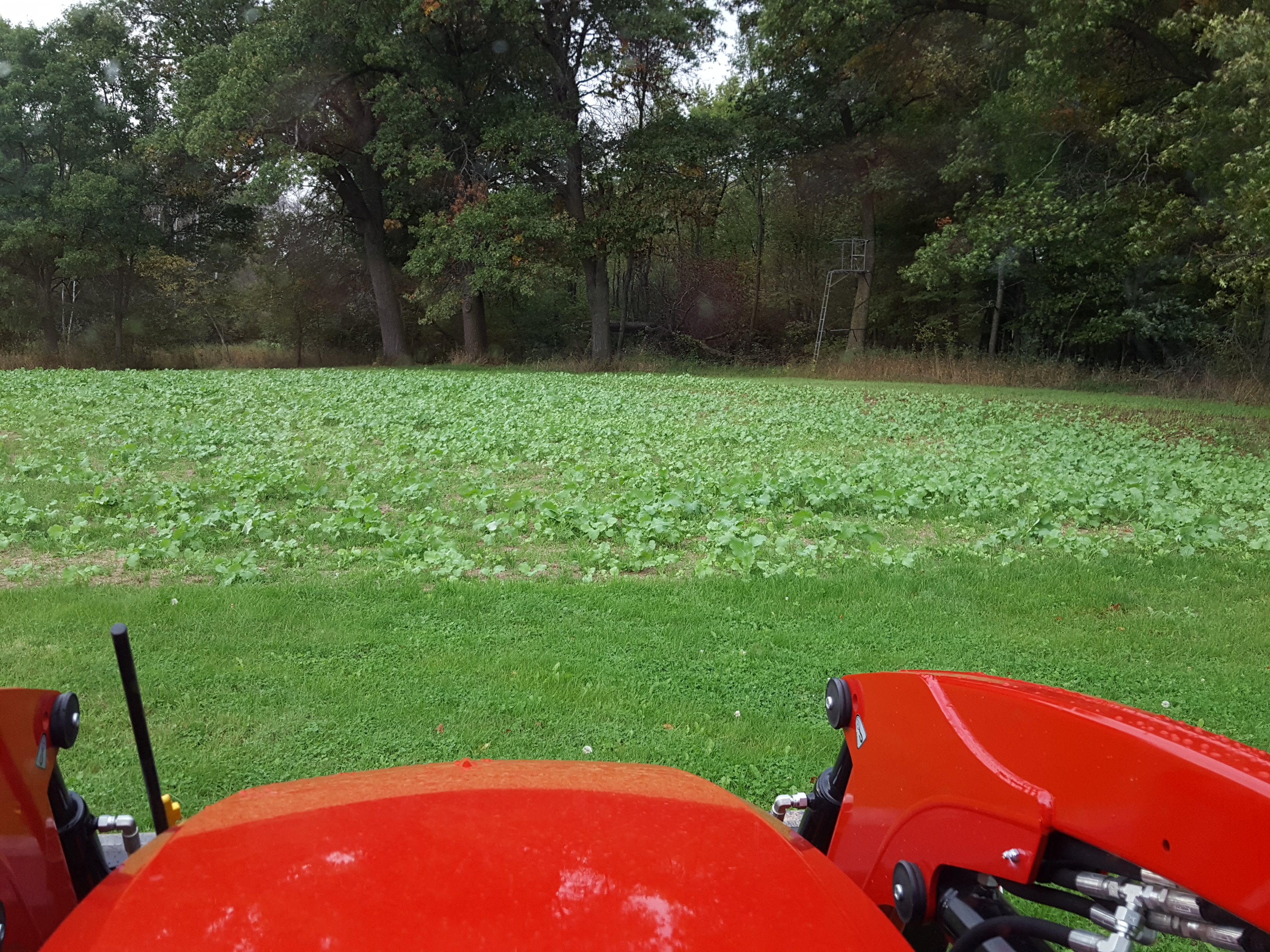

Got some more cab time this weekend working up more food plots for the deer. It's predicted to be an above normal winter on the nasty scale here in the Midwest so I figure the more I can do to help the herd out the better.
I put about 6.5 to 7 hours on the tractor and the fuel gauge read full until about the last 1.5 hours when it fell sharply and ended up at 1 bar just before I knocked off for the weekend. This would tell me that there still is something up with the gauge that still needs to be addressed.
Other than the gauge everything went well, I pulled an old single gang disc (looks like it was originally horse drawn) and I added afresh rail road tie to the top of it for extra weight and it cut well. I then pulled the rail road tie around the plot to level it a bit as the single gang let it a bit uneven. In between rain storms I was able to get my 5 foot Brillion drill hooked up and drill in some common rye to the new plot.
Shouldn't be but a few days and we'll see this one green up. I went around and checked on some other plots I planted awhile back and with the amount of rain we've gotten, they look good.
