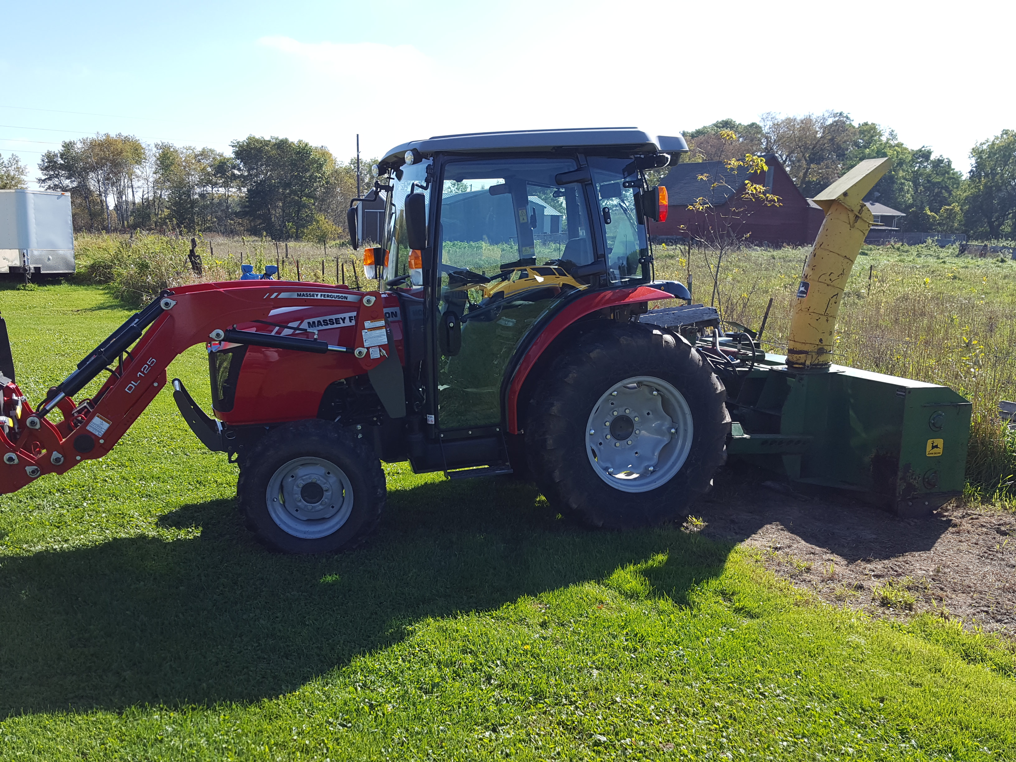

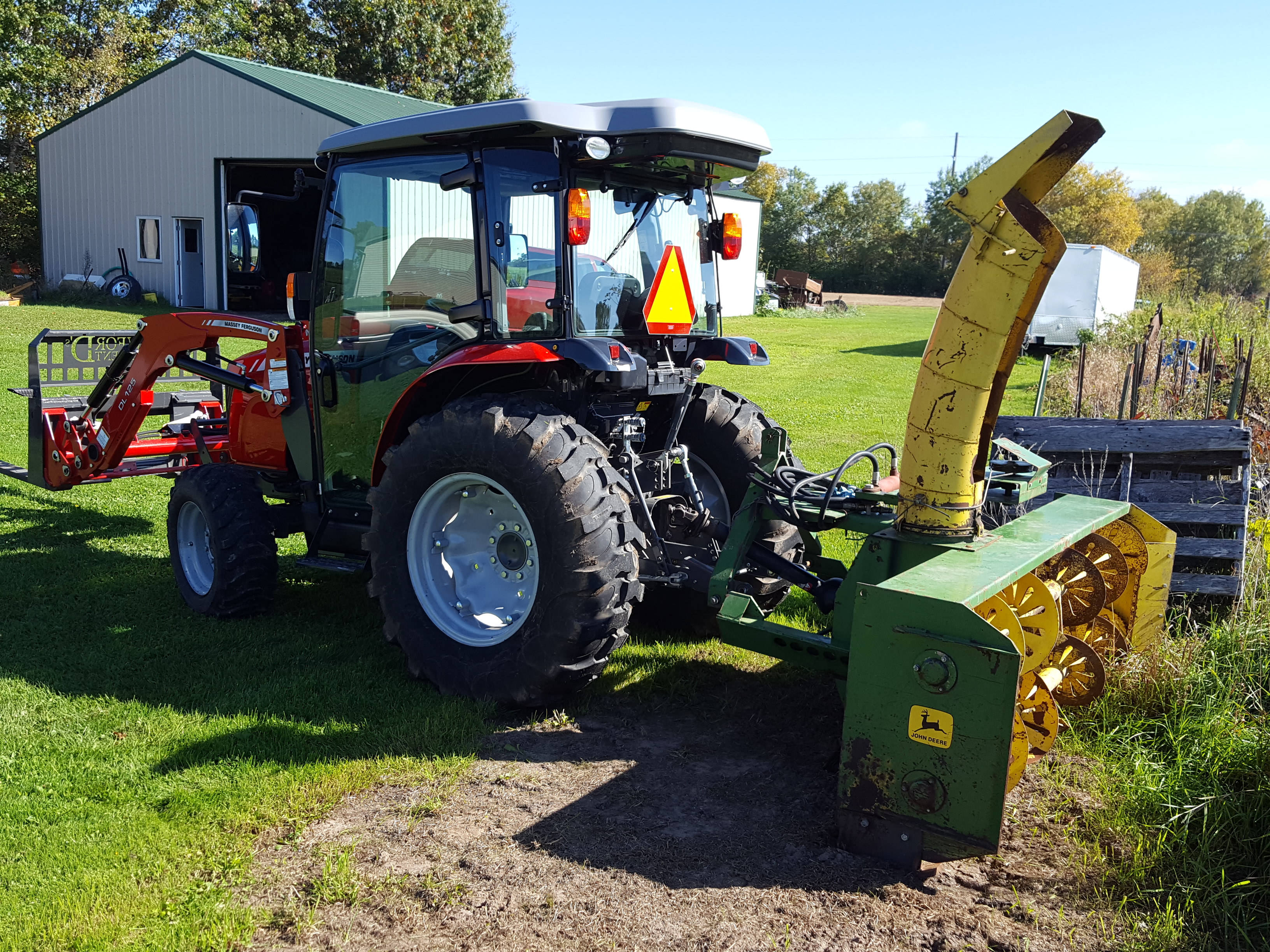

#39
Fitted up my new to me snow blower. It's a 7 foot Deere (Made b McKee in Canada) and appears to be a pretty good unit. Also dug out my old 3 point log splitter and tried it out and it worked well. I'll be splitting some wood with it this weekend.
LM
   / Massey Ferguson 1736 General Thread #40
View attachment 483139View attachment 483140View attachment 483141
LM
Wow that blower looks BIG! What is the minimum Hp needed to run it?
Every neighbor is now going to be asking you to clear their driveway this winter, you better keep that hidden and only use it at night. LOL
