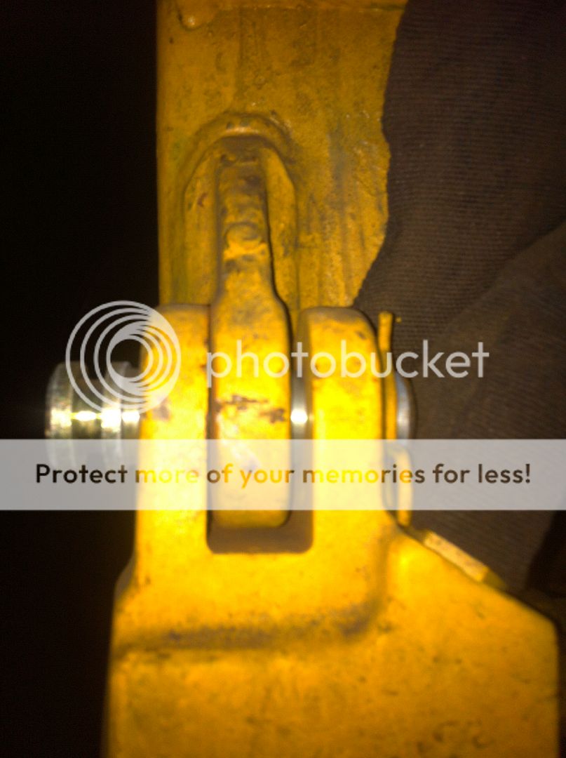

Forgot to mention last week I also made new pins for the front top cylinders. They had a bit of play in the old ones. Big improvement in them now. I used cat 2 pins, drilled out a hole and cut the excess off.
