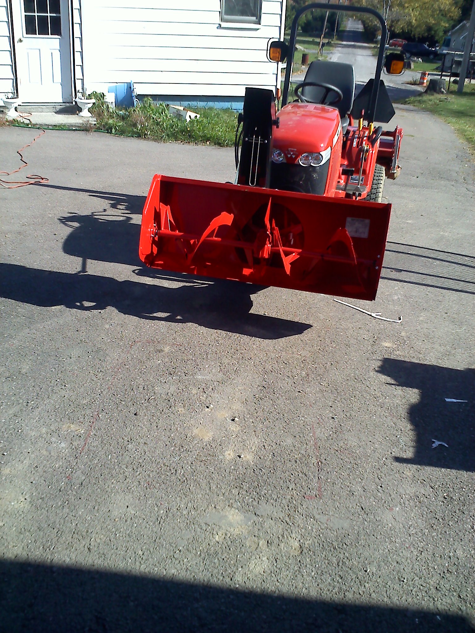

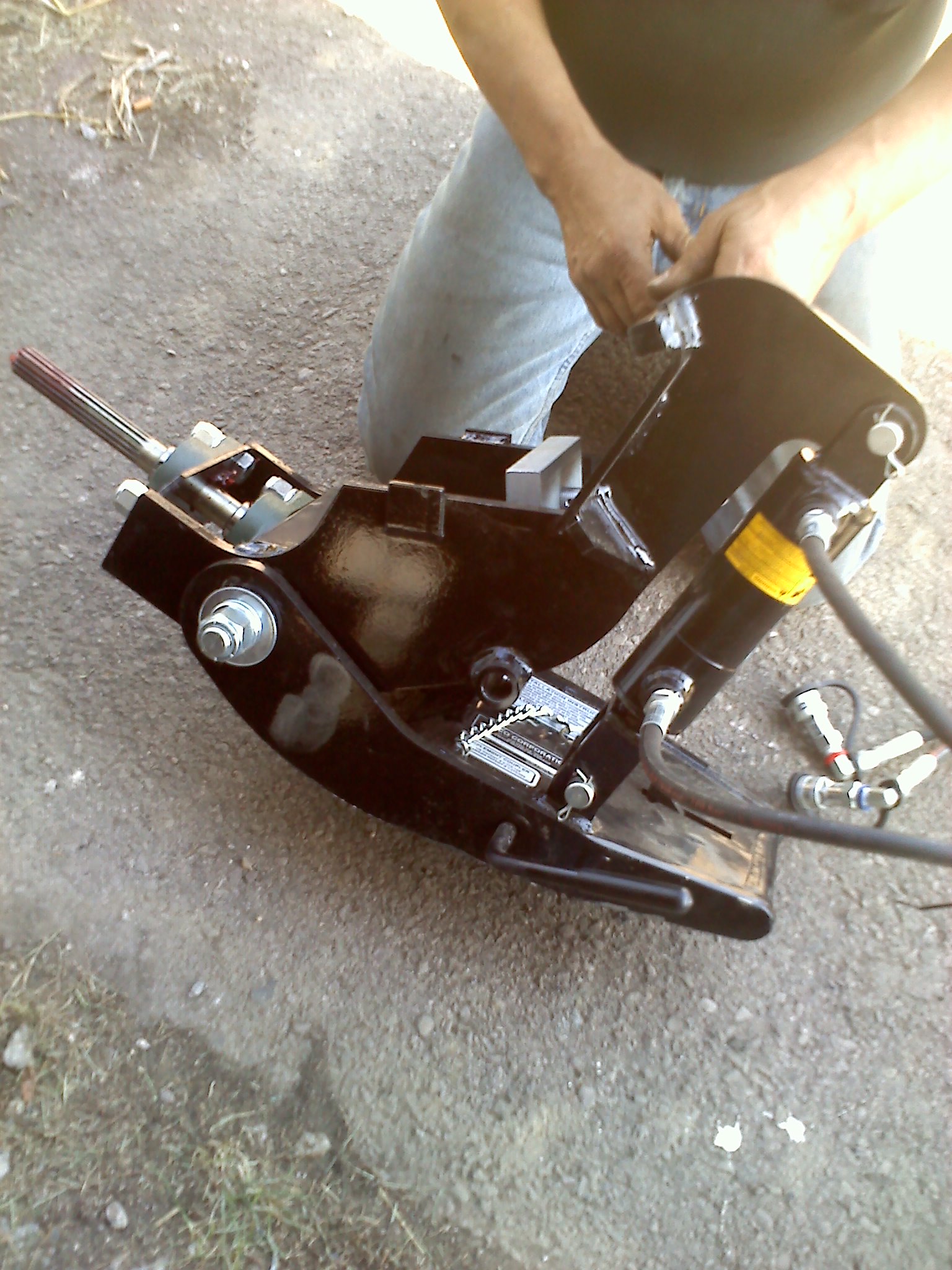

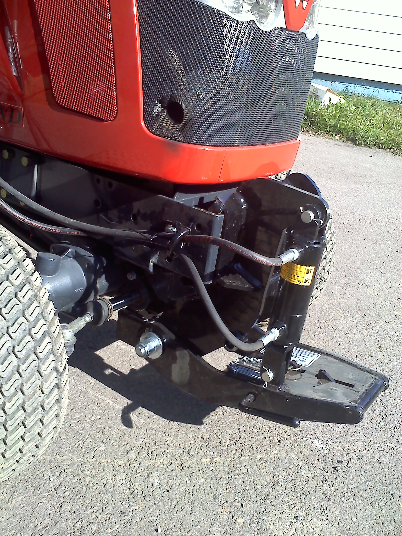

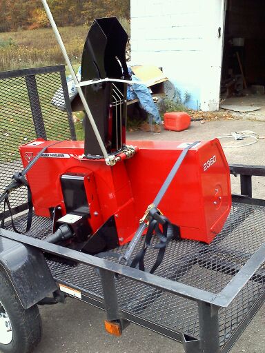

I know this is an old thread but I just realized I never reported back as I said I would.
I have been using my old Kubota front attach blower from my BX1800 on my new massey GC2410 front quick hitch all season with no issues. They are 100% interchangeable.
All I had to do was fab up a mount for the chute rotation handle.
Cheers.

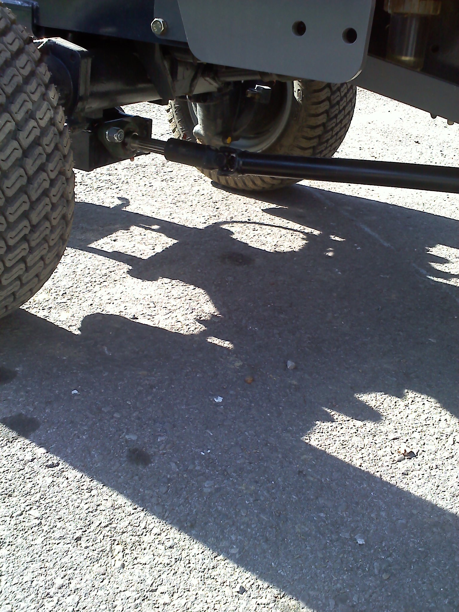

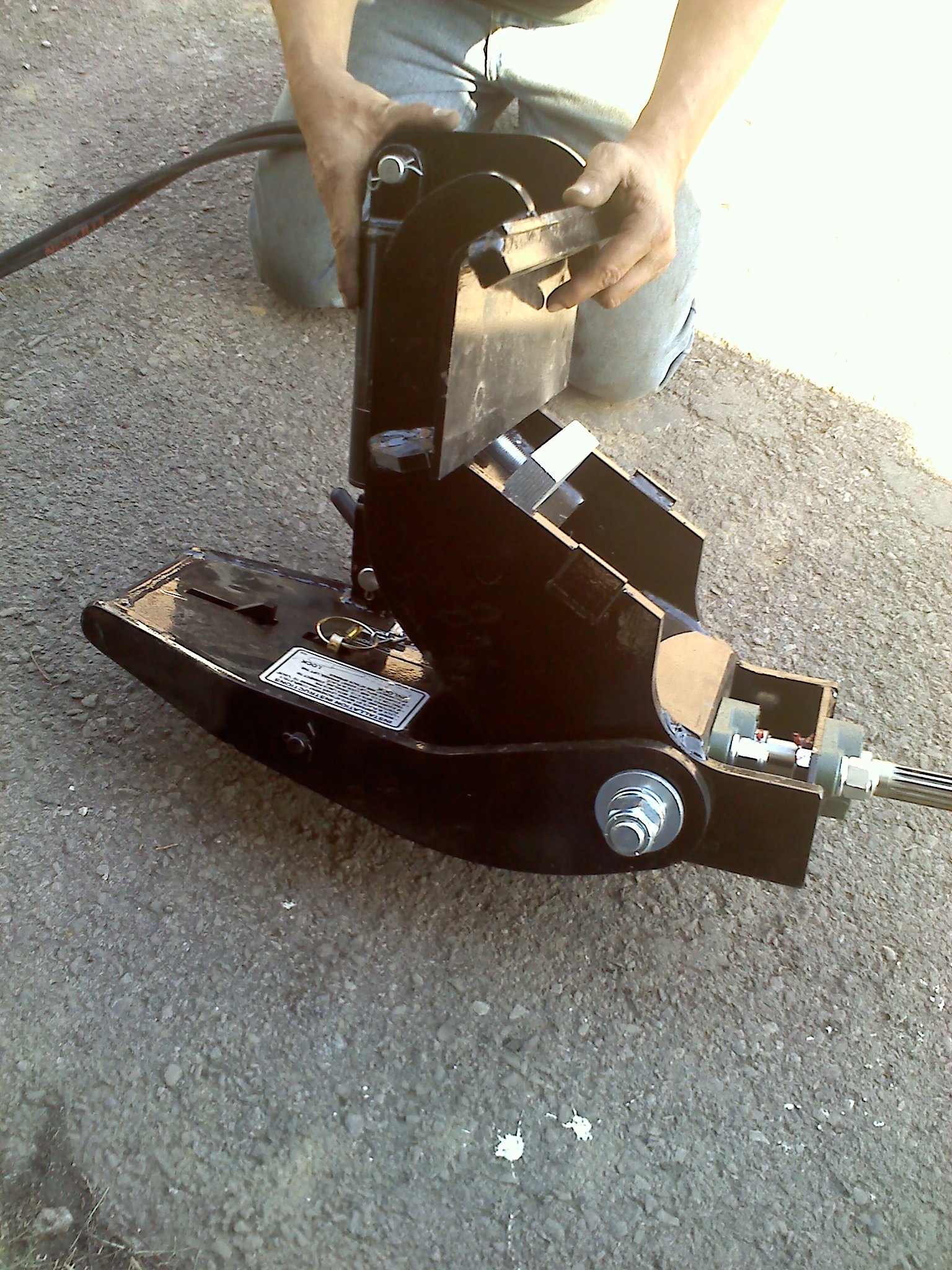

The Quick hitch was the new massey unit. It attaches to the tractor differnetly than my Kubota hitch and the hydrolic hoses are longer but my kubota was very old. Even the newer kubota hitches attach diferently than mine did and may be similar to the new massey but ive never seen one up close.
The PTO shaft from the blower to the hitch is the same and so is the intermediate shaft from belly PTO to the hitch is the same length.

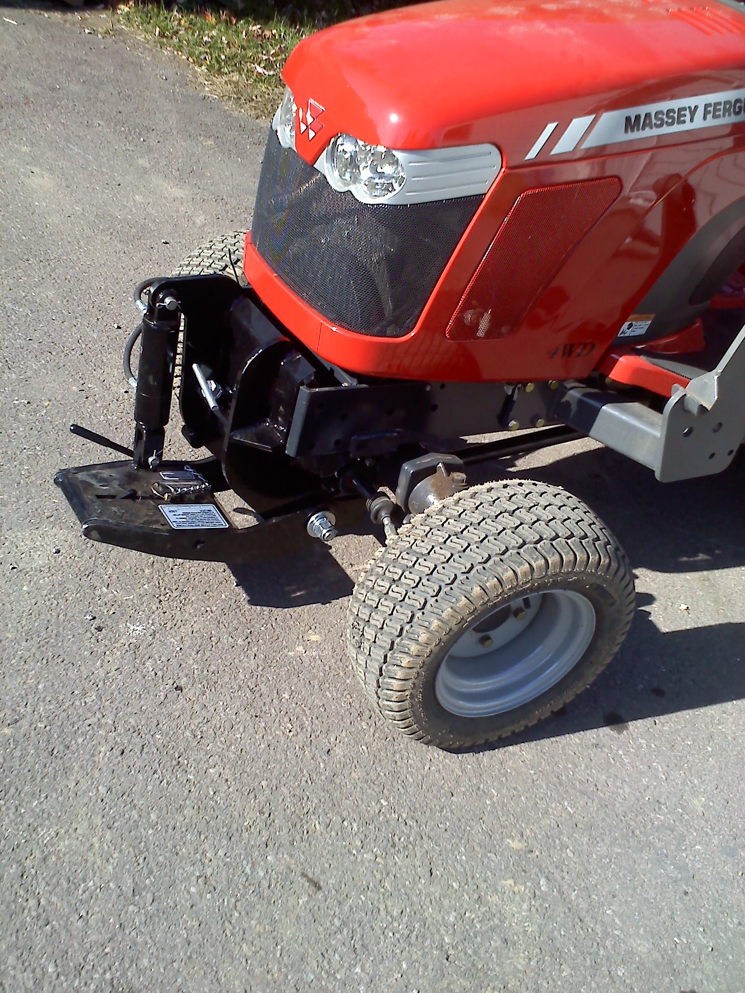

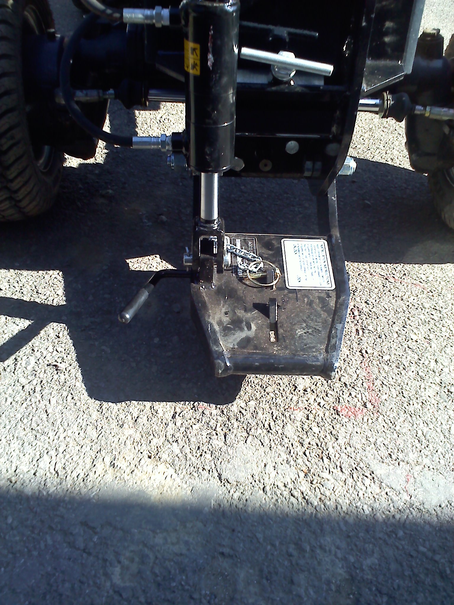

I wouldn't be offended if you posted a few pics of the blower on the tractor.
   / Massey GC & Kubota BX Front Quick Hitch Compatable? #19
Yep. Looks just like the 2300-series quick-hitch. It "hangs" on the front frame cross-member.

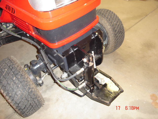

   / Massey GC & Kubota BX Front Quick Hitch Compatable? #20
Thanks. If my neighbor has any doubts that they interchange, I'll be able to direct him to this thread. I guess we can all bet the RAD blowers off the New Hollands will interchange easily as well.
