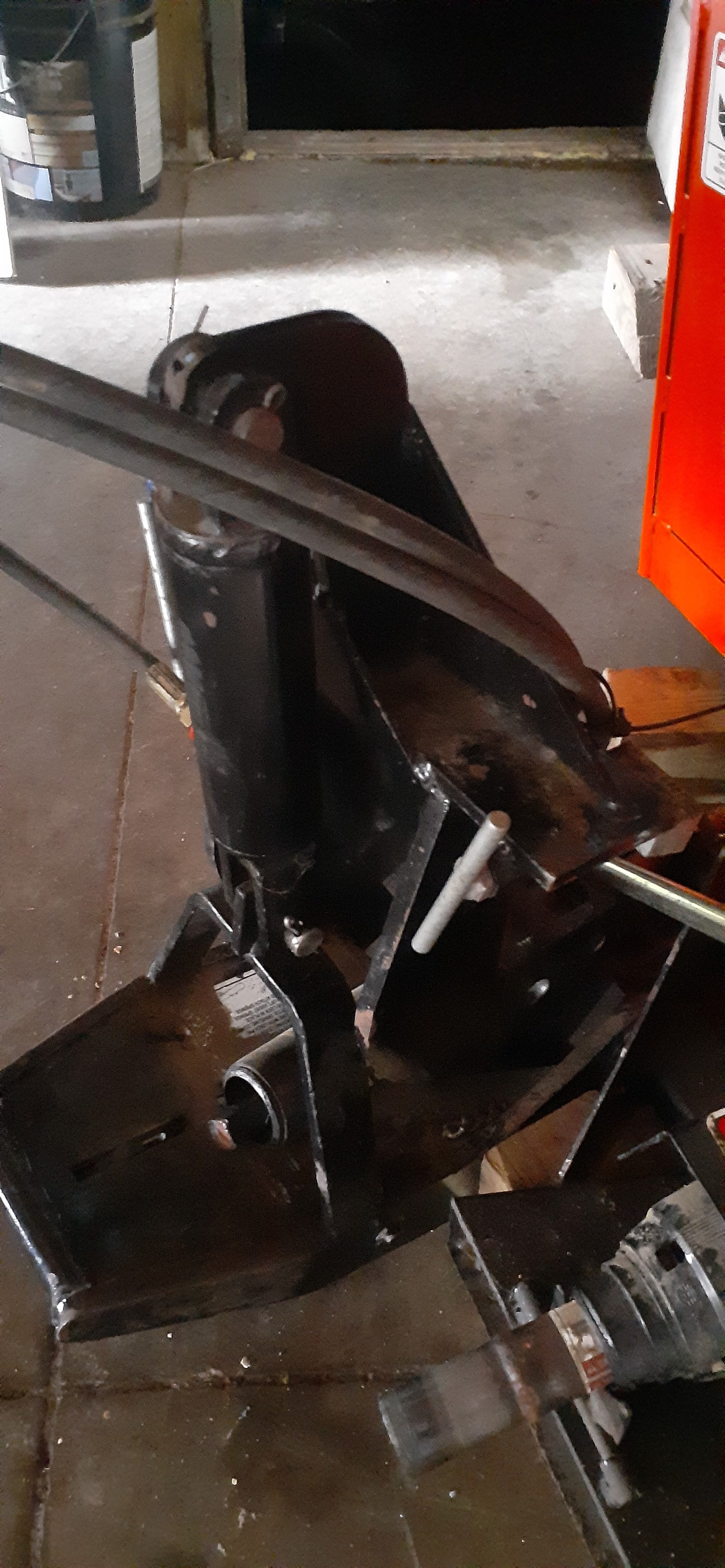

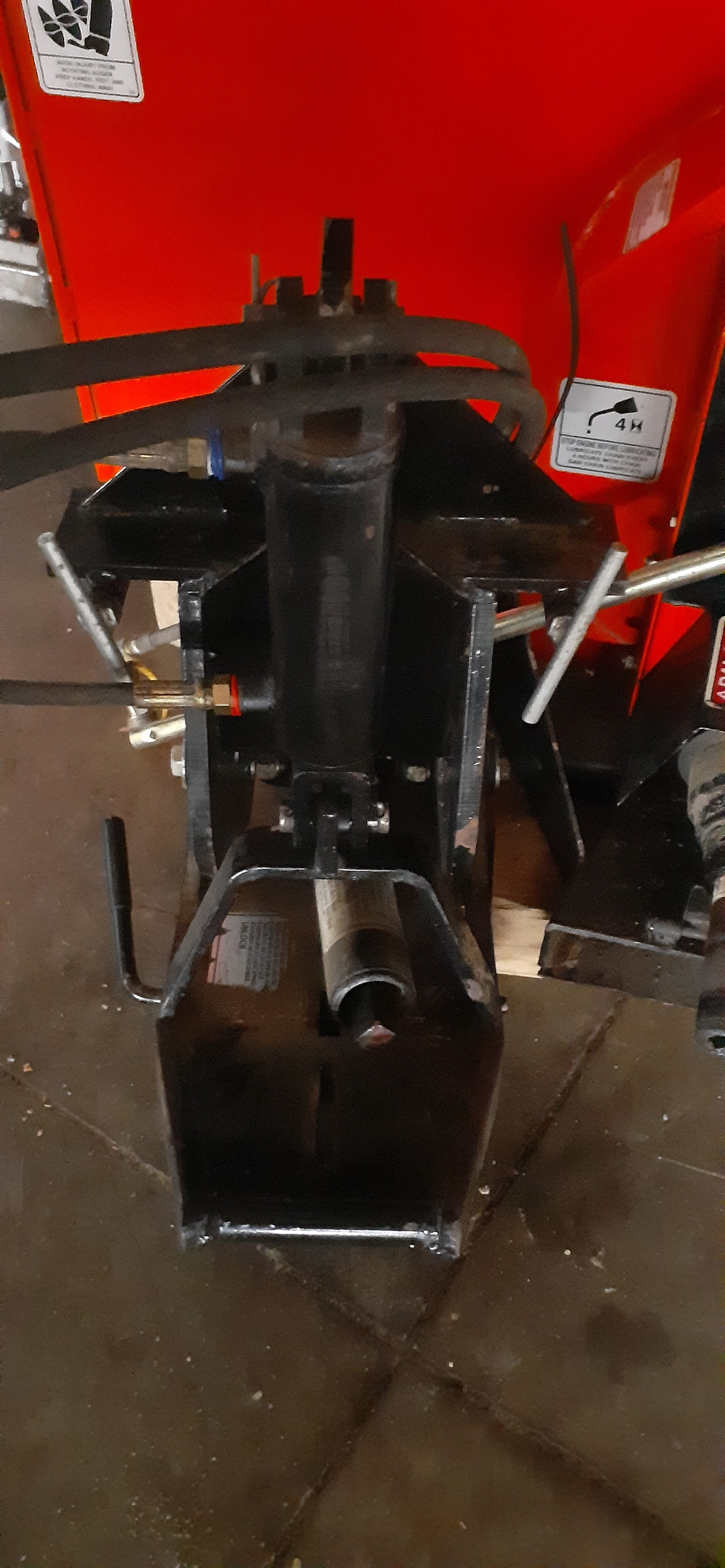

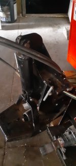

This is the Kub hitch showing the bridge and center mount.
This is the Massey hitch. Notice the placement of the cylinder mount.

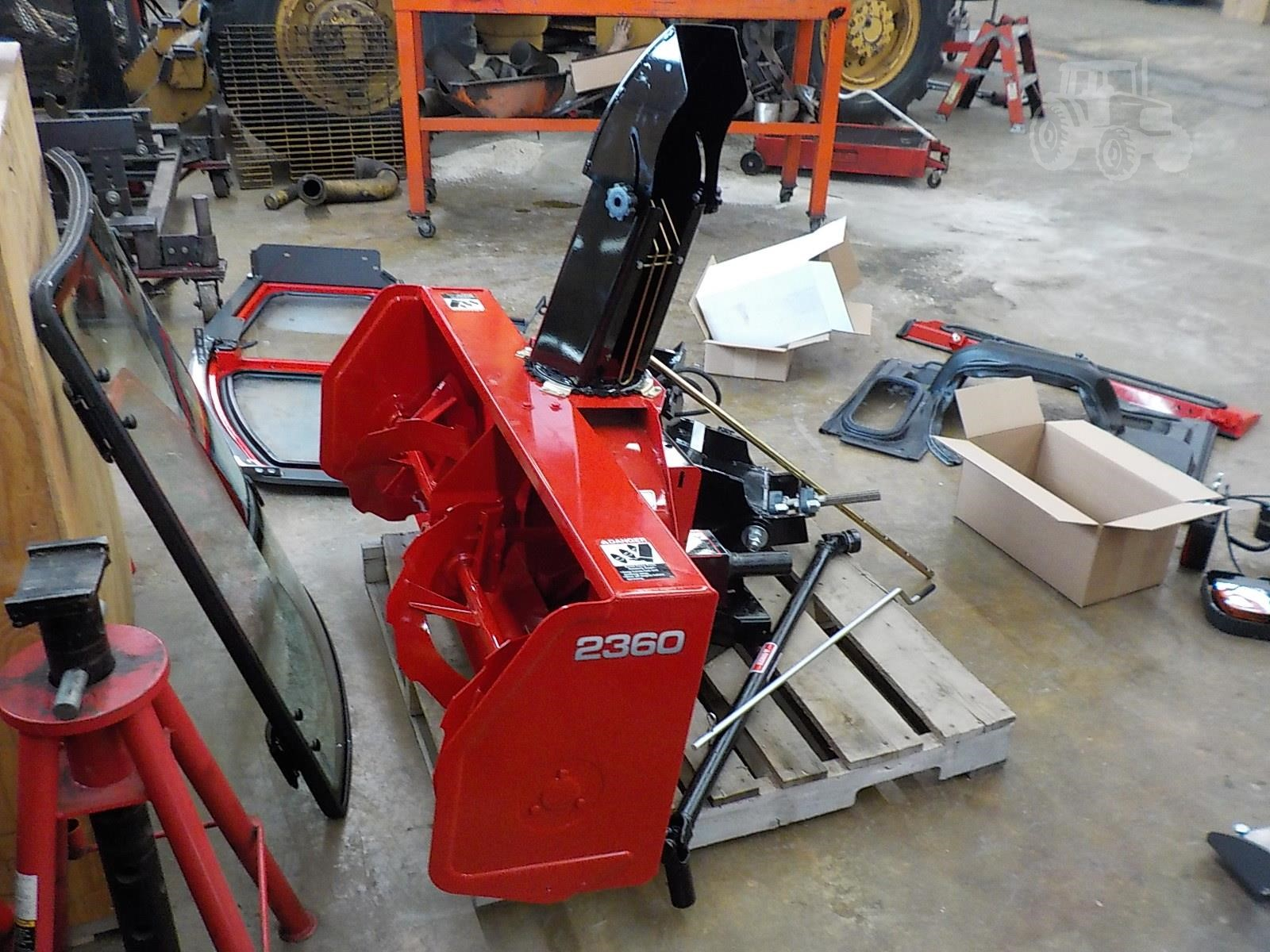

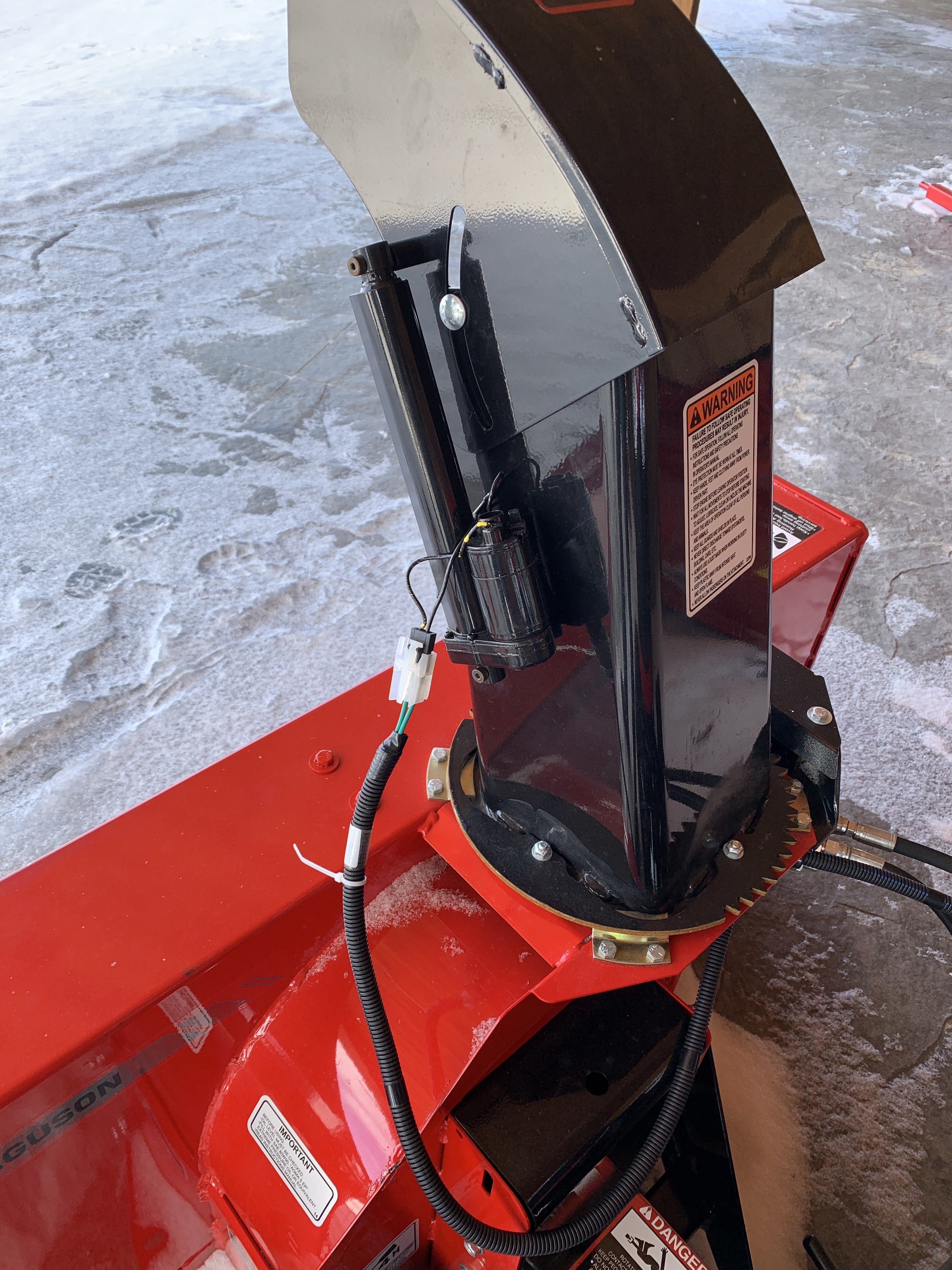

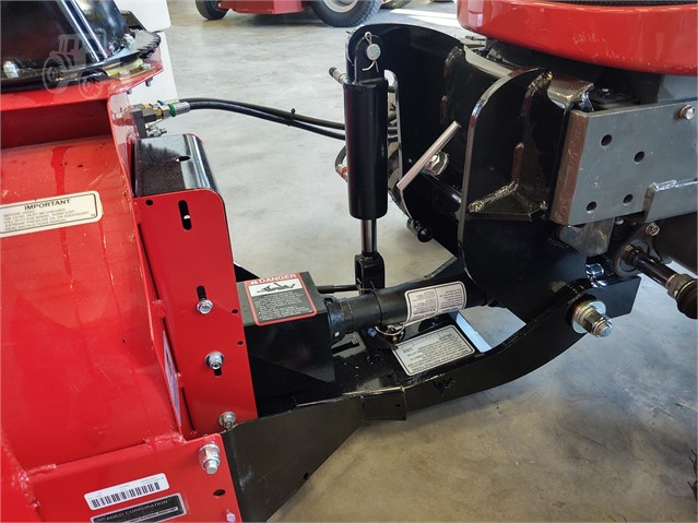

this thread caught my eye today. I have a 2014 Kubota bx with quick attach front blower. While at the Massey dealer this morning picking up parts for my MF30, I noticed a Massey GC1700 with front mount blower, it caught my eye as the blower looked 100% exactly the same as my Kubota, only red! the shoe and latch assembly looked the same too, only the mount and hydraulic cylinder Location looked different than my BX. I also noticed it had an electric chute deflector, I’m going to look into the price of this to add onto my BX

Now I'm a little confused. Going by this pic, the Massey shaft is the same as the Kub shaft.
I wonder if the Massey parts guy looked up the short piece with the slip joint and the disconnect that goes through the bearings and hitch, instead of the part that goes from the PTO to the splines. He did say there were 2 pieces. Oh well, the Kub dealer is a bit closer.
In other news, I made the plates to connect the Kub hitch holes to the Massey frame, unfortunately I made a mistake on one side and the holes are off a bit, so I need to re-make that one.
That deflector controller looks pretty simple to make, just get that electric part (I can't think of the name for it) and wire it in. My old Simplicity had one that was controlled with a twist-lock cable.
I'd be more interested in the power rotator.
   / Massey GC & Kubota BX Front Quick Hitch Compatable? #37

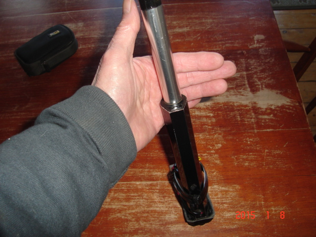

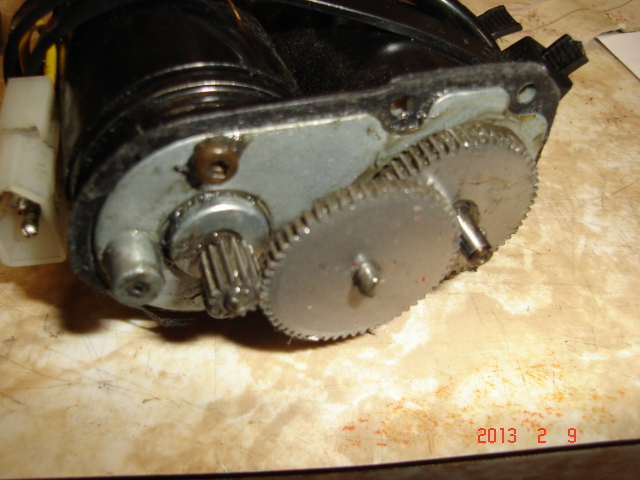

That's called a "linear actuator." Inside is a threaded rod and the motor turns a gear reduction set in the base (that sometimes gets water in it & freezes up). They ain't cheap, and you need to get one that has the right overall height (extended and collapsed). I think --but not sure-- the chute rotator uses a wiper motor.
