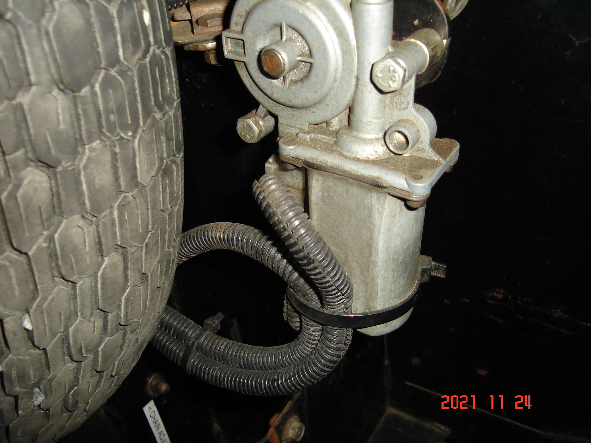

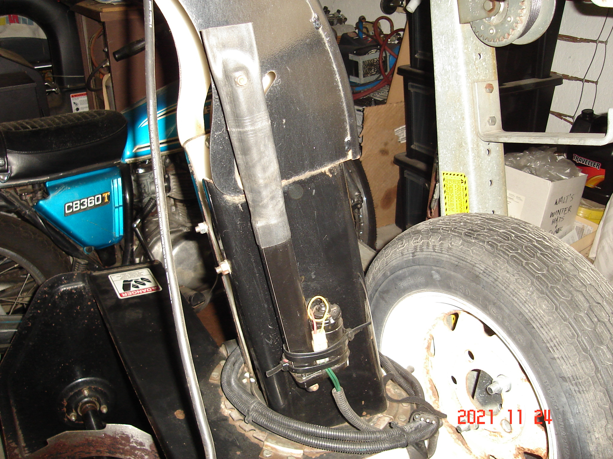

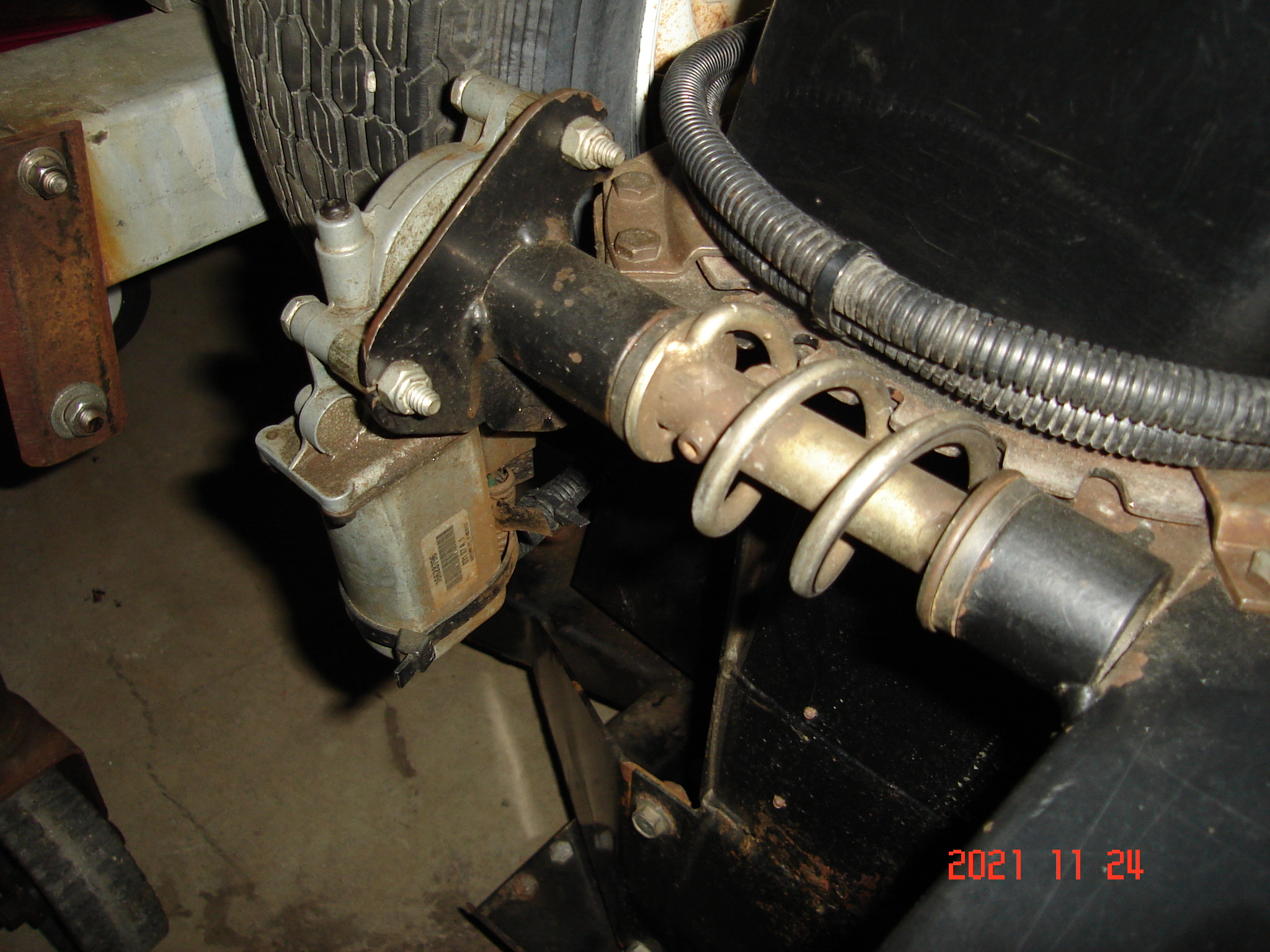

Here's some pics of the factory set-up --
   / Massey GC & Kubota BX Front Quick Hitch Compatable? #59
Thank you a whole bunch!! I can do that. Might be the easiest way to do it.
   / Massey GC & Kubota BX Front Quick Hitch Compatable? #60
Let me know if you need more pics or measurement stuff. Glad to help; I also think this is the easiest way -- only requires a couple of weatherized --rubber covered-- polarity-reversing momentary switches. (You already have that open worm-gear thing for your manual turning arrangement, right?)
