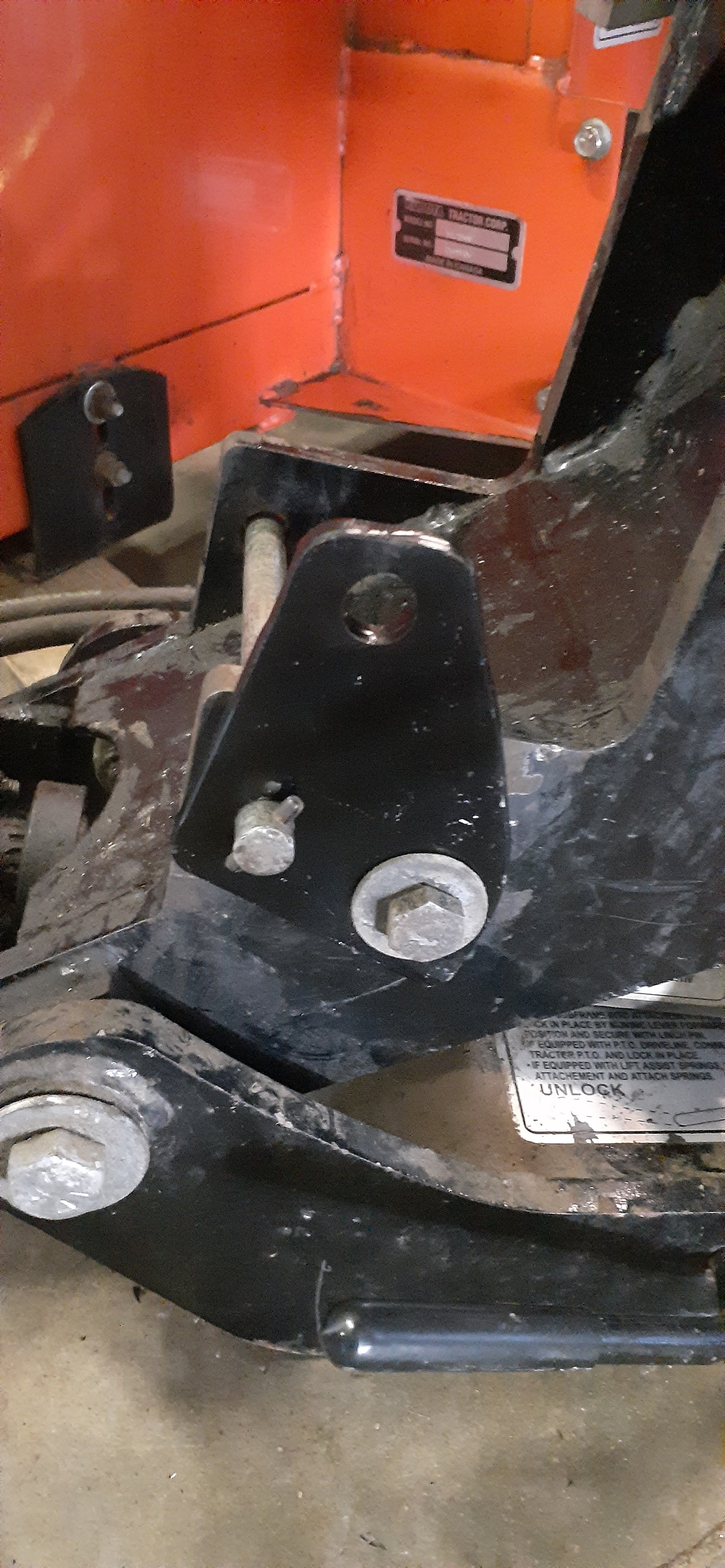

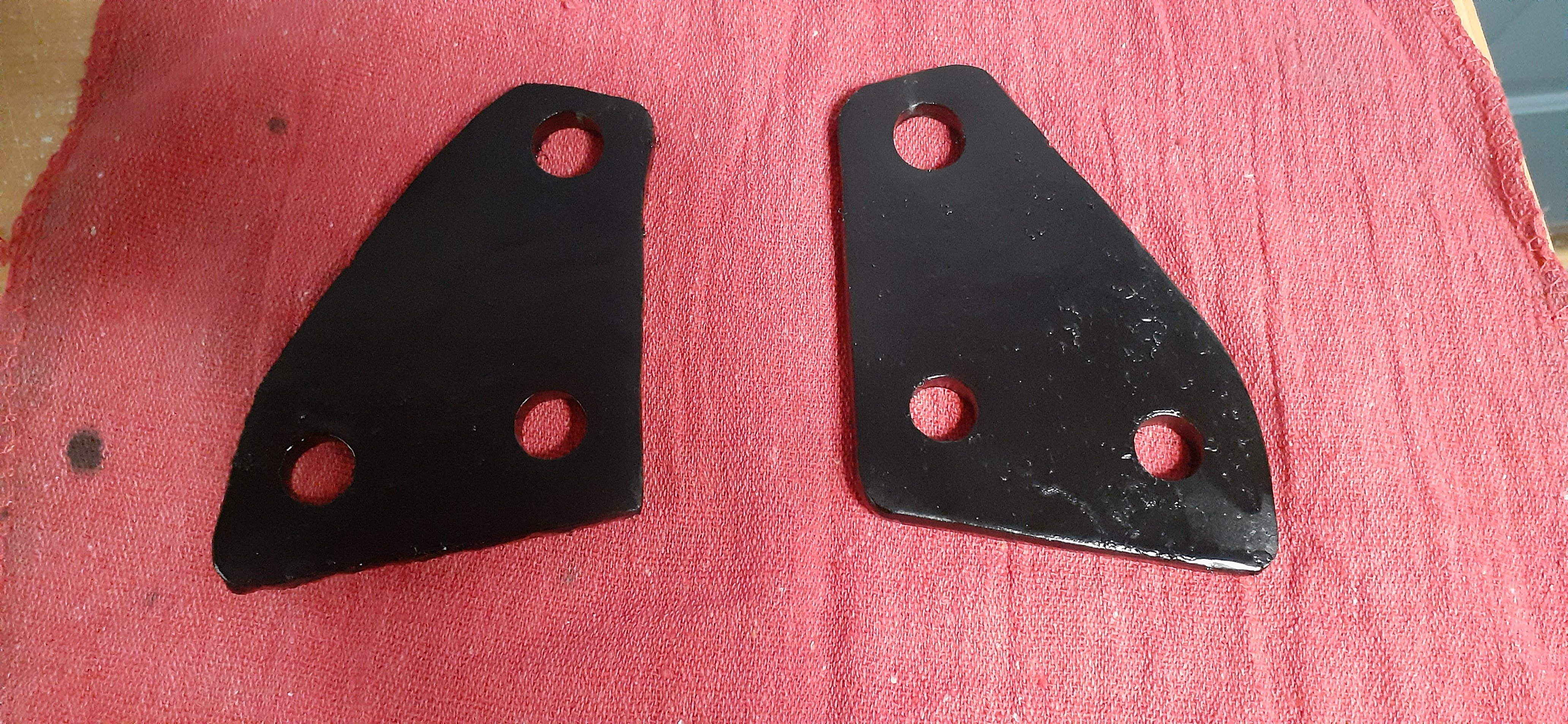

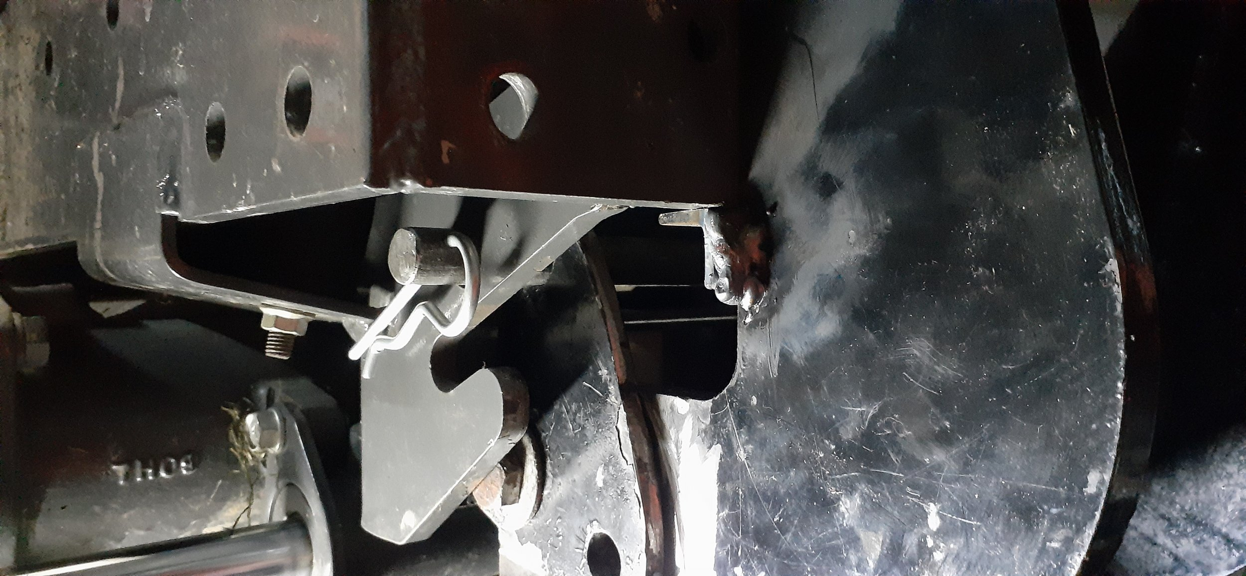

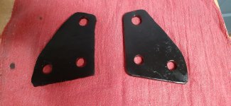

I got the correct hydraulic fittings from Massey for $11ea, and had to get a couple bushings for $7.50ea.

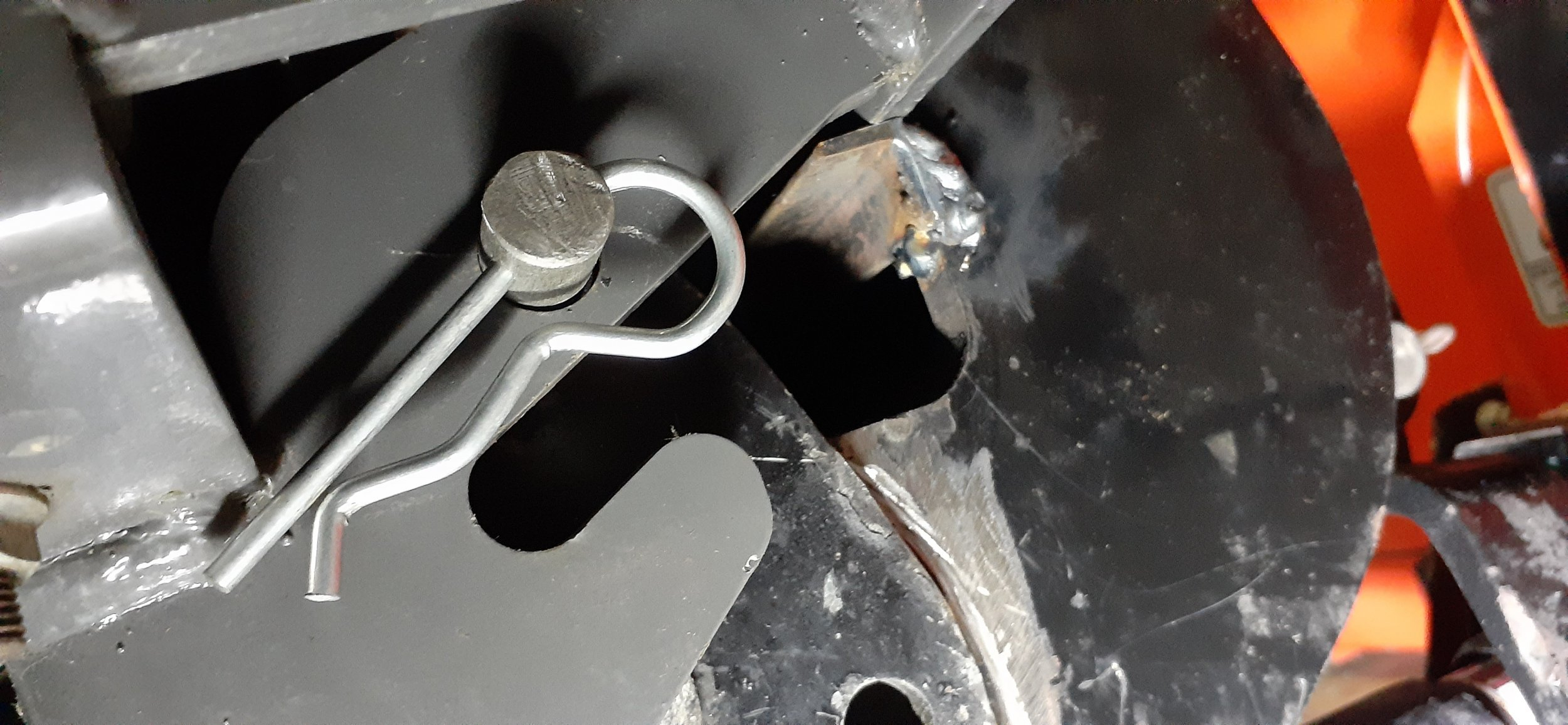

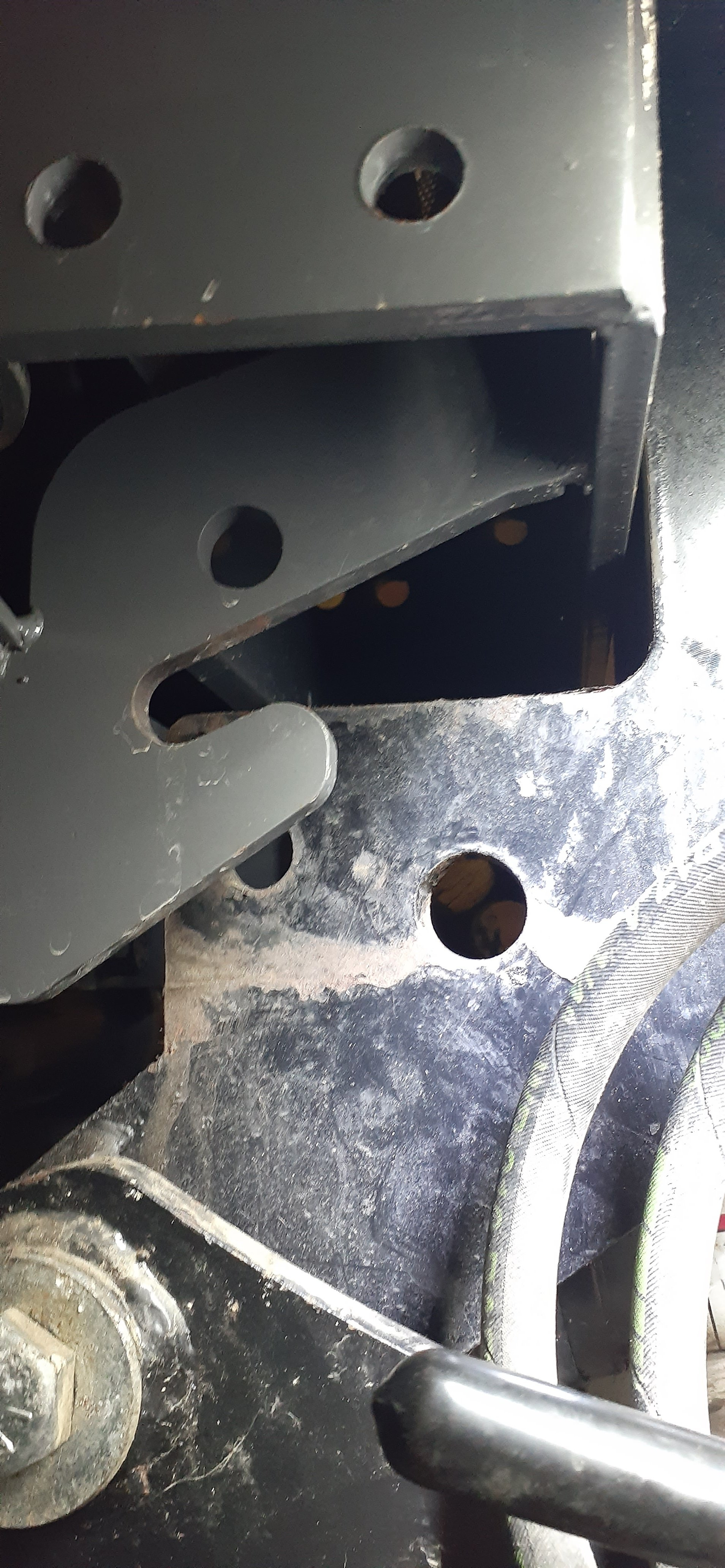

Here's the plates I made.
They go here, I have a 5/8" shaft to slide through the top holes.
Now I'm waiting for the driveshaft to come in, then I'll mount the whole thing up and make sure it works.
I will weld something to the hitch below the tractor frame to keep the mount from riding up when using down pressure.
Hopefully, since I'm ready now, we won't see any more snow this year.

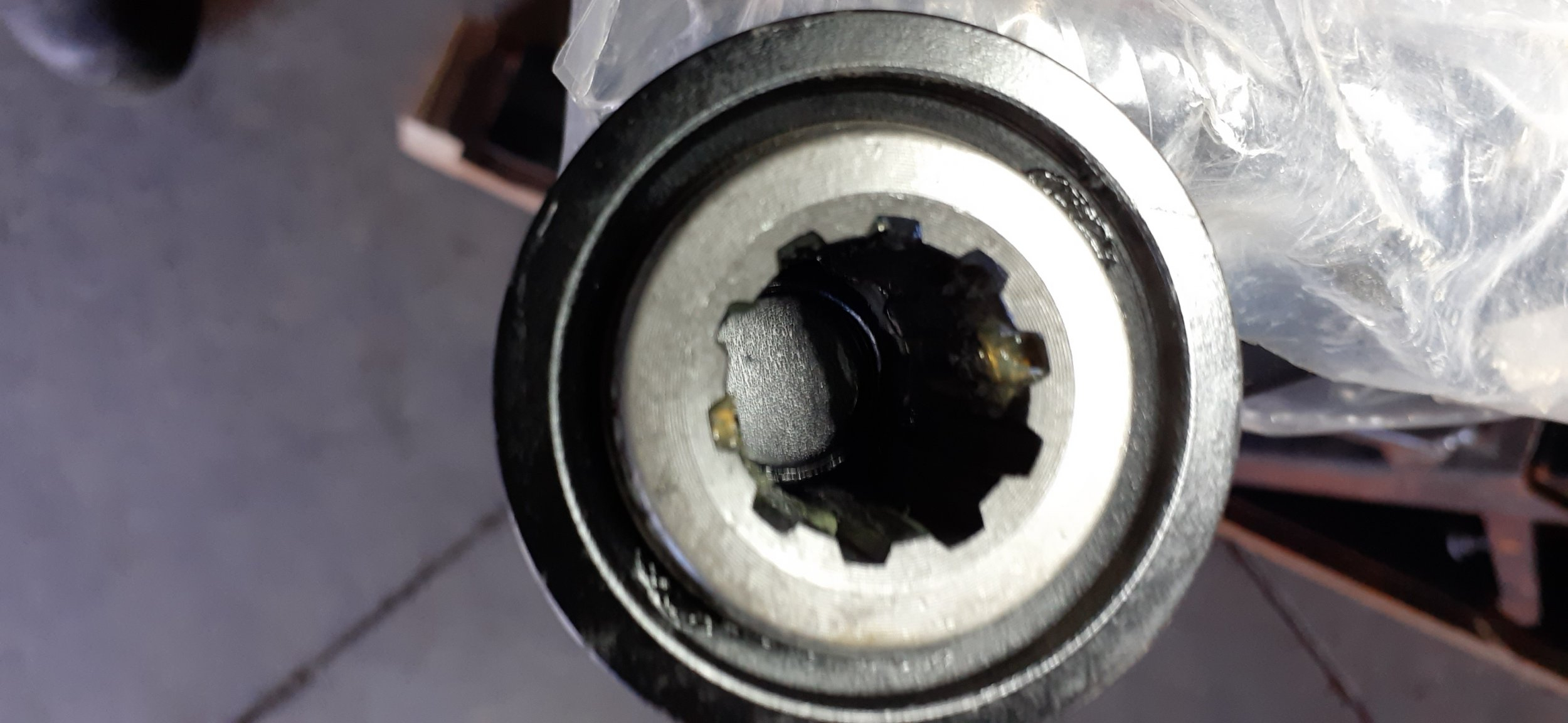

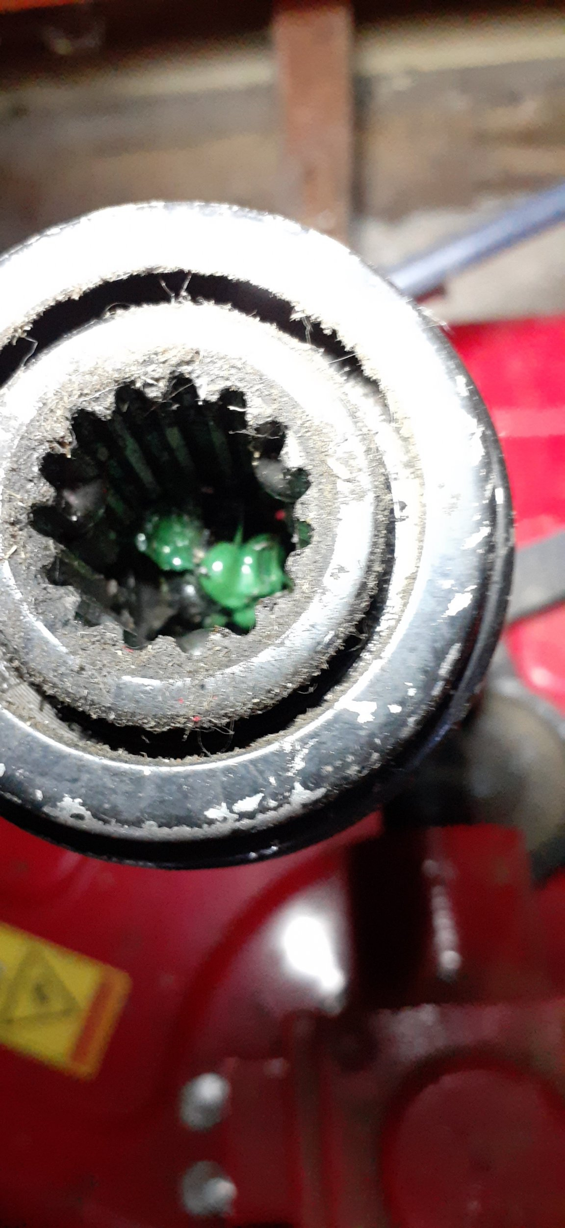

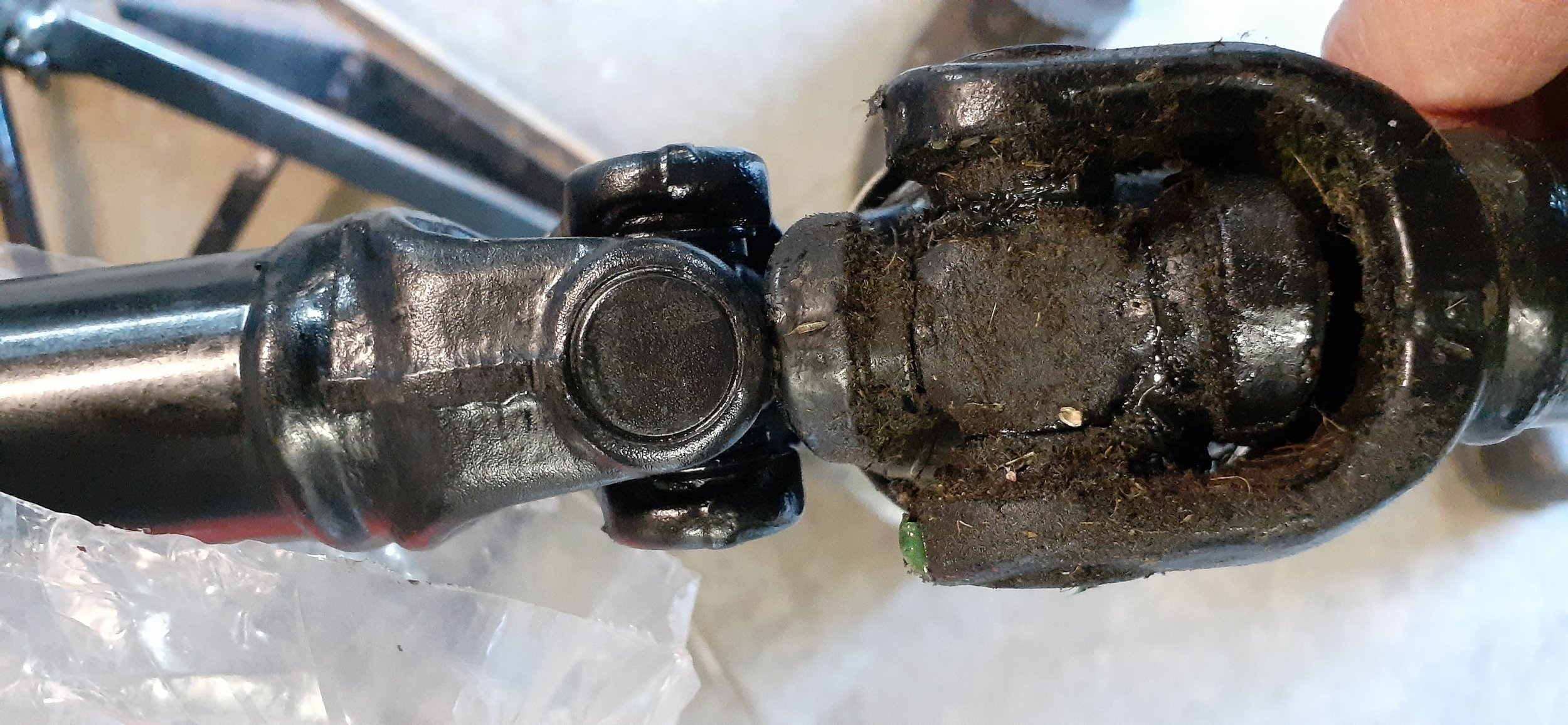

Update; I FINALLY got the driveshaft from Kubota, after over a month wait, unfortunately, the tractor PTO coupler is different. I was hoping that PTO shafts were standard. I was going to just get the Massey coupler and have it welded on, but then I noticed the Massey U-joints were larger (comparing to my MMM shaft) than the Kub ones, so I might just return the $300 Kub shaft and spend the extra $200 on the Massey shaft. In the long run that will probably pay off. I just hope that the splined end at the blower is the same!

Stopped at Massey dealer with Kub shaft, they had a used 2360 MF blower, and the Kub shaft slid right on the splines, so the MF shaft should work. I just need to order it.

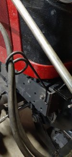

Update; Well, like it or not, snows coming, so I tried to install the blower today. I got the new drive shaft coupler from Massey, $175, and swapped it onto the Kub driveshaft.
Put the Kub hitch on, and tried to connect the driveshaft. Dangnabit!! It's about 3" too long :mad::mad::mad:
So, apparently the Kub is a little longer than the Massey. Oh well, I'll get it shortened, better than it being too short, that would require buying a piece of tubing as well as welding both ends. This way I just have to cut and weld one end.
I knew I had to figure out a couple other things, such as how to keep it from riding up when using downpressure, I think a piece of angle iron welded across the hitch will take care of that.

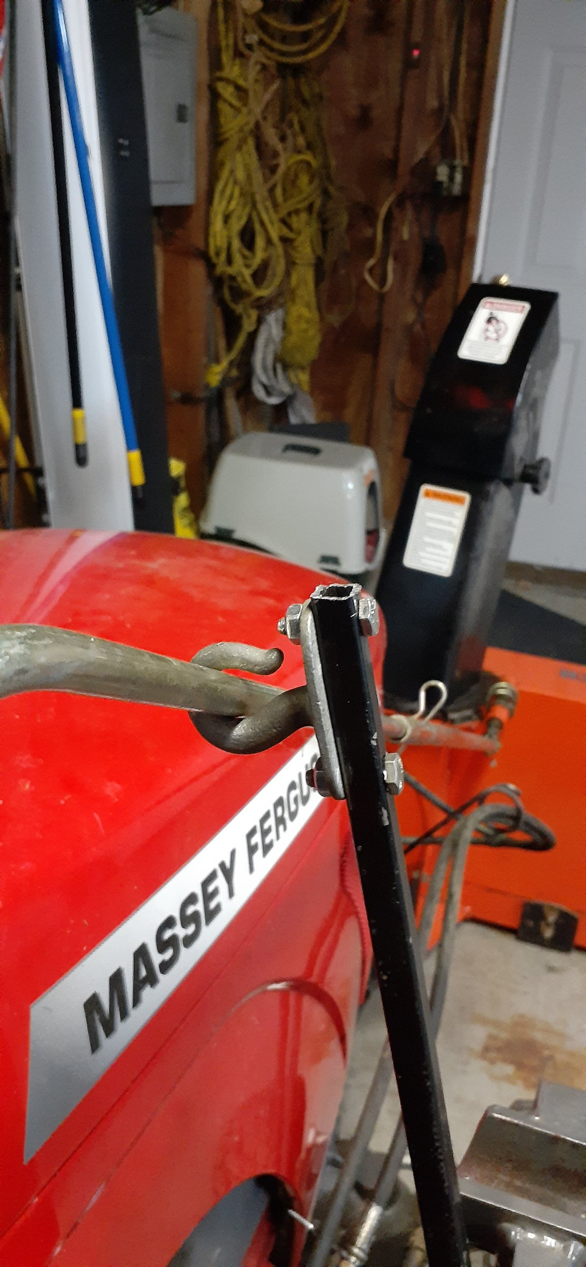

I still have to figure out the chute swivel control rod, but I think I know how to do that.

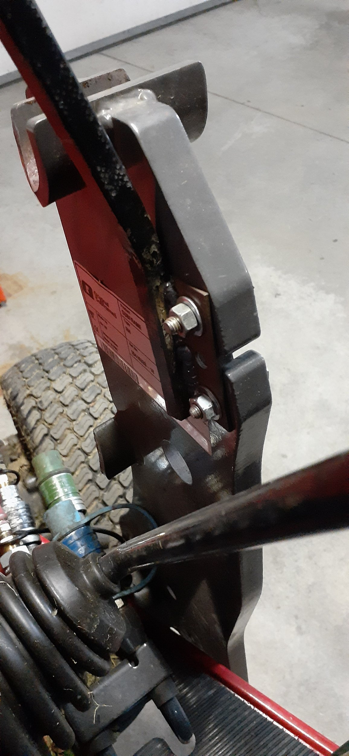

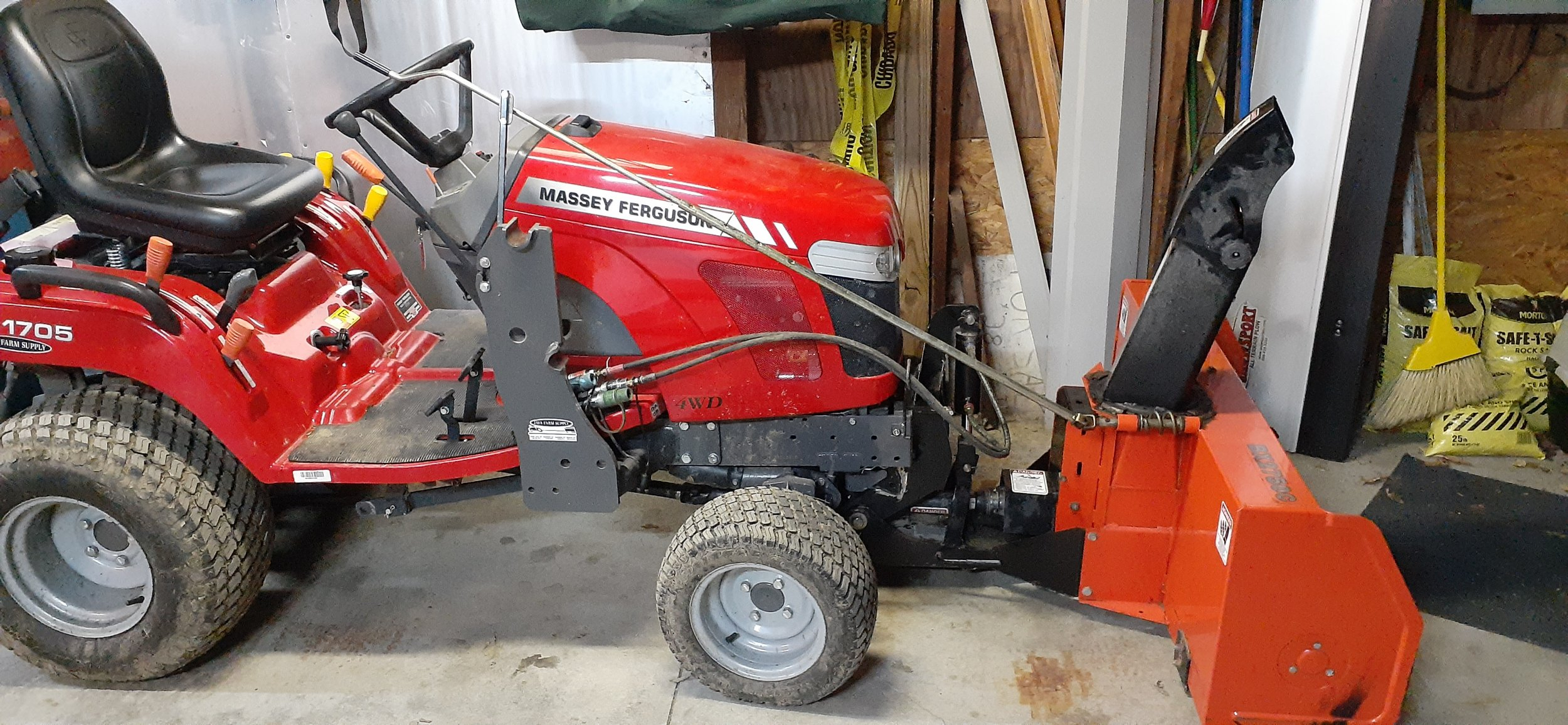

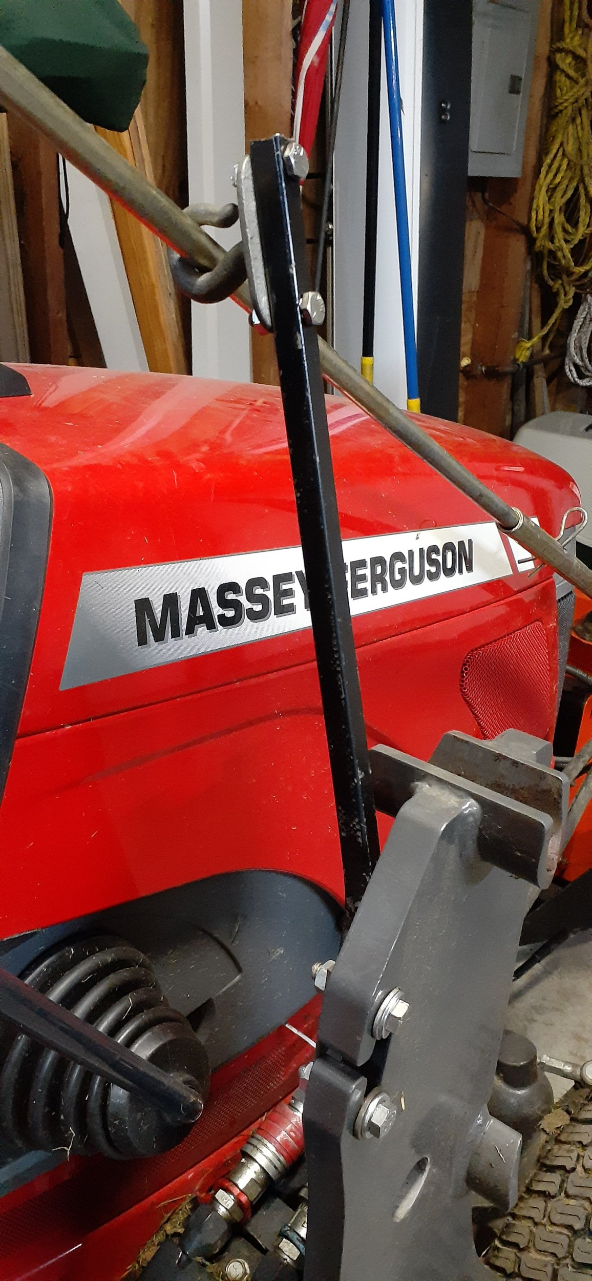

Finished! Got the driveshaft shortened 2.25" ($60), got the chute turn control rod support made, hose support, and welded an angle iron to keep it in place when using down pressure.
