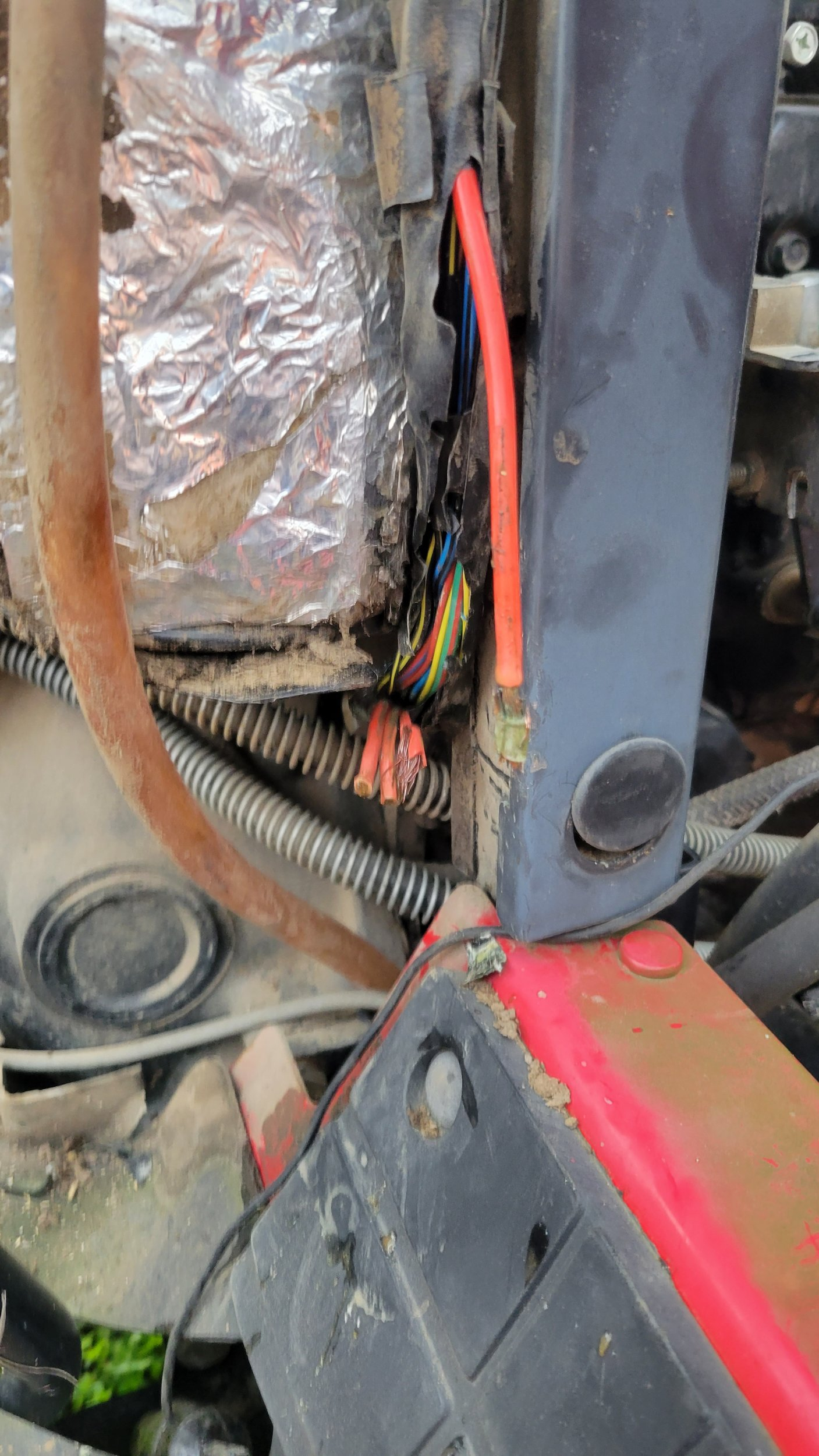

interesting failure, does your tractor live outside?
Most of the time. Several others have had the same problem. It only takes one good rain to get water in there as there's no way for it to drain.

its a connector issue on the glow plug rail, its a quick disconnect, doesn't seem rated for the amperage.
any idea where the water comes in at? the hood seems pretty protective
   / Max 28 won't start #14
Found the problem. The wiring harness on the right side under the dash collects water and of course the main hot wire splits into three wires right at the bottom where it bends and enters the engine compartment. It's just a crimp connection and the water in the harness causes it to corrode and eat the wires at the connection. Absolutely the worst place you could put such a connection. View attachment 720578View attachment 720579
Looks like a tinfoil sandwich was left in there.

Don't know where it comes in from, but it dripped for 10 minutes after I opened up the harness.

is your machine stored outside? doesn't look like corrosion more like it broke from vibration, wire looks clean, also interesting its another max28
