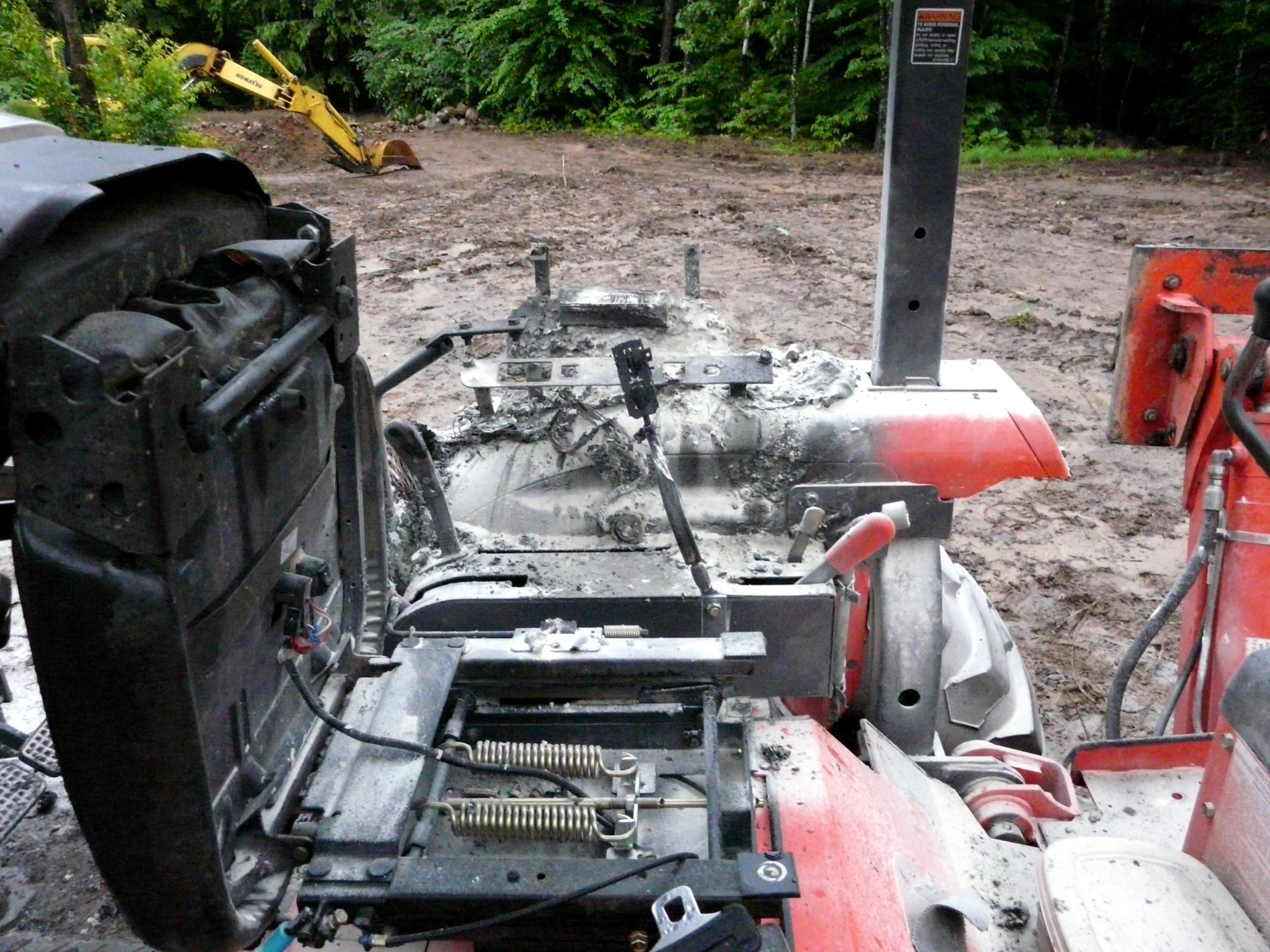

Re: Max28 and cold Weather, Burning down the Barn
I do't want to be around for this.
Heating up a tractor that won't start while overfilling the fuel tank.
I think getting the tractor set right so it starts when cold is a better idea.
PS.
Don't leave your tractor outside during a lightening storm.
