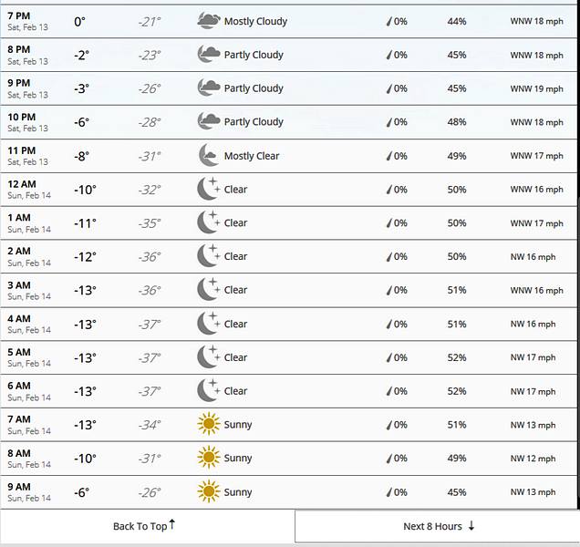

New Englanders....... good weekend to test your Mahindra starting.... :)
   / Max28 and cold Weather #85
check the video from this morning:
