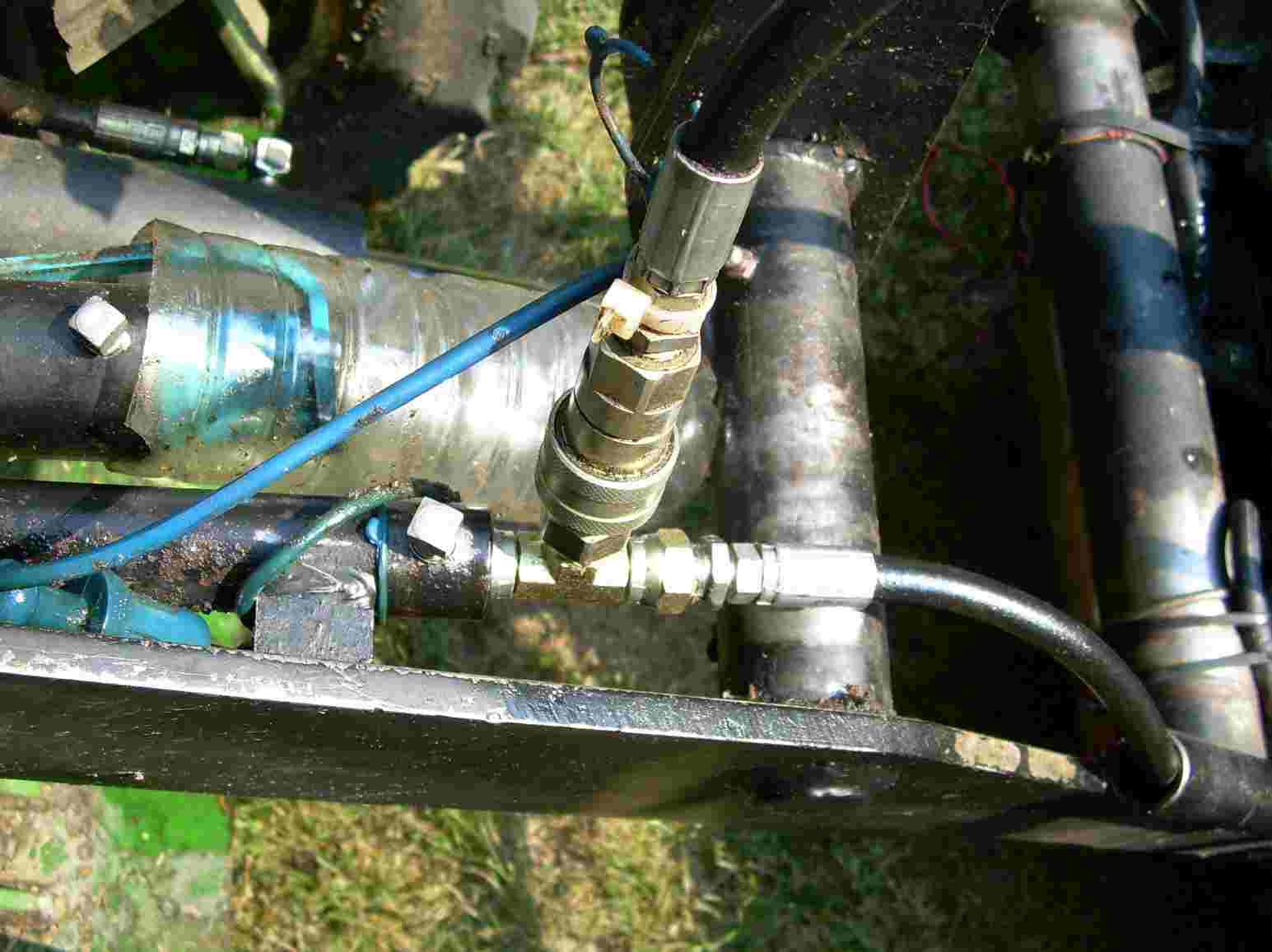

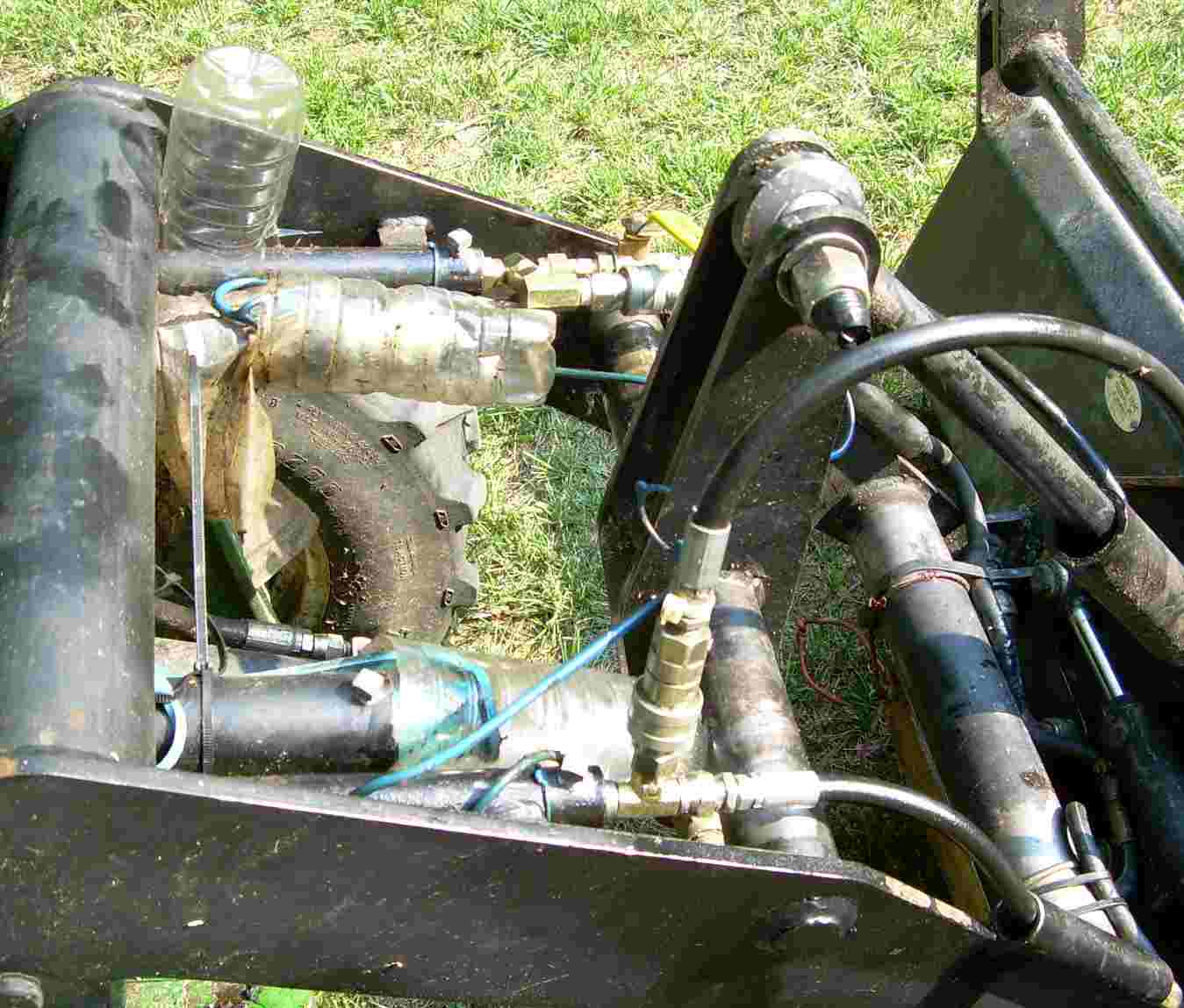

I went to use the mini hoe today and found that the right hose was too short with the hydraulics modification. I had put a 90 deg elbow on the left side, but had not seen the need for one on the right at least when using the buckets. However it does make a difference with the mini hoe. Fortunately I had a spare, put it on and it works fine. It makes sense, since the original fittings were in this orientation and close to the same location. I have attached a picture.
