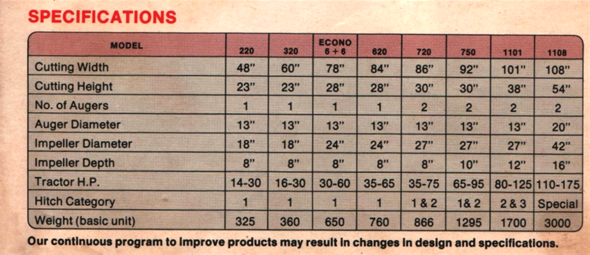

I also have a McKee snowblower, it's the larger 720. Info is sparse since they haven't been built for years. Luckily, they are well-built. I found this info on web at one point and it may be helpful. I don't know why it doesn't list RPM!
Search ebay, manuals (both orginal and reprint) are available for cheap!

thank you well look again may have put some thing down wrong
