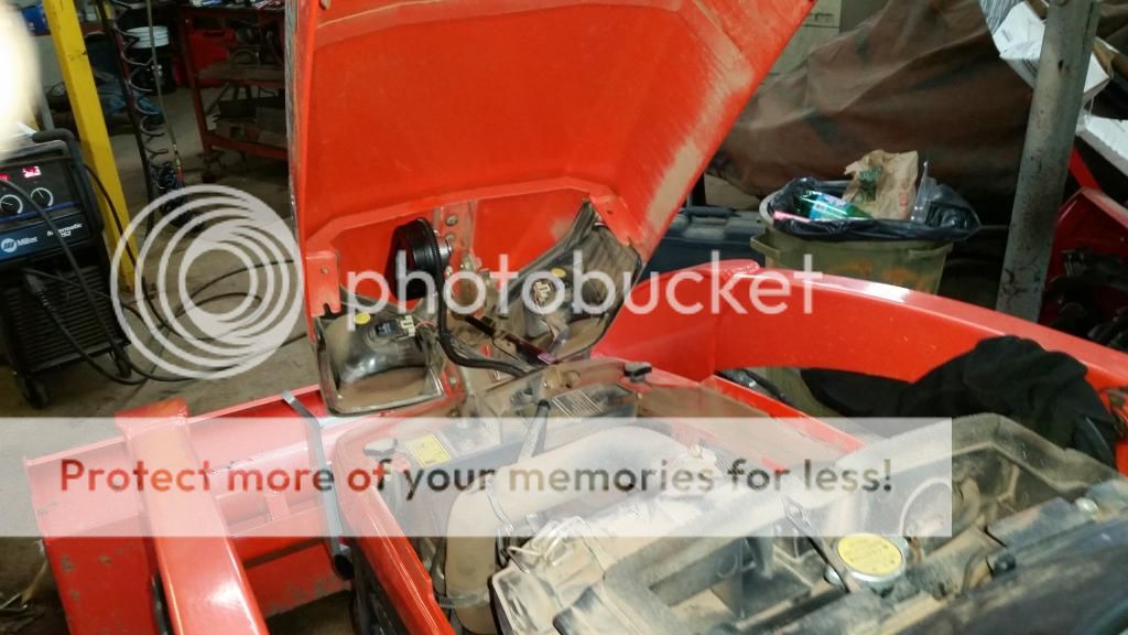

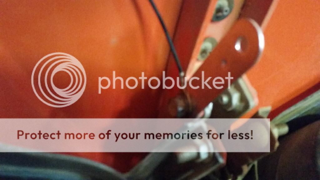

First was to find a home for the horn.

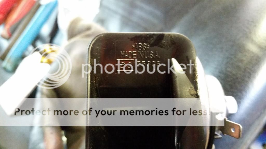

The horn is a Made in USA Fiamm "Freeway Blaster" :laughing: unit. 12V 130 dB "Freeway Blaster" High Tone Horn | Princess Auto
Made in USA!

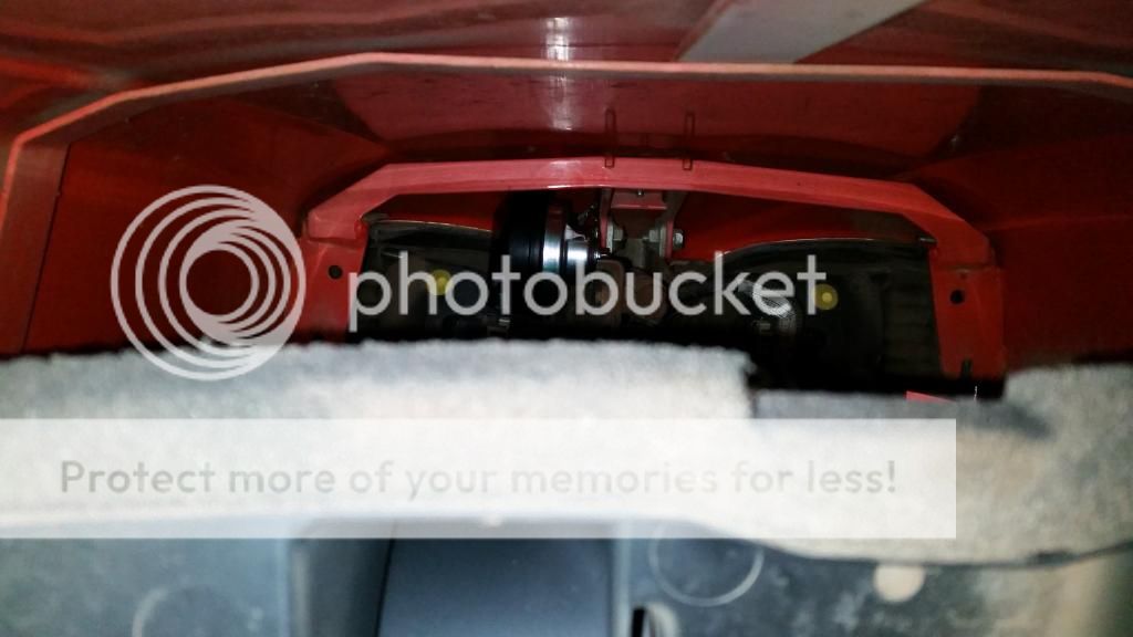

I tried lots of locations on the BX to mount, but a BX is pretty cramped. The best place I found was up near the headlights on the bonnet. It was a perfect fit. When the hood was closed it just cleared the crossmember and the lift strut
   / Me So Horny... Adding a horn to a BX25
Fortunately the bonnet mounting bolts are grounded, so that meant an easy 1 wire install.
Looks Factory. All wires loomed

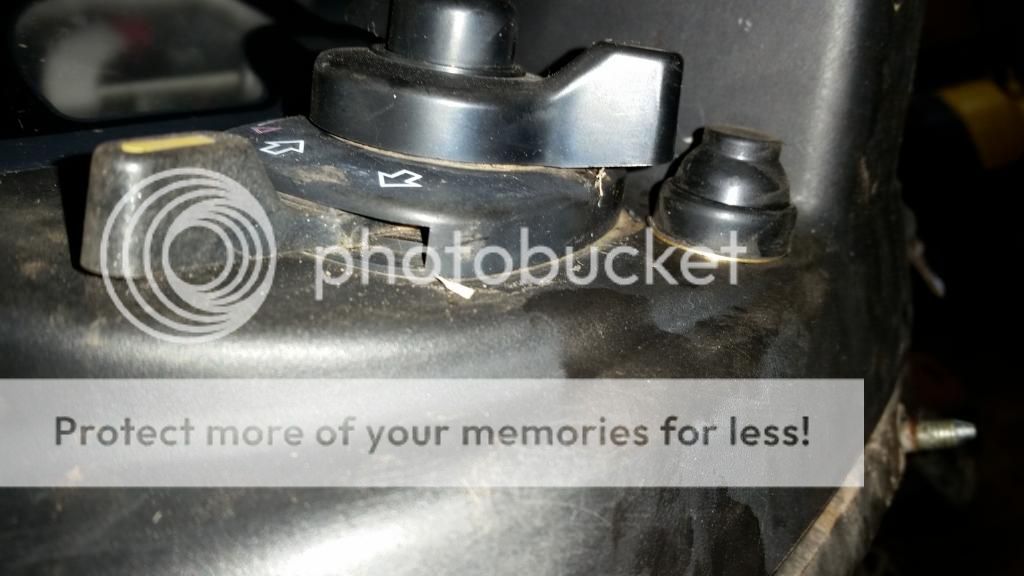

Now that the horn is properly mounted, that leaves finding a suitable place for the switch. Easier said than done on the compact dash of a BX!

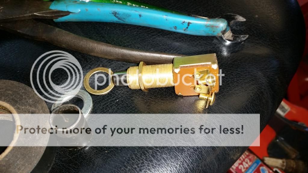

The Switch.
Switch Part No.

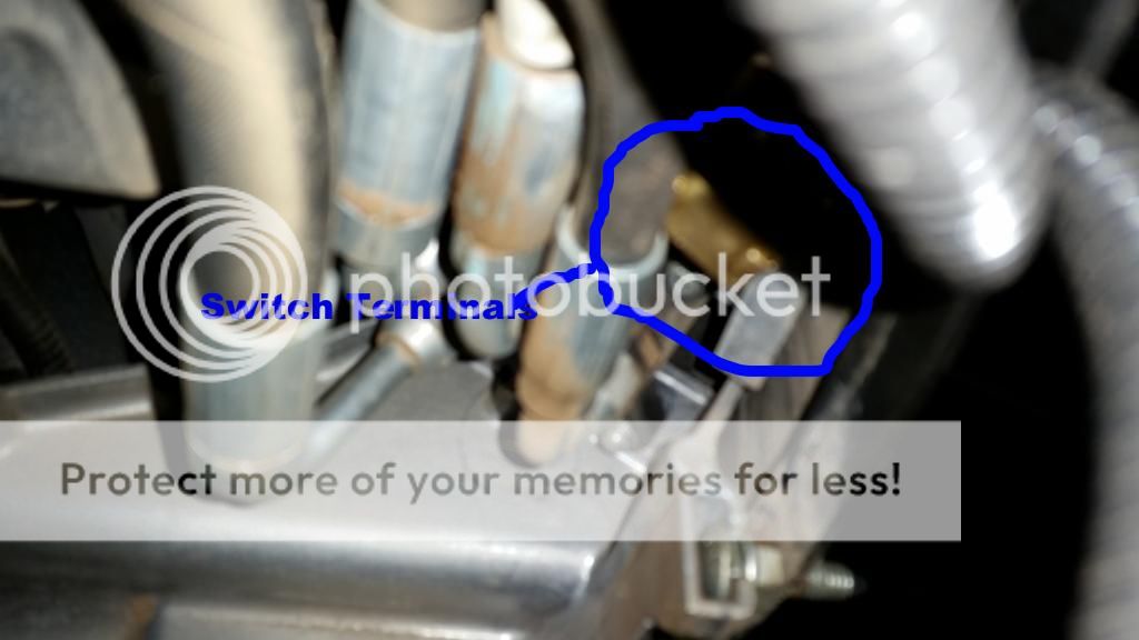

After much trial, I found a great mounting spot near the headlight switch. Its between the headlight switch and the orbital (Steering) hydraulic valve. As you can see, its tight!! That brass in the upper right is the switch terminals.

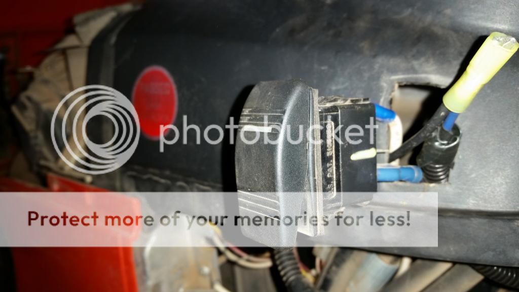

Pulled power from the existing fused and switched circuit that powers my aux worklights.
End result looks Factory. I think its the perfect location!. If I was going to spend more money on the job, id consider the actual factory turn/headlight switch assembly from Kubota from the B series(?) that has a horn button in the centre, but I think for the price, this should work excellent.
Seems to work Ok:laughing: Got the kids attention at least;)
