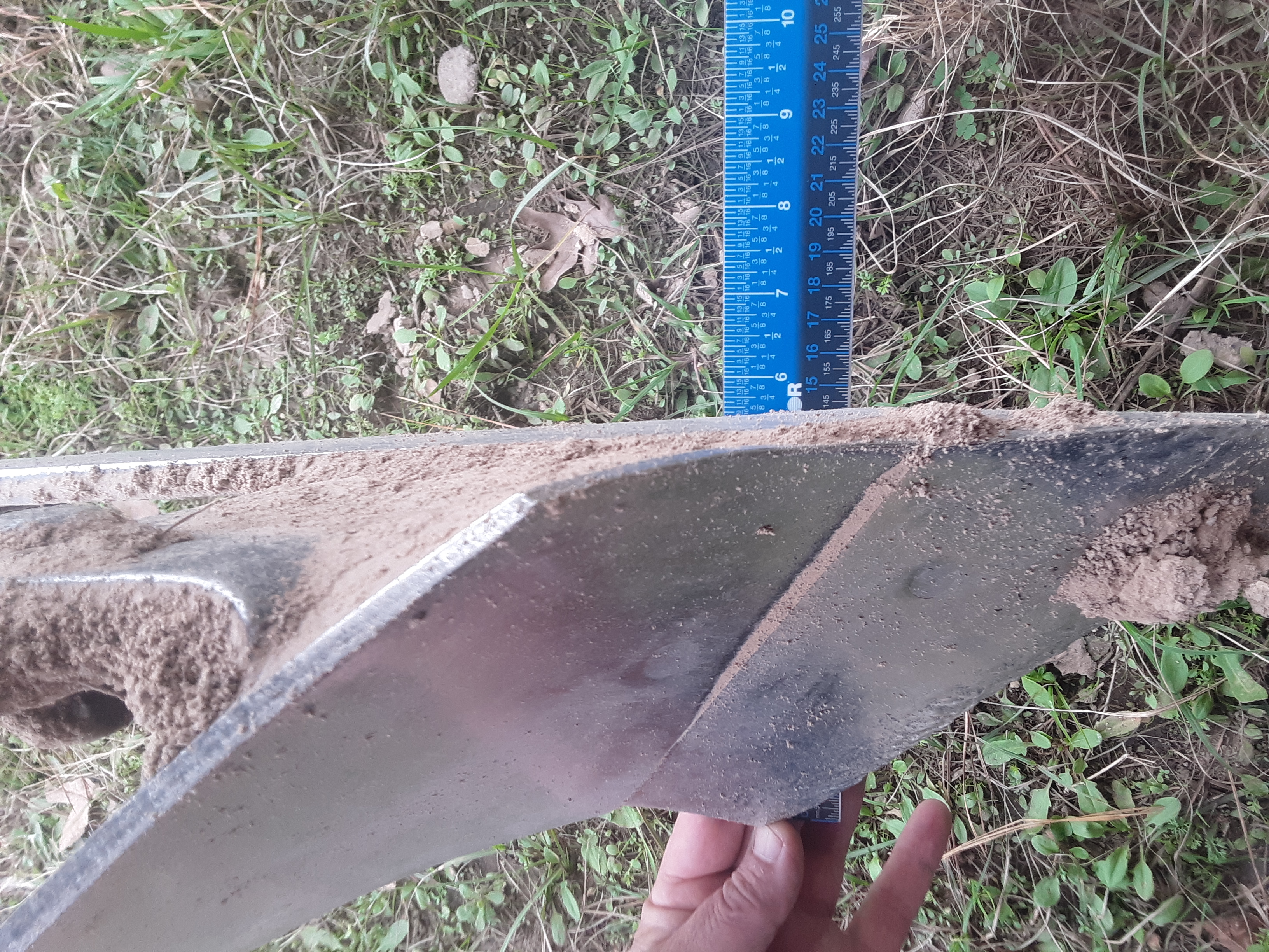

I am almost ashamed to admit this but my plow now only measure is 5.75 inches . It seemed to be a couple inches wider before I plowed my new garden spot that's 2.5 acres. The ground is sandy loam and it ate the cutting edge down at an amazing pace. toward the end I was having to re adjust the plow to keep it in the ground

You should post a photo because that doesn't sound right.
/ Measuring a plow's size? #5
Measure like this:

/ Measuring a plow's size? #7
I think I have seen moldboards and shares like that before. I think it's for plowing places where you want to leave a lot of vegetative "trash" on the surface for erosion control such as gravel or sandy soils, especially on slopes. I don't have time to do it right now but a search of moldboard styles should turn something up. I believe I saw them for sale in a Shoup Ag parts catalog so a search of their site might be helpful. That's what it looks like to me. At least it's a start.
/ Measuring a plow's size? #8
Looks like one intended for a 2-wheel tractor.
