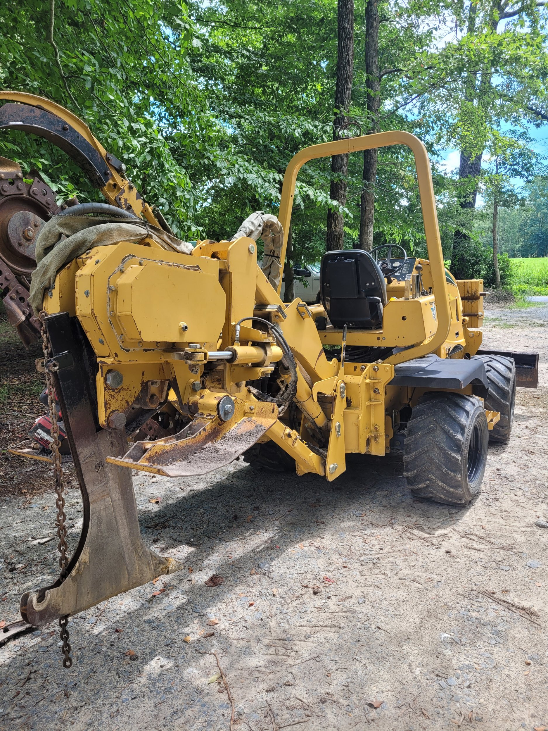

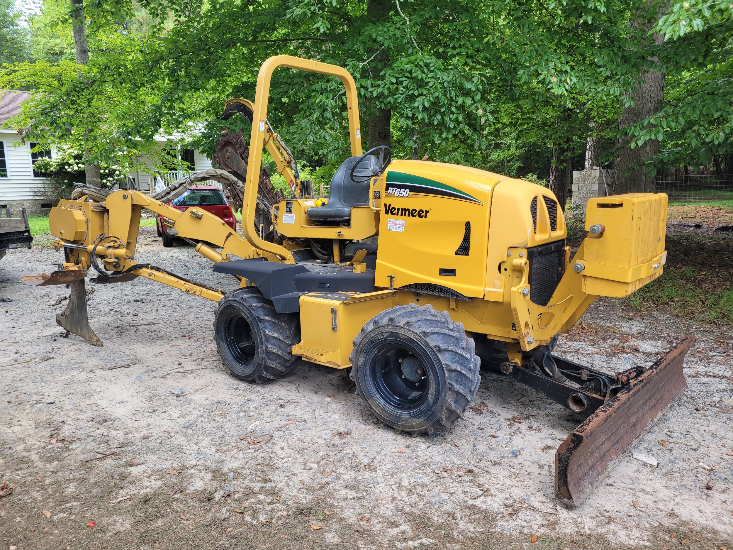

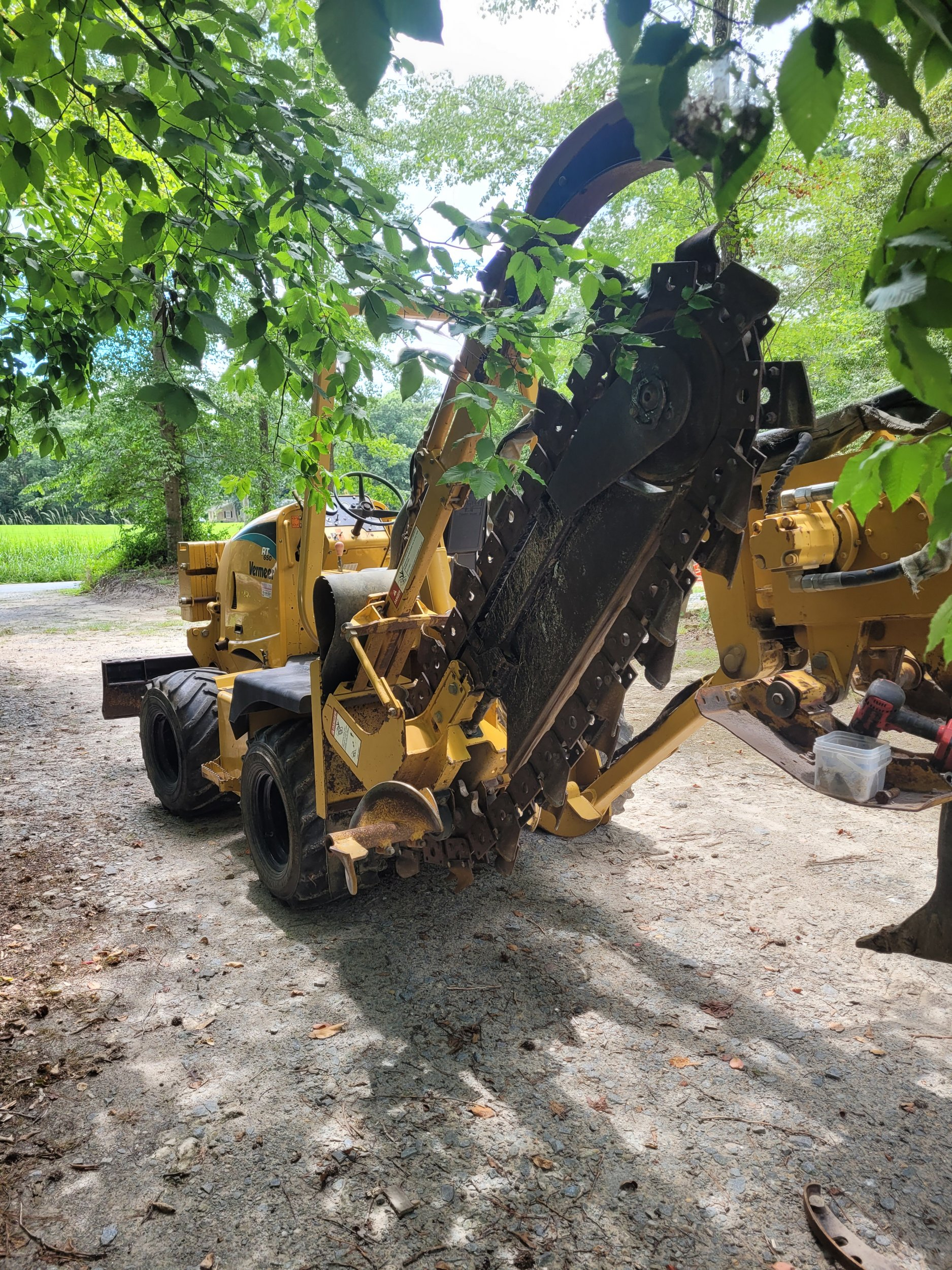

76hp turbo duetz, 4x4x4 with a 6way blade, plow and trencher. Putting it to work tomorrow. BB stands for big b#$%h. Lol.

Serious piece of equipment. Nice to be able to lay line while trenching at the same time.
Good luck w it.

I'm not familiar with the working parts I see. What is the plow-looking thing? Will that dig a trench and lay cable/pipe?

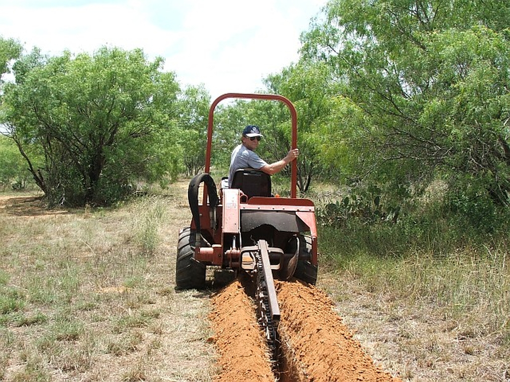

I rented this one to put in my city water line.

There is a toggle switch, you can only run one at a time.
The thing on the right is a vibratory plow. A hydraulic motor spins a gear that spins an out of balance shaft and it shakes is a off. You can feed conduit/wire/etc through the shoot or you can pull a chain to a floating bullet(3" in my case) then a metal chinese finger that grips the conduit 2" in my case. You park the reel on the reel trailer at the start point, pulls it off the reel through the ground and it just makes a 1.5" or so cut in the ground that seals back up. No backfilling like the trencher I've been using. My longer runs will be 1200ish ft between boxes sometimes it only 2-600ft between boxes/vaults. Hoping to do 3000ft a day with this might even be able to get more!

2005. I had to clean the valve in the block that switches from the plow to the trencher and drain and clean the fuel tank. I'm very happy with it and have been offered twice what I paid for it but it makes me that much in two weeks so I declined.

It has a trencher on the back also and a 6 way blade up front. I do this every day for a living so renting doesn't make much sense for me. My best weeks I put in 9-10kft my bad weeks 2-4kft. Much depends on what utilities are in the way, how many peds/vaults need to be set and driveway/road bores. I'm trying to hire more people so I don't have to stop plowing to do those things and the operation runs along with everything being done at once.
