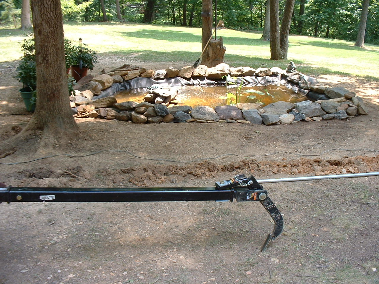

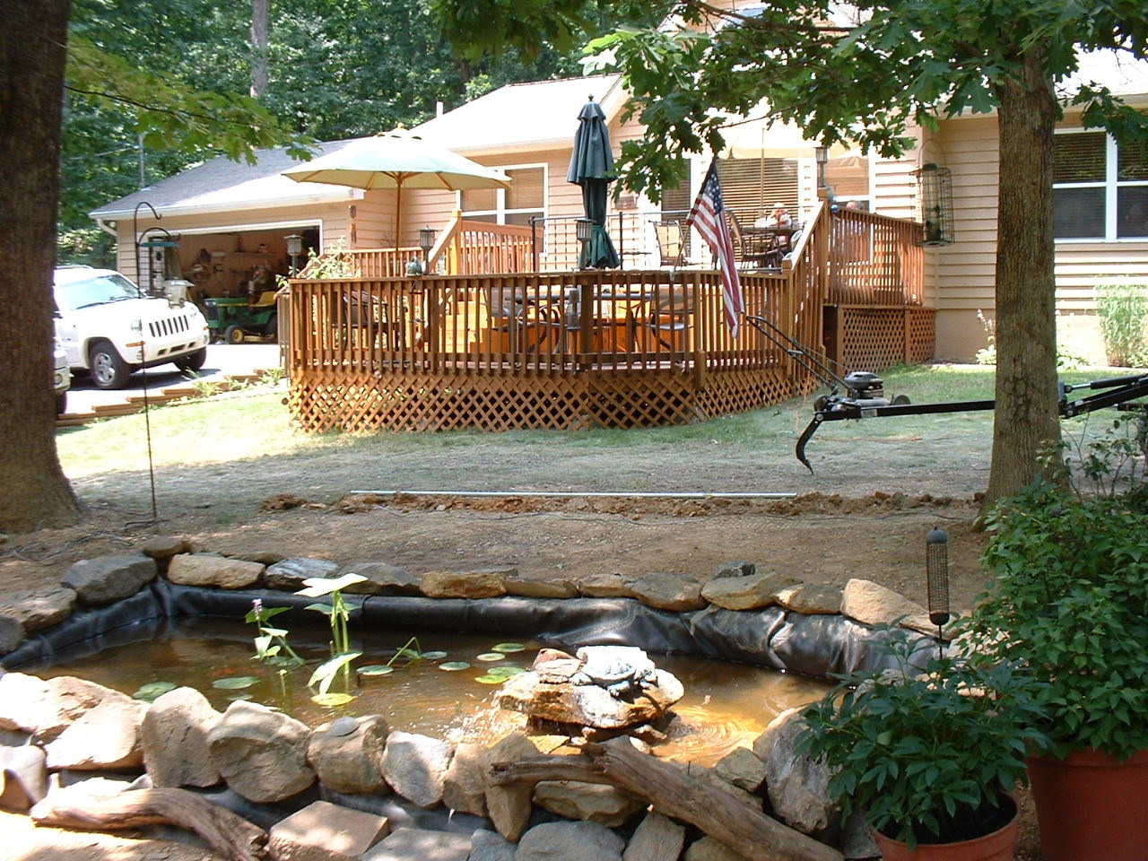

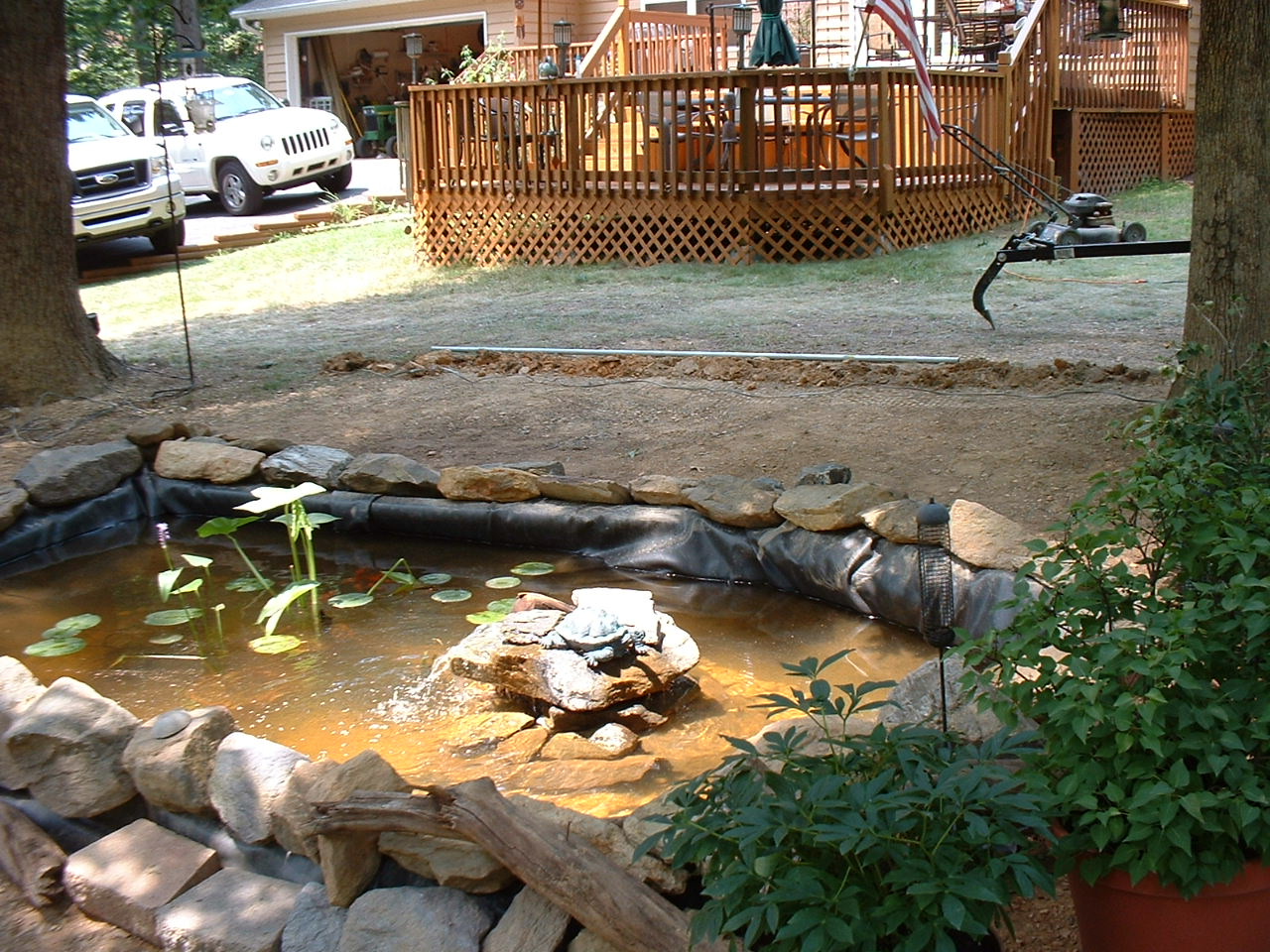

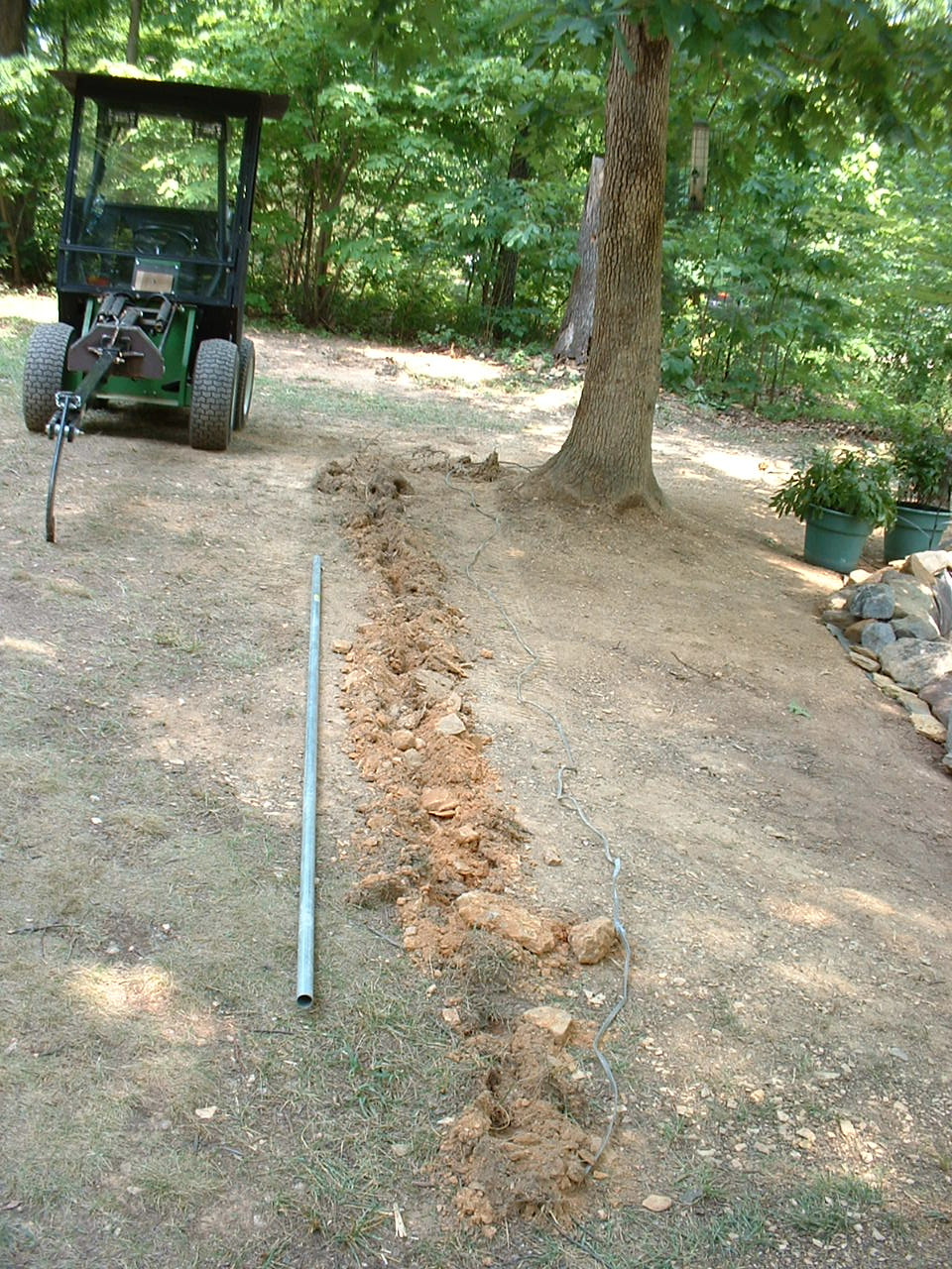

For anyone interested. Here is an electric line I am burying with the ripper, and the pond as it stands now. I have to go on another rock search here on the mountain to finish filling in around the pond and then will be adding underwater lights along with landscaping around the pond area.
I’ll finally be getting some time in the next few weeks to work on some other ideas for simple attachments. Still would like to see some more pictures of other member’s inventions. I know you’re out there. I would specifically like to know if anyone has made any heavy duty dump carts for around there yard? :cool:

Your place looks very nice. How deep can you bury cable with your ripper?
Dale
   / Members home made attachments / improvements
#98
DHS said:
Barry,
Dale
Well thanks for the kind words. Between dealing with contractors installing a bathroom downstairs, and numerous other things going on around here, I have not had the time to work outside as much as I would like to. I am also clearing trees and working in the back. I'm really looking forward to the fall when it cools off, and I can run the PT without so much heat involved.
The ripper works great down to about 8 inches for a single straight line. Depending on the angle I use. The only thing that really stops it is when I hit a large rock or thick root. When that happens. I just back up a couple of inches or so and get a small running start and the root will snap in half or the rock in most cases will come to the surface.
For not being a gear driven 180. I am always surprised at the power it can bring to the table. I may have already posted this pic, but here is what the attachment has done so far in helping me with digging. Very useful around here because the soil is hard packed clay with lots of rock, shale, and roots.
If you look at the pictures above you can see some of the rocks and roots it popped up.

Hi Barry, I would recommend a shorter boom, or the ripper attached to the quick attach plate. It will dig deeper with out a lot of stress. Are you going to pull the whole line with the wire in it, through the dirt with the ripper? If you haven't thought of this, you can weld a short piece of chain to the back of the ripper, attached to a 3/4 female pipe, or whatever size pipe and just screw the electric pipe into it and pull the whole assembly. Also if you are going to pull the pipe through the trench, try and not use straight couplings, they tend to catch on things. The best way is to glue a pipe inside of another pipe, with out using a coupling.
