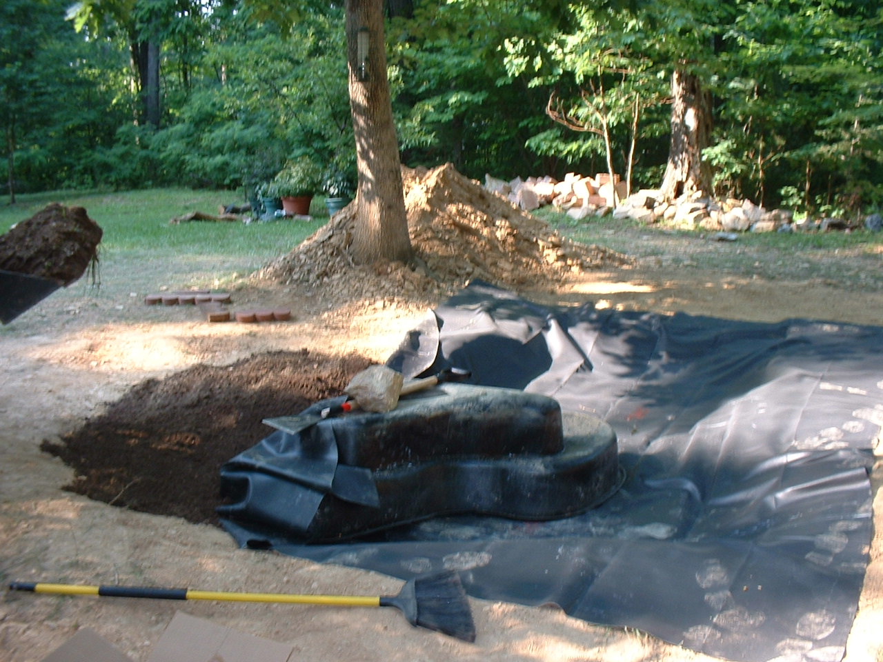

Just came in to cool off for a minute, man you’re not kidding this stuff is murder to break up. I wish I had your sand. I finally got down to where I need to be, now I'm worried about all these roots poking a hole in my new liner. Some of the shale has sharp edges. I put down a 4x8 piece of plywood two tarps and now I building up the sides to make it a little more level. I'll post some more pictures tonight
I'm sure you guys don't mind seeing my trials and tribulations. As a testament to the 180 like all PT's, this thing is a tank. It has been crawling in and out of this hole all day long and has been twisted every direction I can think of with a full bucket. Its 90+ degree’s out today. I just hope I don't bend something pulling up this rock while twisting the PT. Ohh well, that's what I bought it for to do the heavy work.
Thanks on the compliment of the start of the attachments. I'm know compared to some of the things you guys have made and done there nothing, but still in the absence of my mini hoe they have helped keep me from breaking my back so far. I plan to perfect these to be even more useful when I have the time. Also add a few more. Then on to making the mini hoe this 2- 1/2 by 2 - 1/2 steel tubes has proved like you said to be plenty strong, and also the weld job has been really solid, so mini here I come.:)

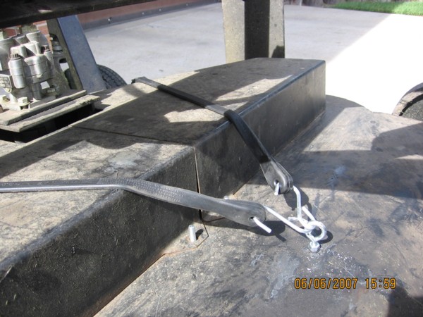

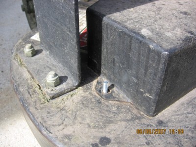

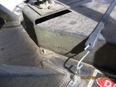

Cleaning the grass from the belt area of my mower was done annually because it was a pain to remove the six bolts retaining the covers. It is amazing how rapid the covered area fills with grass.
I removed the original cover bolts.
Installed slightly longer bolts from the bottom of the mower deck.
Installed a 90-degree bracket below each front wheel assembly nut.
Drilled one hole behind the covers and installed an eye bolt.
Installed two bungee straps.
This makes removing the covers and blowing the area clean much easier.

Nice fix.....:)

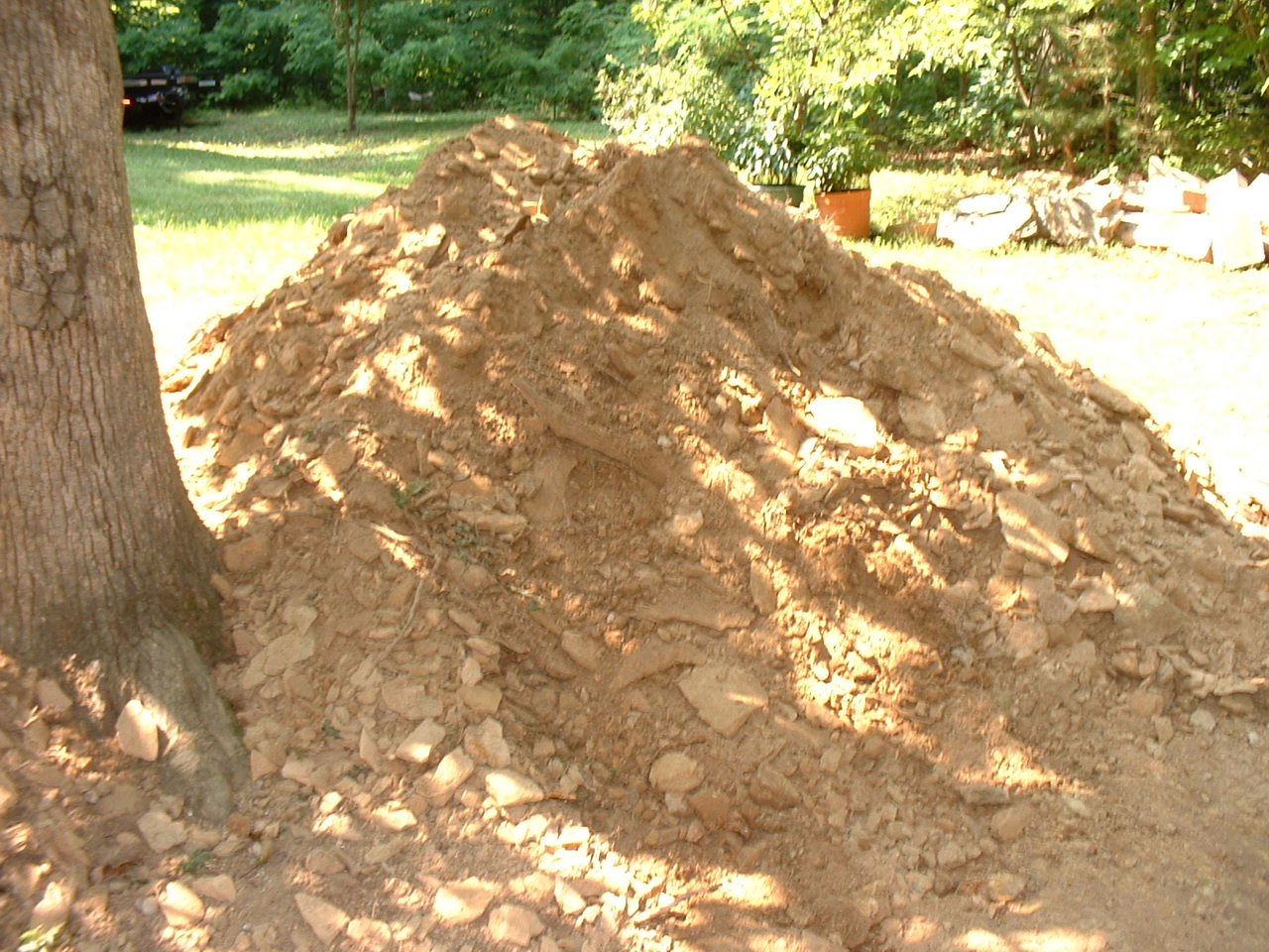

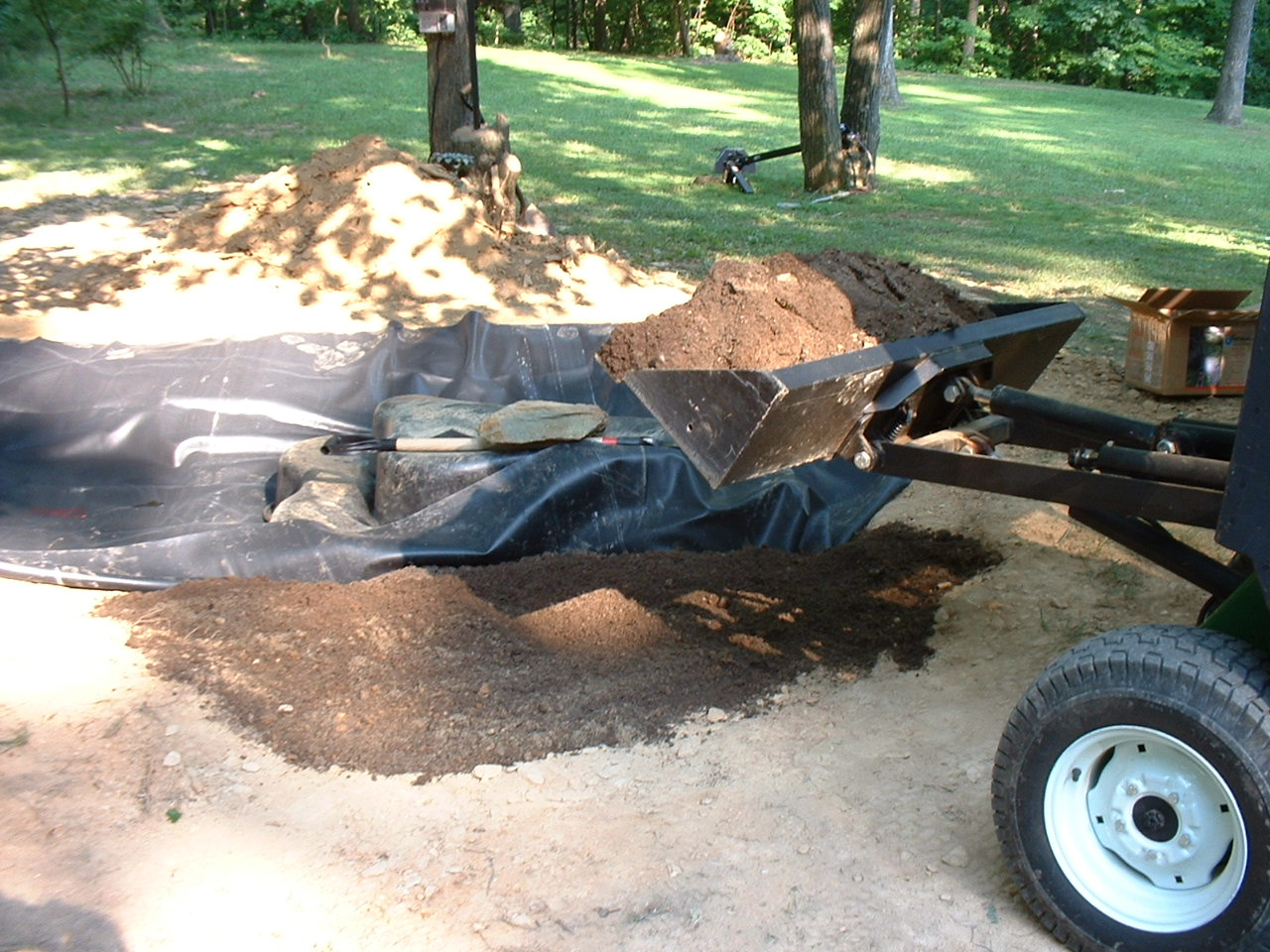

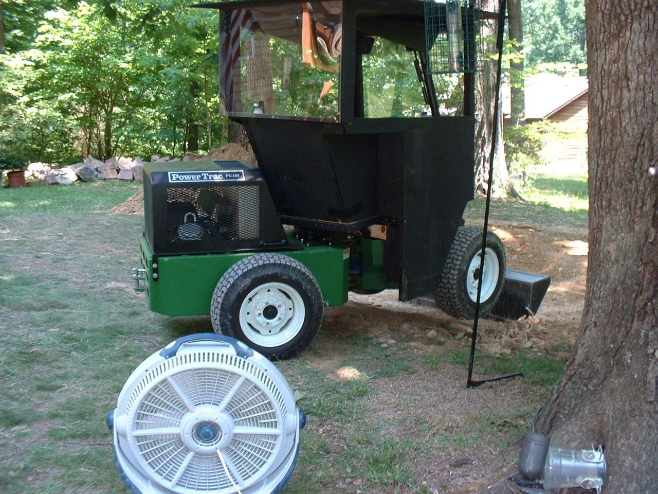

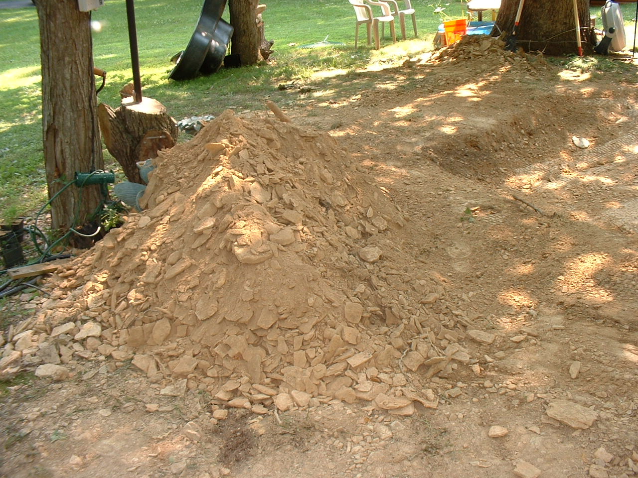

For those interested, here are more pictures to add to yesterdays on page 8 of the pond work I'm doing, using two plug in attachments. The first are the two mountains of shale dirt I removed. Then filling in around the pond area where I had to make a PT dirt ramp to access the hole. The last is my cooling station, cooling the PT every 45 minutes. By the way I found my septic tank in the process. :rolleyes:

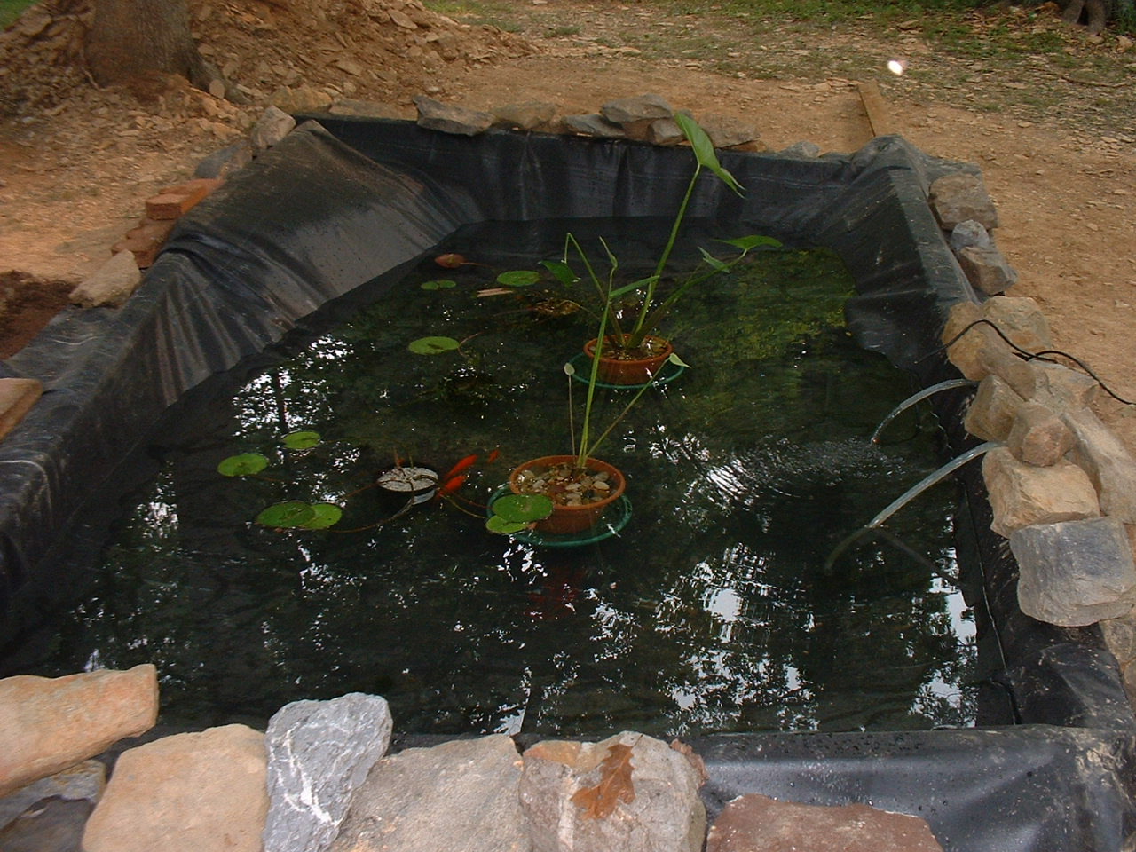

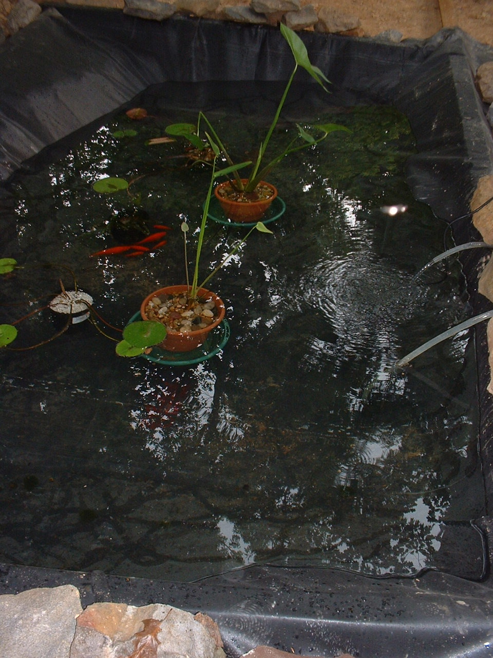

Pond at present state, now to clean up mulch in plant bushes, and finish the pond with rocks waterfall ect. The fish are now very happy :D
