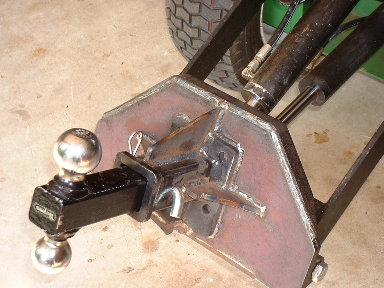

woodlandfarms said:
Carl,
You may want to think about using the setup I did. I had a hitch receiver welded on extra strong. Then I bought tubing from Northern
Buyers 48in. Long 2in. Standard Receiver Tube | Hitch Receivers | Northern Tool + Equipment
They sell it up to 48 inch lengths. This is the 2-1/2 inch tube. You can then buy the inner tubing which can plug into this for extra length if you like. I had the receiver welded with fins to reinforce the tube.
It's plenty strong. I can lift my tractor up off of the ground without any problem.Your larger attachment plate would offer more support than mine. You could weld on even wider fin's along with maybe a 3 or 4 foot top strap, using flat steel for more reinforcement.
Just a suggestion. I went with this setup so I can also make a rake plus other attachments, winch etc. When I get er done. I should have added another 10 plug in attachments to my list. Here is the plate once again and the outer tubing just in case you're interested. :eek: By the way nice job on the rake.

Barryh said:
Carl,
On second thought. I can see with your cylinder action you get more height plus length for those blackberry bushes. So your setup is better suited to your needs. Any pictures of the bushes and the pond you almost drove into or did I miss it? :rolleyes:

Barryh said:
Carl,
Barry, Nice job on the hitch adapter. Looks tough and well made. Good welding also.
   / Members home made attachments / improvements
#140

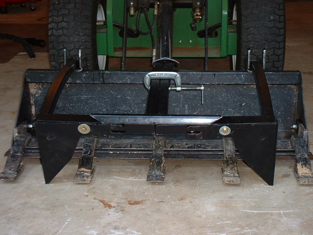

Thanks, it just opens up many other options down the road for new add on attachments. The way I see it, the hitch idea just carries on with the Power Trac tradition of quick and handy change over of implements and versatility.
I wish I could take credit for the welding. A friend of mine who works at Midas did the work. I'm looking forward to the 3 day weekend coming up. I get some time to myself to work on winterizing my PT, and working on my electric grapple.
I read this response by Island Tractor, he has me rethinking. I may change my design somewhat to a smaller upper grapple jaw. What do you think? According to him a wider upper grapple bite, does not center right when biting down on small trees etc.
Your comment about the electric cylinder not having that much force made me think a little more also. To my way of thinking there would be more concentrated force in a smaller area with smaller upper jaw. It may prove more useful that way with the 600 pounds of bite. Here's the link on the thread below scroll down a few, and here's a picture of my grapple as it stands now. :eek: Keep in mind I had planned on adding some sort of center tooth to it at the present config.
http://www.tractorbynet.com/forums/attachments/106573-grapple.html#post1211332
